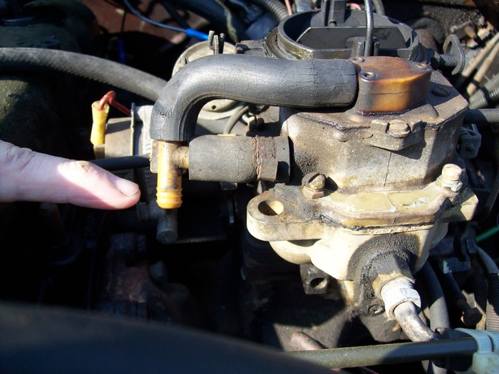

GREEN LINE ON CANISTER (TANK VENT) IS NOW UP ON THE FIREWALL.....CANISTER AND CRAP IS ELIMINATED
THIS LINE COMES OFF OF THE TANK, THEN UP INSIDE THE DRIVERS REAR FENDER, IT GOES THRU A "LIQUID CHECK VALVE" AND THEN A "ROLL-OVER CHECK VALVE", IT THEN GOES FORWARD TO THE CANISTER.
THE TWO VALVES I JUST MENTIONED ARE DESIGNED TO KEEP RAW FUEL FROM COMING OUT OF THE TANK, BUT ALLOWING THE FUEL TANK TO "VENT". "PLUGGING" THIS VENT WOULD MAKE THE TANK DRAW A VACUUM AND FUEL COULD NOT BE S.UCKED UP TO THE CARB......REASON FOR THE "BREATHABLE" FUEL FILTER ON MY MODIFICATION.
2ND PIC
EZ, ADD TWO INCHES OF 3/8 FUEL LINE TO THIS TEE---THEN ADD A 3/8 FUEL FILTER SO IT CAN BREATHE AND KEEP TRASH AND DIRT DAUBERS OUT OF THE LINE

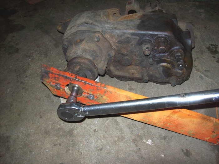

YOKE HOLDING TOOL (USED ON TRANSFER CASE YOKE IN THIS PIC)----THE BEARINGS IN THE TRANSFER CASE ARE "PRE-LOADED" USING CORRECT SHIMS......THIS YOKE GETS 150 FT LBS TO SEAT THE NUT
THE PINION IN THE REAR, USES A "CRUSH SLEEVE" OR "COLLAPSIBLE SPACER".....SUPPOSED TO BE REPLACED ANY TIME THE NUT IS LOOSENED....THIS IS A DELICATE THING TO DO, AND MUST BE CORRECT, OTHERWISE THE REAR WILL NOT LAST

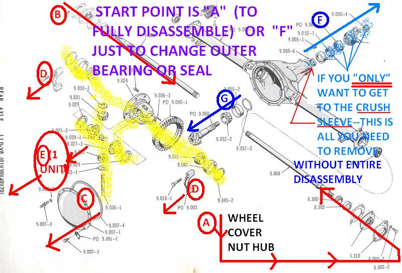

I'm going to attempt to do a full rear differential overhaul. My guess is that the bearings and gear teeth are most likely shot. This is WAY outside of my realm of experience, which is good. Nothing like a solid dose of learning. However I'm not going to start until I have a very good feel for what needs to happen.
In the knowledge base manual, there is a list of pretty specific tools needed for this such as: gauge arbor, guage block, holding screw, discs, pinion oil seal installer. Looks like most of those tools are used for setting the pinion depth. Do they sell these at a standard auto parts store? Looks like I'll also need an arbor press to remove/install the bearings to the differential case. I can probably get access to one at the university or the machine shop down the road.
I've never tried a repair that required precise shimming. Do you buy sets of shims in order to get the right spacing? Or do you just machine down shims that you already have? Like the depth shim for the pinion, for example.
I hope I don't have to replace the ring or pinion. Those suckers are pretty expensive - $200-ish. One day I would like to upgrade to pneumatic lockers, but those puppies are $1000 a pop! Ouch! Maybe one day. I'm thinking all I'll have to replace are the bearings. Hopefully.
Do you have any albums or links detailing a diff overhaul? Been watching youtube videos about rear diff overhauls. This is going to be a tough one...

AS FAR AS REAR END GOES THINK ABOUT A STANDARD DIFF VS. A "TRAC-LOC" (POSI-TRACTION ON THE REAR--FRONT IS OPTIONAL LATER ON)
SO WE'RE LOOKIN' AT RING AND PINION--ITS BEARINGS AND CRUSH SLEEVE..........SIDE BEARINGS.....CARRIER OR NOT????.....DIFF JUICE DEPENDING ON WHAT SYSTEM YOU USE.......AND OF COURSE "SHIMS"
I'D SAY YOUR BEST SOURCE FOR A VARIETY OF SIZES AND THICKNESSES WILL BE AT ONE OF THOSE "COUNTRY TRANSMISSION SHOPS"....YOU KNOW THE KIND YOU WALK INTO AND IT LOOKS LIKE "HOARDER-VILLE"......THESE GUYS HAVE BEEN HOARDING THIS STUFF FOR 60 YEARS, KNOW RIGHT WHERE IT'S AT, AND DEPENDING ON YOUR 1ST IMPRESSION, YOU CAN GET IT CHEAP OR EVEN FREE!
THIS TECHNIQUE MAY WORK IN HOARDER-VILLE TOO. YOU SOUND LIKE YOU'RE WELL VERSED IN ANY SITUATION
http://www.2carpros.com/questions/1989-mercury-tracer-was-backed-into-need-headlight
SHAKING?
COMPLETELY REMOVE REAR DRIVE SHAFT----STICK 'EM IN 4X4---FRONT WHEELS ARE THE ONLY THING PULLING.....DOES IT GO AWAY???
LET'S NOT EVEN ATTEMPT TO MAKE SHIMS---SEARCH NET IF NOTHING ELSE---DO IT RIGHT!----FULLY UNDERSTAND "PRE-LOAD"---WE'LL PHONE COMMO IF YOU WANT MORE OF MY RURAL ROUTE EXPLANATIONS!
MY AMC JEEP MANUAL SHOWS THE RING AND PINION MARKED WITH "+" AND "-" AND A NUMBER, SUCH AS "+ 3" ON THE RING-----THE NEW RING MAY SAY "+ 1".......A CHART SHOWS THE "TENTATIVE" .002" (2 THOUSANDTHS OF AN INCH. YOU WOULD EITHER "ADD" A .002" SHIM OR "SUBTRACT" .002"
WHAT THIS SORTA MEANS IS THE "SPOT" THAT THE PINION MESHES "BEST"/ "QUIETEST" WITH THE RING. THE NUMBERS ARE THERE SO THAT YOU CAN EZily SHIM IT RIGHT OR CLOSE.......THEY DO STILL WANT YOU TO VERIFY THIS WITH THE DEPTH TOOLS, IN A PINCH, I'D TRUST THE CHART MORE THAN "JIMBOB, THE IMPACT WRENCH GUY"!

This is what my ideal rear end looks like: one piece axel shafts, pneumatic locking differential, and disc brakes. Now I know I can't afford this all at once. I just want my baby to run well (just took her on a moonlight ride. What a blast! I love driving this thing when the engine is running well!). So I'll settle for one piece axel shafts and a good differential gear for now. I can upgrade the diff to lockers and the brakes to discs later. Ideally I'd want a "little" suspension lift - maybe 5 inches or so, at some point.
So this is what I think I'll do now. Go ahead and replace the two piece axels with one piece at the price you found it. $300. I'll probably have to replace the ring and pinion as well as the bearings (if the bearings are bad, the gears are probably bad too). That's another $300. I don't have the tools to do this repair yet. I'll need a big ol' breaker bar, a big ol' torque wrench, probably a huge pipe wrench to get it up to 250 ft-lbs, and a really tiny torque wrench, and all the fancy gauges and arbors and shims to make everything line up. Another $200 or so. That's around $1000 for a full rear end job. Can't afford that now, but I'll start saving. I'm actually excited about spending this kind of money which might be a problem for my future finances...
As far as the leaking fluid is concerned, the transfer case bottom cover does need a gasket so I'll go ahead and order that. The fill plug for the rear diff is a (you guessed it!) torque bolt. I was going to refill the fluids this afternoon but I don't have a torque socket large enough to pull the thing out (torque bolt is the six sided star looking thing, right?). I'll change out the transfer case gasket, refill with fluid, and pull off the rear drive shaft and try it in two wheel to see if the vibration in the shifter goes away. Actually the vibration only happens around 25% of the time. Most of the time it's just the really loud WINE coming from the rear end. Really think the diff is the problem. Those Dana 300's are supposed to be bomb proof.
As soon as I have enough money to afford all the rear parts, I'll go ahead and pull the rear end off and start the repair of the century. It's gonna be fun! Time to make my baby run like she did in '85. Or better!
Side note, named my CJ Athena - the goddess of wisdom (ironic right? buying a money pit usually isn't a "wise" call. But I love her). I name all my cars after Greek goddesses. My old '96 4WD Ford Explorer was named Helen of Troy - the face that launched 1000 ships (she was an ugly wreck but loved her too). And my 2010 VW GTI is Artemis the Huntress. She's a silver ball of 4 cylinder turbo furry. The perfect car for "hunting" in the night. She'll throw your head into the back of your seat! But all my attention is on "Athena" for the moment. She's my patron goddess anyway, since I'm a lowly engineering graduate student. I took a lot of Latin classes in high school. Guess it payed off...
I'll generate a list of parts and tools that I'm gonna need for this rear end job tomorrow and post it. Piece by piece I'll start buying everything and reading up on it until I'm ready to make the repair. Thanks again for all your help. I'll give a call when I'm about ready to start the repair.

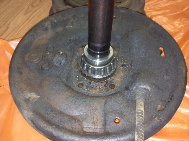

THOSE CRAPPY DESIGNED AMC AXLE/ HUBS REALLY MESS YOU UP----IT WASN'T ALWAYS LIKE THAT. FROM '41-JUST BEFORE OURS, THE HUBS ARE ON TAPERED AXLES USING A REALLY BIG KEY/ KEY-WAY. THESE WERE BASICALLY RE-USABLE FOREVER.

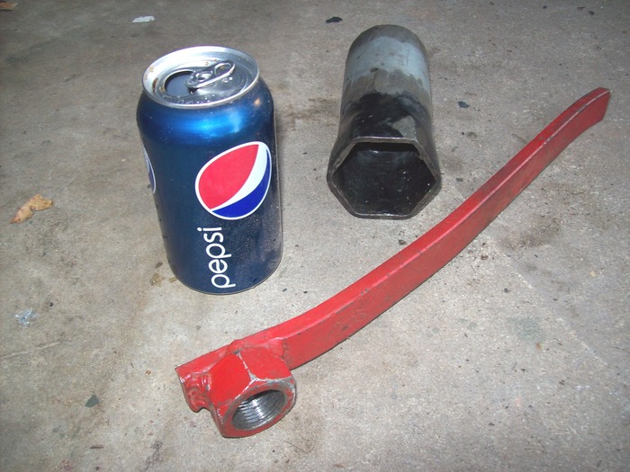

IN MY PIC BELOW YOU WILL SEE THE BIG SOCKET USED TO REMOVE THE WHEEL BEARINGS....I CHOPPED MINE IN HALF AND WELDED AN EXTENSION IN THE MIDDLE, FOR USE IN OTHER APPLICATIONS TOO.
THE OTHER TOOL IS SORTA A WWII IDEA (WHICH I COPIED). THIS IS FOR REMOVING THE REAR HUBS (BRAKE DRUMS ARE PRESSED ONTO THEM, SO TO GET TO THE BRAKES, HUB AND DRUM ARE SORTA ONE UNIT, HAVE TO BE REMOVED TOGETHER)
SO WHAT YOU DO ON WILLY IS LEAVE THE WHEEL ON THE GROUND.
REMOVE THE DUST CAP (LIKE ON MR. JEEP).
REMOVE THE COTTER-PIN AND BIG CASTLE NUT......THIS ONLY WORKS ON "WILLY"!......OUR LATER MODELS REQUIRES A HUB PULLER, I EVEN BROKE ONE ONCE TRYING TO PULL A HUB
SCREW THE WW II TOOL ON WHERE THE CASTLE NUT WAS AT. SCREW ON IT TILL THE END OF THE AXLE BOTTOMS OUT ON THE FLAT BAR OF THE TOOL
THIS LEAVES A SMALL GAP BETWEEN THE WW II NUT AND THE HUB
WITH A GOOD HARD "WHAP" WITH A SLEDGE HAMMER, OVER THE CENTER OF THE "WW II TOOL'S NUT", YOU DRIVE THE TAPERED FIT AND KEY LOOSE OUT OF THE HUB.
BACK OFF THE WWII TOOL SLIGHTLY---LOOSEN THE LUG NUTS---JACK WILLY UP----AND WAH-LAH!!!....THE HUB AND BRAKE DRUM ARE OFF
SO SIMPLE, YET STILL STRONG......ENGINEER FELLER.....WHY DO YA'LL MAKE THINGS HARDER AS THE YEARS PROGRESS???

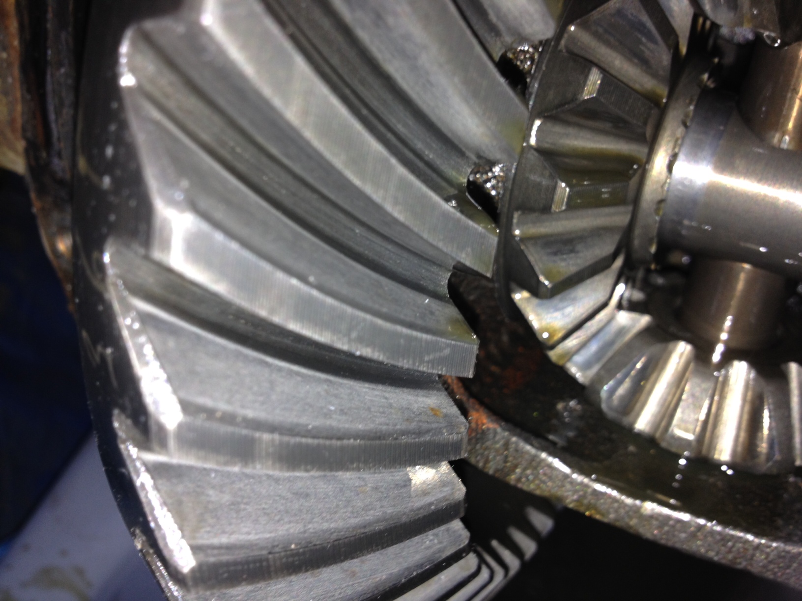

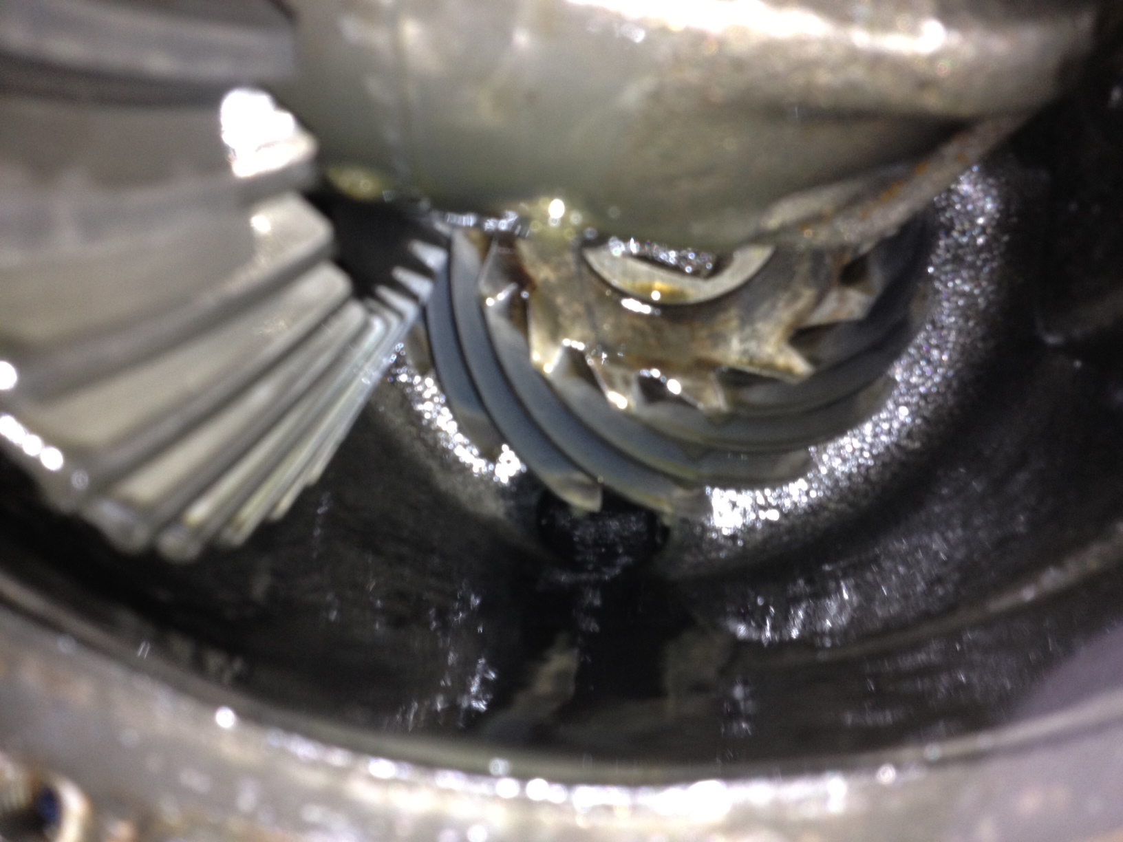

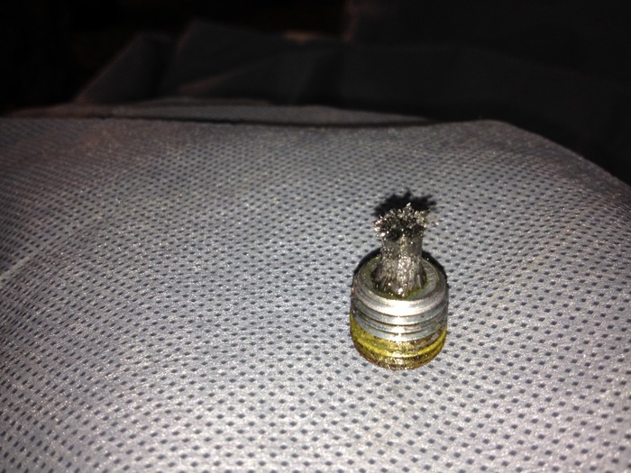

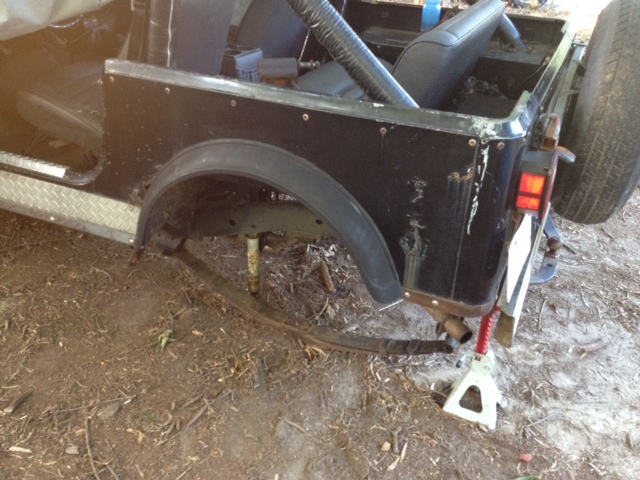

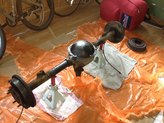

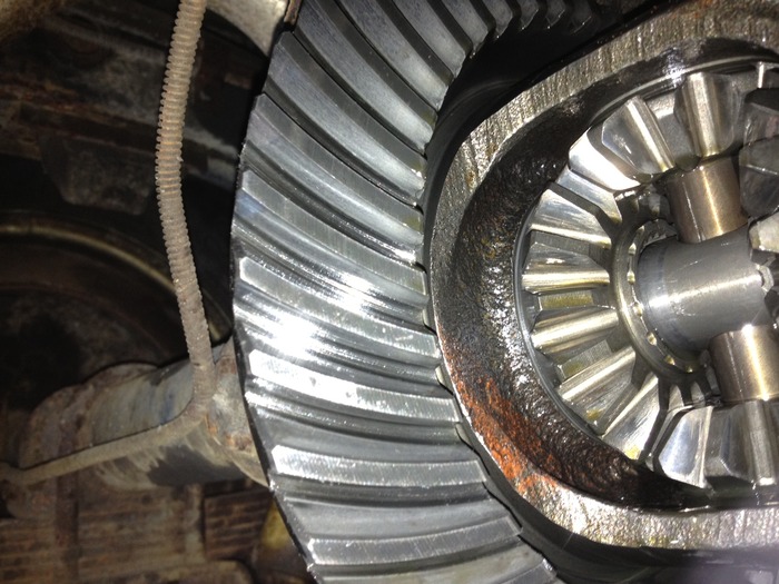

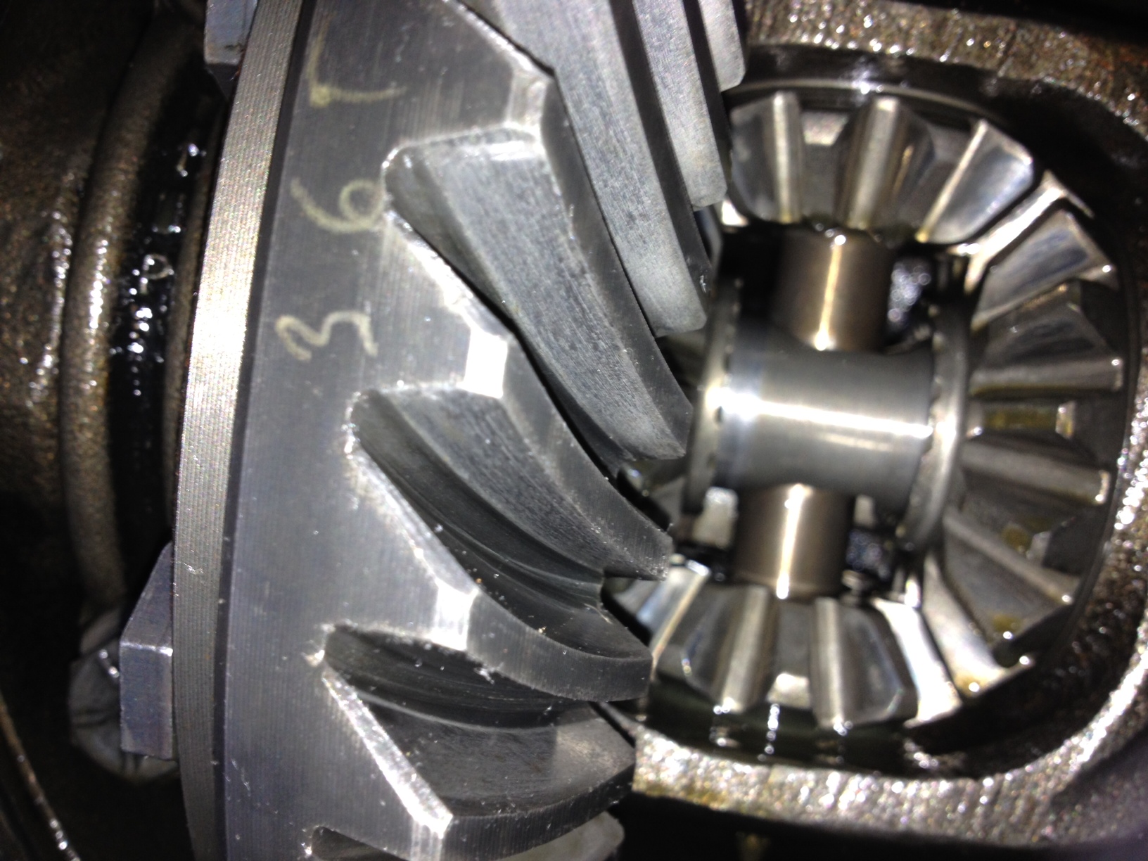

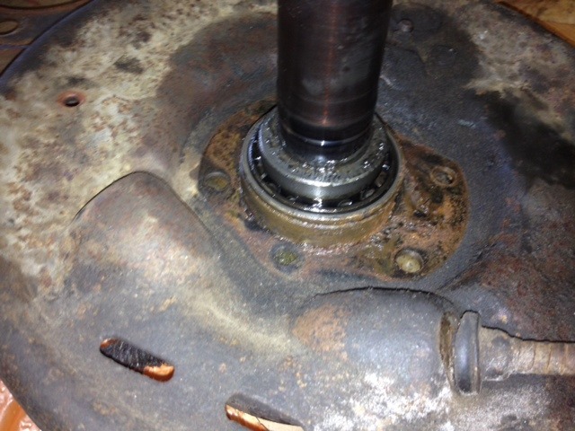

Here's an update. I pulled the rear diff cover off and took a look around. From what I could tell, the gears look great. See pics below. Granted, I didn't lift the back end so I couldn't take a look at all the gear teeth, but it looks better than I thought it would. The gear oil was disgusting but there was plenty of it so no leaks.
Couple of questions. From the knowledge base, it looks like I have to remove the carrier and axel shafts before I can preload the pinion gear and crush the sleeve. Do I have to yank everything out to do that? I feel like the in-lb torque would change depending on if the carrier were in or not.
I removed the transfer case plug and drained the lube in there too. The oil was clean and looked like it had been replaced recently. There were shavings attached to the magnetic end of the plug. Not a lot, but the pic is there.

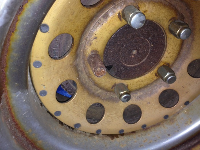

Any good ideas on how to remove the super-rusted key lug nuts in the last picture?

SORTA REVERSE ORDER
THE PARTS STORE USETA HAVE THESE AS RENTALS OR FOR USE IN THE PARKING LOT
Lug-Nut-Remover-Wheel-Lock-Removal-Kit-3pc-CTA
IT'S SORTA A OUTSIDE "EZ-OUT"---LOOKS LIKE YOU CAN GET IT AND SHIPPED FOR ABOUT $30.....RENT IT OUT YOURSELF, TO RECOUP YOUR MONEY!
......OR SELL IT TO THE PARTS STORE, SO THEY WILL HAVE A SET!
---WHEN THEY ARE OFF, SLING 'EM INTO THE WOODS AND NEVER PUT ANY BACK ON!
MAGNET IS DOING IT'S JOB---NORMAL SHAVINGS ON IT---I'D SAY YOU ARE GOOD!

WHY GUESS? PROPER "SPIN-AGE IN.LB. TORQUE" ("X") IS IN MY FACTORY MANUAL---I'LL LOOK IT UP WHEN I GET OFF WORK TODAY
ALL YOU'LL NEED TO GET IS WHAT "Y" 'SPIN-AGE' IS NOW, WITHOUT D-SHAFT/WHEELS/BRAKE DRUMS
I HOPE YOU ARE UNDERSTANDING ALL OF MY SLANG!
I'LL POST THIS AFTERNOON
THE MEDIC
Jul 4, 2012 at 10:48 AM
CJ MEDEVAC
  • 11,004 POSTS
ALL-RIGHTY THEN
"X" IS 17 TO 25 "INCH-POUNDS" (WITHOUT ADDING IN THE OTHER STUFF)
THAT IS, WITH AN IN.LBS. TORQUE WRENCH (NEEDLE TYPE) TURNING THE NUT/YOKE
THE NEEDLE READING IS TAKEN WHILE THE NUT/PINION IS MOVING---NOT FROM A STANDSTILL START
WHEN YOU TIGHTEN THE NUT TO CRUSH THE COLLAPSIBLE SPACER TO CREATE "PRE-LOAD"---DO IT A TEENY BIT AT A TIME!
YOU MAY WANT TO GET AN EXTRA CRUSH SLEEVE...JUST IN CASE! IF YOU OVER TIGHTEN, BACKING OFF IS NOT AN OPTION, GOTTA INSTALL A NEW SLEEVE AND START OVER
CALL YOUR LOCAL PARTS STORES, YOU MAY BE ABLE TO RENT SOME OF YOUR TOOLS
THE MEDIC
Jul 5, 2012 at 12:57 AM
CJ MEDEVAC
  • 11,004 POSTS
IF YOUR YOKE HOLDER IS CLOSE TO A 1/4 INCH THICK, IT MAY BE STRONG ENOUGH......MINE IS A 1/2 INCH THICK
YOU REALLY GOTTA PULL HARD WITH A LONG BREAKER BAR TO CRUSH THE SLEEVE.....THIS ALSO MEANS THE TOOL ON THE YOKE TOOL WILL HAVE TO BE A LONG LEVER (MOST LIKELY A HEAVY DUTY 1/2 DRIVE BREAKER BAR, OR A 3/4
WHEN I REPLACED MY INNARDS, THE AXLE WAS ON THE JEEP, JEEP WAS ON JACK STANDS---I STACKED CONCRETE BLOCKS UNDER MY YOKE HOLDER SO IT WAS IMPOSSIBLE THAT IT COULD MOVE, WHILE I GOT DOWN ON THE BREAKER BAR. THE STANDS PROVIDED ME ROOM TO PULL FROM UP HIGH UNDER THE JEEP AND NOT BE IN A STRAIN IF I WERE CLOSER TO THE GROUND

Axle is off. Torqued the head off of one of the eye-let bolts for the leaf springs, probably bent the heck out of another one trying to hammer it out. Is there an easy way to remove leaf springs? I did want to redo the suspension at some point, but I don't think I can afford it just yet. Also I don't want to pull the front axle off at the moment. Going to pull out the axle shafts and take a look into the diff and bearings soon. Now that it's indoors, the sky's the limit. Sure wish I had a garage.

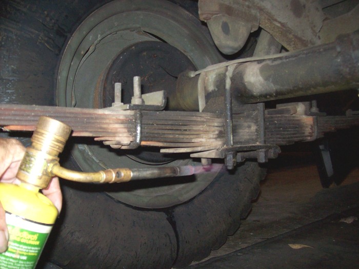

A REGULAR OLE PROPANE TORCH IS BETTER THAN NOTHING--IT HEATS SLOW BUT MAY ALSO HEAT THE INNER PART (BOLT) WHICH NEEDS TO REMAIN AS COOL AS POSSIBLE
A OXYGEN/ ACETYLENE RIG IS BEST, AS IT WILL HEAT STUFF UP REAL FAST AND EXPAND THE NUT ETC---LEAVING THE (BOLT OR WHATEVER) COOL AND UN-EXPANDED)
I'M A PLUMBER.....WHAT YOU SEE IN THE PIC IS A "TURBO TORCH" IT CAN USE PROPANE OR MAPP GAS.....THIS TORCH HEAD BOUGHT LOCALLY IS ABOUT $40.....I HAVE 4 OF 'EM FOR WORK....YOU MIGHT GET ONE ON LINE CHEAPER
MAPP IS IN THE YELLOW BOTTLE---IT HEATS UP REALLY FAST W/ IT THROTTLE UP HIGH---IT'S SORTA RATE IN THE MIDDLE BETWEEN USING "PROPANE" OR "ACETYLENE"
I USE IT A LOT FOR SOLDERING OR AROUND THE HOUSE (LIKE FOR WHAT YOU ARE DOING)
MAPP W/ THE TURBO TORCH WILL HEAT A 3/4" NUT "RED" IN LESS THAN 30 SECONDS-----LOTS OF THE TIME YOU NEED ONLY HEAT UP MAYBE A 1/4 TO 1/2 OF THE NUT---WE ONLY NEED IT TO EXPAND A LITTLE TO MAKE IT MOVE
IF YOU DO THIS IN/ON OTHER STUFF, WATCH OUT FOR RUBBER AND "SEALS".....WE DON'T WANNA MESS SOMETHING ELSE UP!!!
I RUN TO MY BUDDY'S SHOP IF I NEED THE ACETYLENE RIG
IF POSSIBLE USE A GOOD PENETRATING OIL A FEW TIMES SEVERAL DAYS BEFORE YOU NEED TO REMOVE STUFF
IF YOU HAVE A CORRECT "DIE", YOU CAN RUN IT UP THE THREADS AS FAR AS YOU CAN TO REMOVE BURRS OR RUST....WHERE THE NUT WILL EVENTUALLY TRAVEL, THIS IS EXTRA WORK, BUT THINGS WILL MOVE SMOOTHER

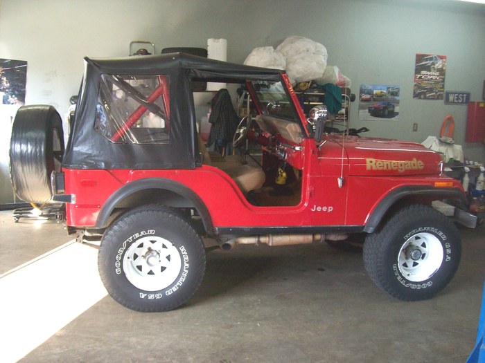

WHAT'S WRONG WITH THE FRONT?
IF IT'S JUST A SEAL---IT DOES NOT PRE-LOAD WITH A COLLAPSIBLE SPACER IT USES PRE-LOAD SHIMS....EZ FIX, SURELY THE AXLE HAS NOT GOT THE "ENGAGED" MILES ON IT AS THE REAR DOES....SEE "THE KNOWLEDGE BASE"
MY SPRINGS SAGGED BIG-TIME WHEN I 1ST GOT HIM
THE REAR WAS WORSE--I RECKON FROM SOMEONE GETTING ON THE CLUTCH HARD AND "TORQUING/ TWISTING" THEM
REMINDED ME OF A "SQUATTING DOG", AS I I APPROACHED IT FROM AFAR!
I WENT WITH A ONE INCH SPRING LIFT ON BOTH ENDS (OTHER INCHES ARE AVAILABLE). ONCE INSTALLED, IT SEEMED LIKE A 6" LIFT ON THE REAR!
A SPRING LIFT IS SO MUCH CHEAPER, DOING YOUR HOMEWORK, THEN USING "REALLY GOOD" PROMO CODES AND PURCHASING ONLINE MAY MAKE IT EVEN BETTER
WITH A PERTTY PAINT JOB AND A NICE INTERIOR, YOU'LL HAVE TO SCRAPE THE CHICs OFF LIKE BARNACLES!
IF YOU'RE GONNA KEEP HIM, REMEMBER THE STRESS AND STRAIN THAT LIFTING AND BIGGER TIRES ARE GONNA CAUSE TO YOUR STEERING STUFF AND YOUR MILEAGE!.......NOT TO MENTION HOW IT'S GONNA WANNA STRAY OUT FROM UNDER YOU.

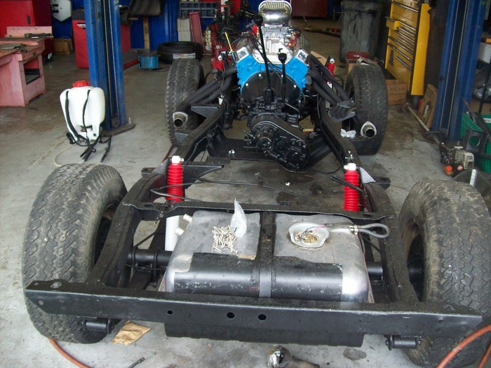

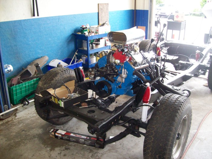

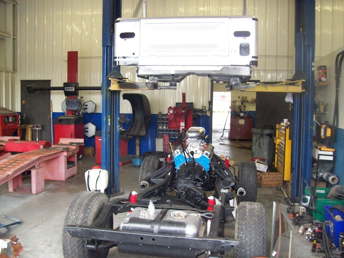

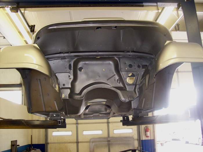

THE 1ST BELONGS TO MY BUDDY RICK
THE OTHERS ARE AT A SHOP WHERE THEY ARE RE-DOING THIS ONE 100%, GONNA SELL IT FOR AROUND $8000.
I'VE TOLD TWO OF THE FELLERS THAT THE FUEL TANK IS ON 180 OUT, I RECON THEY'LL FIGGER IT OUT WHEN THE BODY IS ON AND IT'S HARDER TO SPIN IT AROUND!

In other news, found the culprit in the differential. When I pushed the pinion yoke into the differential and went to turn it, it felt like the bearings were rolling over the Appalachian foothills. Completely ruined. Hopefully the pinion is still good. There's a good 0.01'' or so of play in the pinion laterally too (as in the pinion depth changes by 0.01'' when you push and pull on it). So most likely someone didn't set the preload right. Going to pull out the axle shafts and hopefully get a good look at the bearings tonight. I'll post pictures if I get it done.

So I got the axle shafts out last night and was pleasantly surprised to find that Johnny-preowner had already replaced them with one piece shafts. I canceled my Superior Axle and Gear order, and that's a little more money I can put towards the lift kit.
Question, it looks like the wheel bearings are facing opposite ways on the shafts. Is that right? Pic 1 is passenger side. Pic 2 is driver side (race is still in place).
I tried prying the carrier out with no luck. That thing is stuck in there good. Even got two of my roommates to help out and still nothing. I tried your rag trick too - placing the rag under the carrier and just rotating the pinion until it pops out. Still nothing. I'm going to buy an extra jack stand to set the yoke on as well as a socket for the pinion nut. I'll try the rag trick again with a big ol' breaker bar. If that doesn't work, then I'll get a bigger pry bar. I don't want to have to buy a case spreader (around $400).
