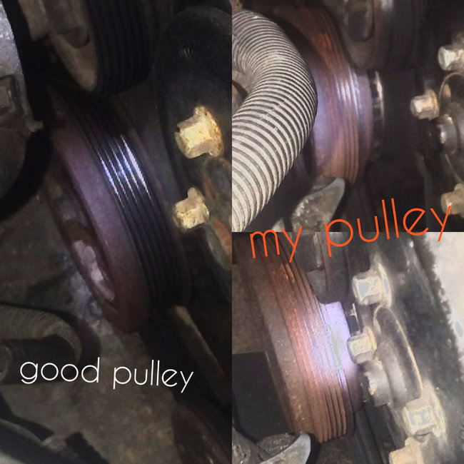

Okay, so I've been 664 miles..was doing great.
Thursday I went to start it, it started right up but it made an awful squeaking noise - I popped the hood and noticed my serpentine belt was rotating super slow. And has also been spraying pieces of it all over.
I came to the conclusion it's the crank shaft pulley.. Ive been told that those don't normally need replaced and if they do need replaced i have more problems than just the pulley and belt itself.
My question is, could the crank shaft pulley be a problem of its own?

Check the belt tensioner. It is a common failure and the belt would loose up and make noise

Did you see the picture I uploaded? The belt isn't touching the pulley itself.

Could it be the tensioner and the crankshaft? Both pulleys?
Mar 10, 2018 at 6:25 PM
Yes it could. Remove the belt and see if the pulley is damaged
