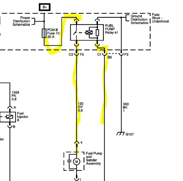

Good morning,

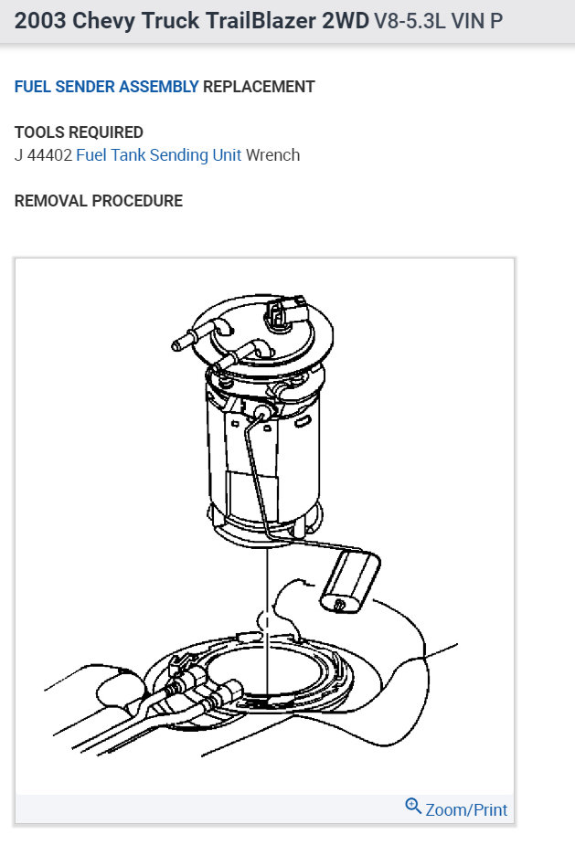

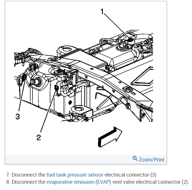

When you turn the key to the on position without cranking the engine over can you hear the fuel pump run in the tank for 5 seconds?
Can you check the fuel pressure when it will not start?
Check out the diagrams (Below). Please let us know what you find. We are interested to see what it is.

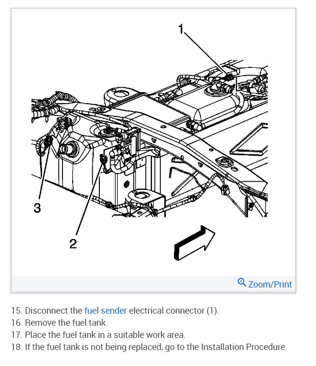

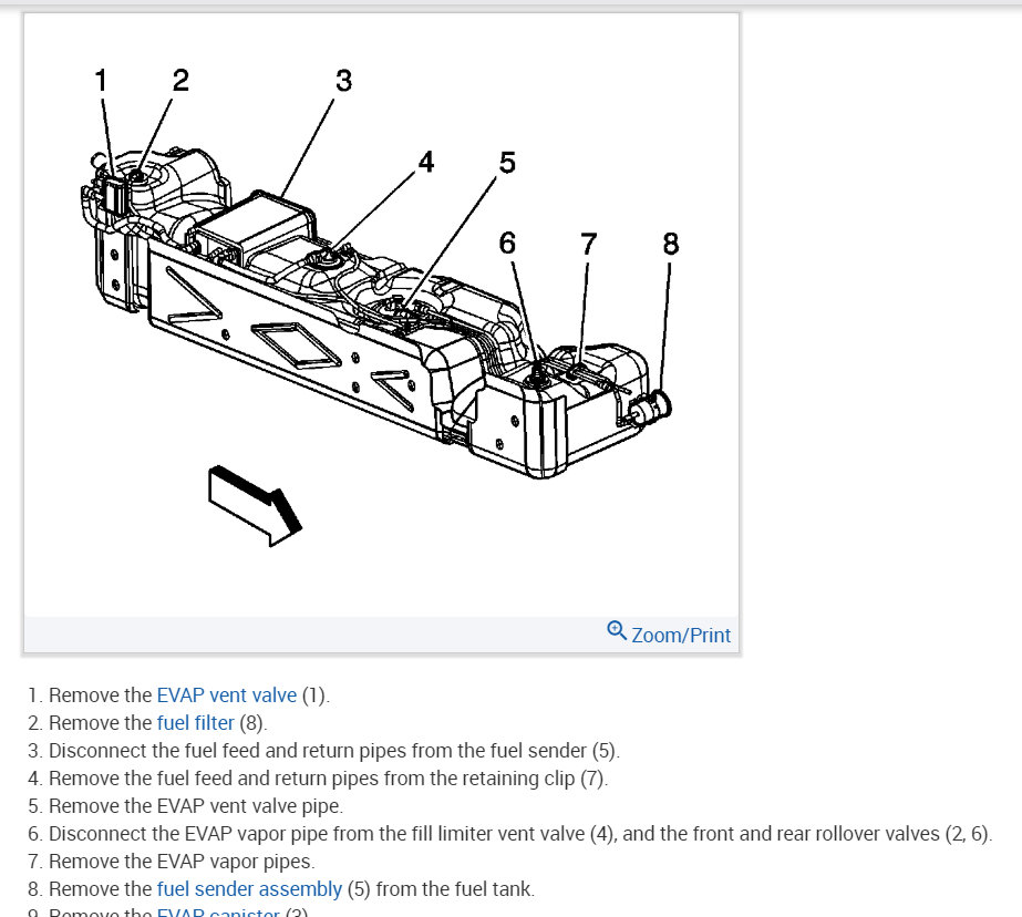

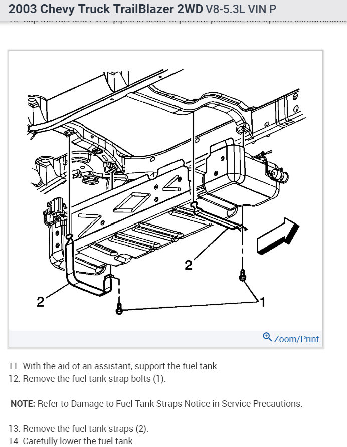

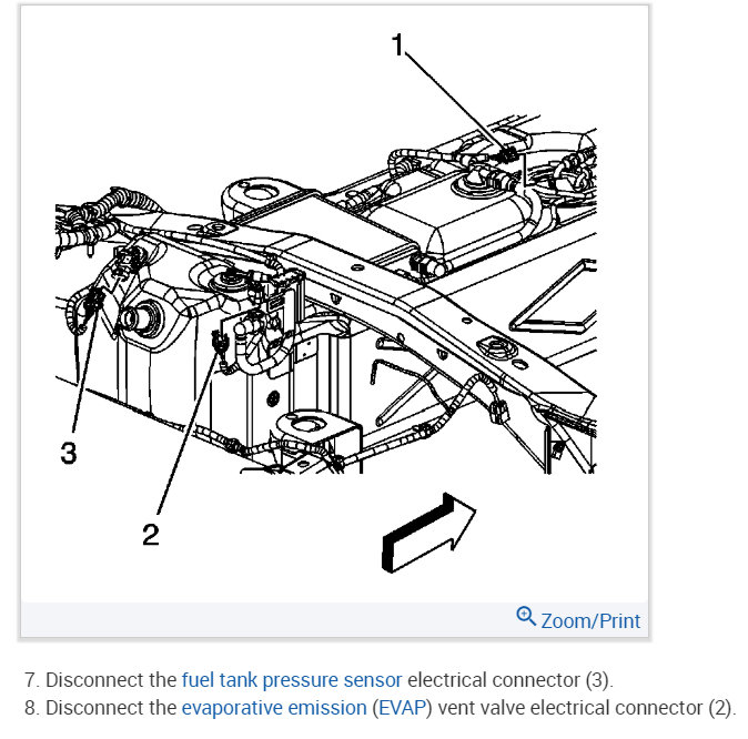

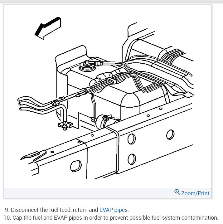

Okay, this sounds like a classic fuel pump problem, here is a guide to help walk you through the repair with diagrams below to show you how on your car.
Check out the diagrams (Below). Please let us know what happens.
Jun 2, 2019 at 11:37 AM
DAVIDBLANK
  • 8 POSTS
Sorry it took a while to get back to you but you were right the fuel pump. fixed it all good!

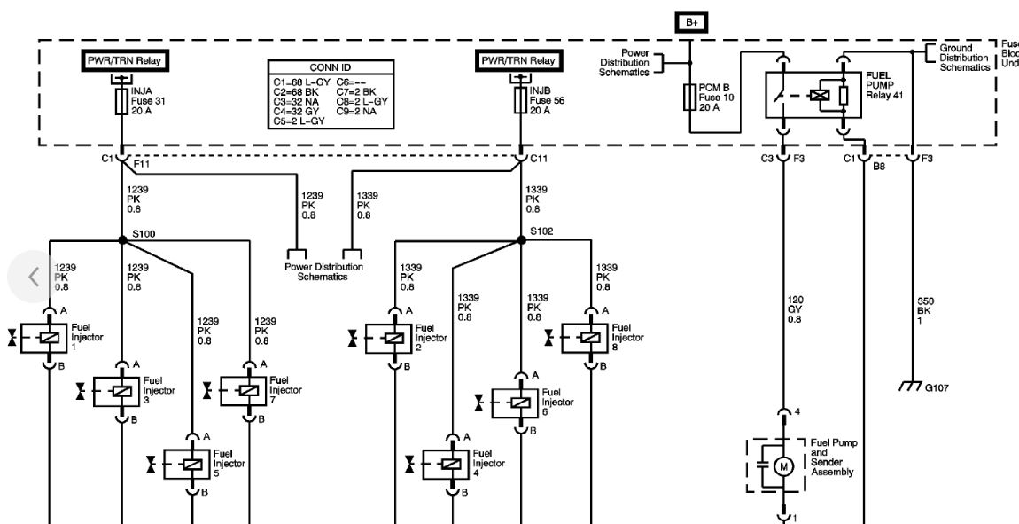

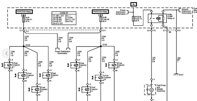

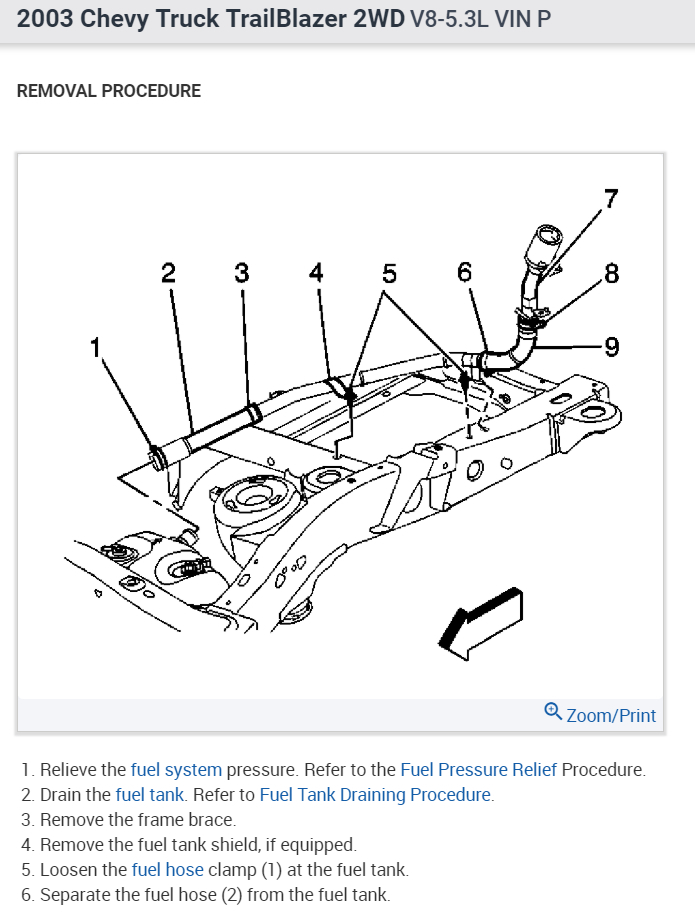

Please run down this guide and report back. it should be 50-57 psi at fuel rail and not drop more than 5 psi after ten minutes it may be a partially blocked line. if you spray choke cleaner into throttle body and it starts fine if not try resetting security system.
