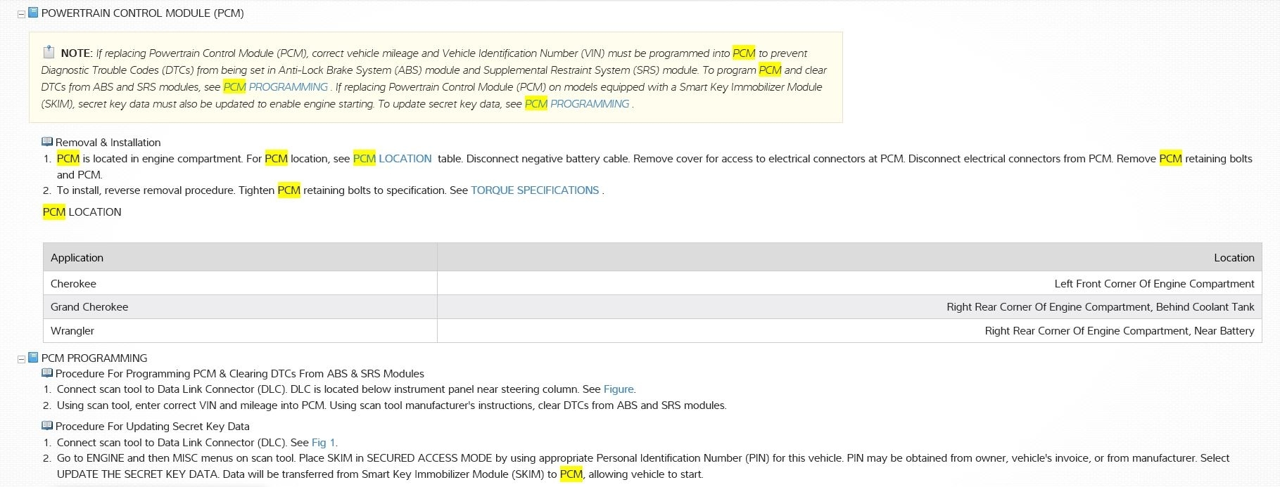

Ok. Thank you very much for your help. Any tips on removing old one?
Jan 3, 2018 at 4:45 PM
PATENTED_REPAIR_PRO
  • 1,853 POSTS
Here are the instructions for replacing that pcm.
