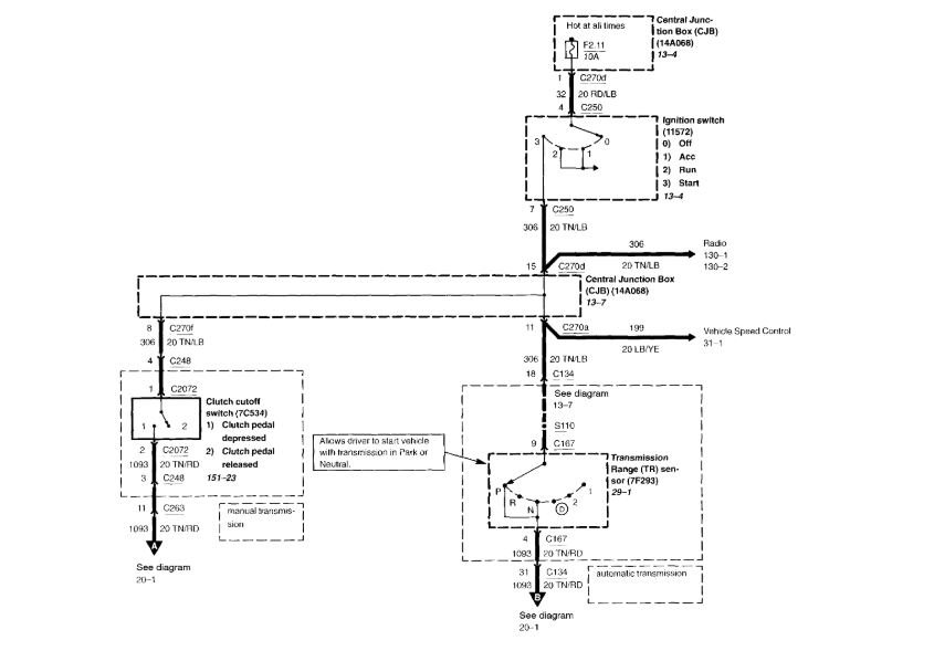

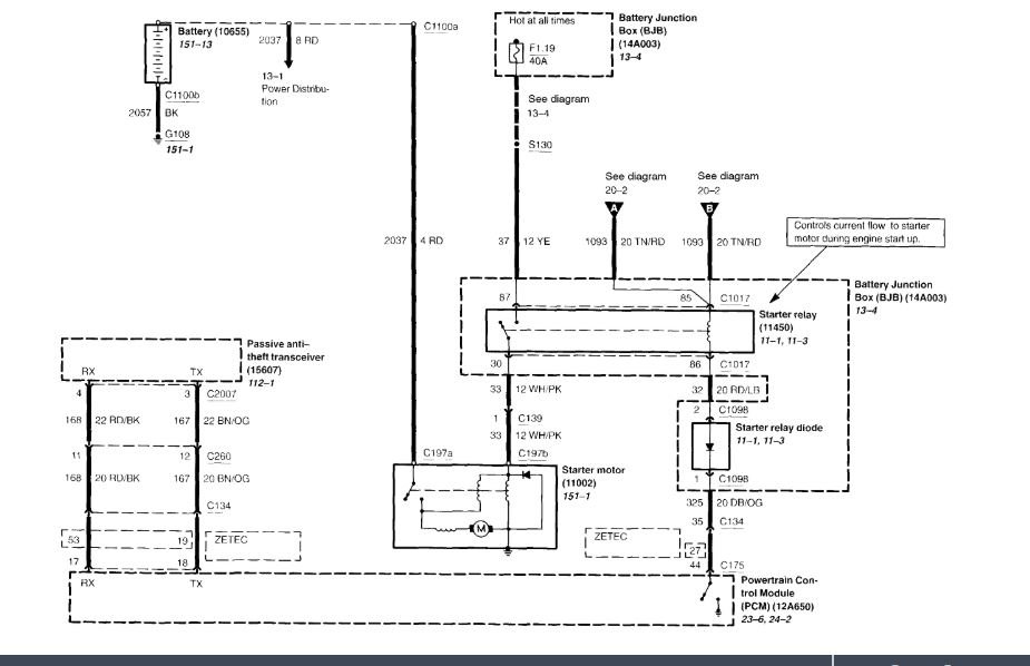

Turn the ignition key and just click won't start.
Dec 18, 2018 at 6:06 AM
Good morning,
Do you mean the starter motor just clicks or the relay is clicking?
I would start by checking the battery for proper voltage.
Did you try it in neutral?
I attached a wiring diagram for you to view. check the fuses to be sure they have power on both sides.

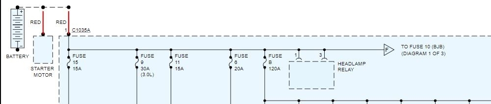

My positive battery cable broke so i went to a junkyard and cut off a positive battery cable on a 2006. Spliced both cables together with a splice connector and crimped. Did the same with the ground wire. And now when i turn key, i have nothing, not even a click or headlights, etc. What did i do wrong?
Aug 19, 2020 at 7:41 PM (Merged)
I have to be honest, I never saw a battery cable spliced. I attached a picture of how the battery positive connection supplies power to everything. Take a look and see if it what you have.
Something tells me you didn't reconnect everything. If you can, upload a picture of what you did so I can see and better help.
