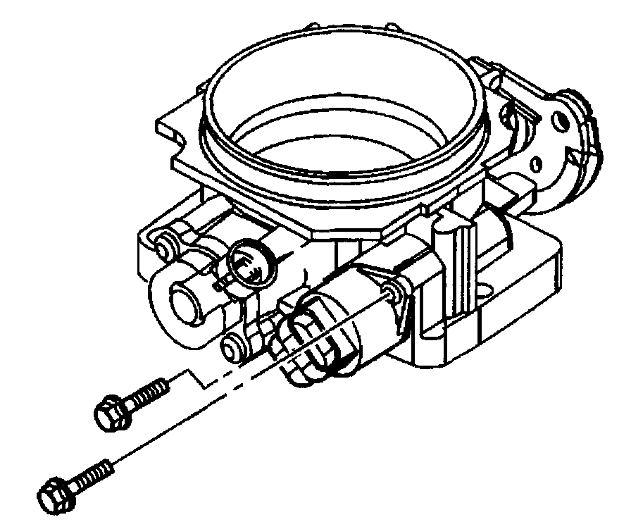

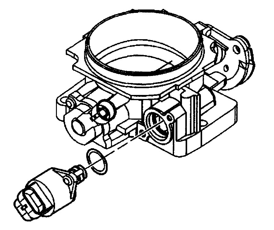

Here are directions specific to your vehicle for replacement. The attached pics correlate with the directions.
________________
2002 Chevy Truck S10/T10 Blazer 4WD V6-4.3L VIN W
Procedures
Vehicle Powertrain Management Fuel Delivery and Air Induction Idle Speed/Throttle Actuator - Electronic Service and Repair Procedures
PROCEDURES
IDLE AIR CONTROL (IAC) VALVE REPLACEMENT
REMOVAL PROCEDURE
pic 1

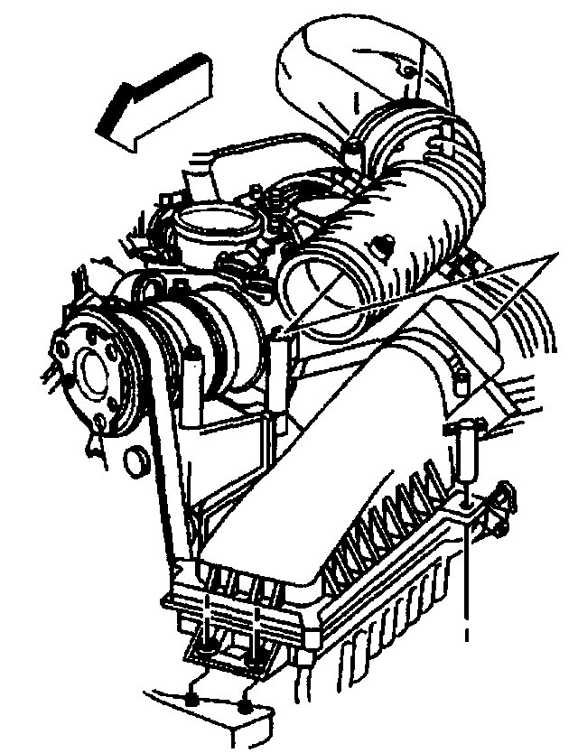

1. Turn OFF the ignition.
2. Remove the air cleaner outlet resonator.
3. Disconnect the idle air control (IAC) valve harness connector.
pic 2
4. Remove the IAC valve mounting screws.
pic 3
5. Remove the IAC valve and O-ring from the throttle body assembly.

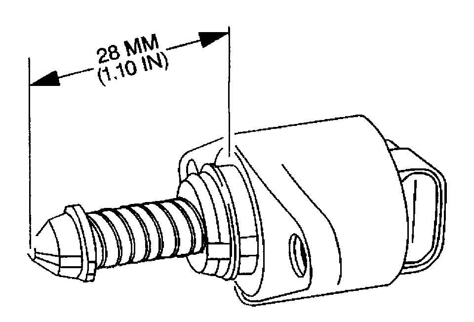

IMPORTANT: Use an identical pan when installing a new idle air control (IAC) valve. The IAC valve pintle shape and dimensions are designed for specific applications.

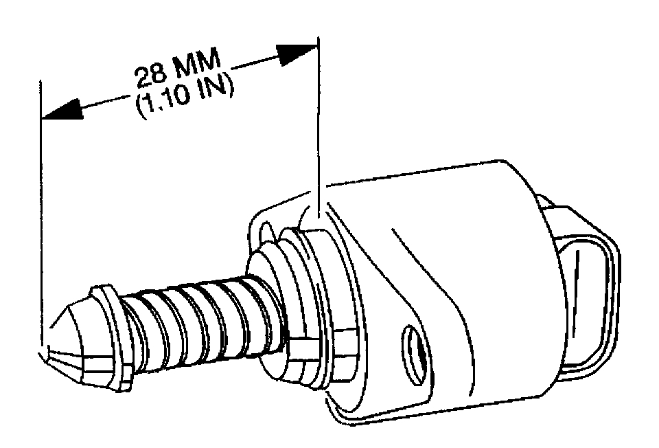

pic 4
1. On a new IAC valve, measure the distance between the IAC valve pintle and mounting flange. Use finger pressure to slowly retract the pintle if the distance is more than 28 mm (1 - 1/8 in).
pic 5

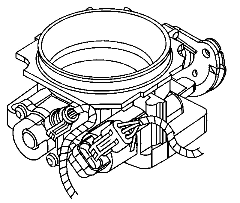

pic 7
6. Connect the IAC valve harness connector.
pic 8

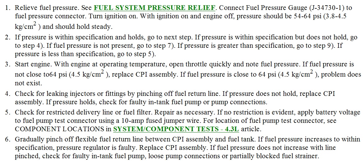

JDL
  • 16,098 POSTS
Some of my info says 54--64 psi. It also says, with engine running, quickly hit the throttle while watching the gage. Should be close to 64psi, if not, replace the spider system.

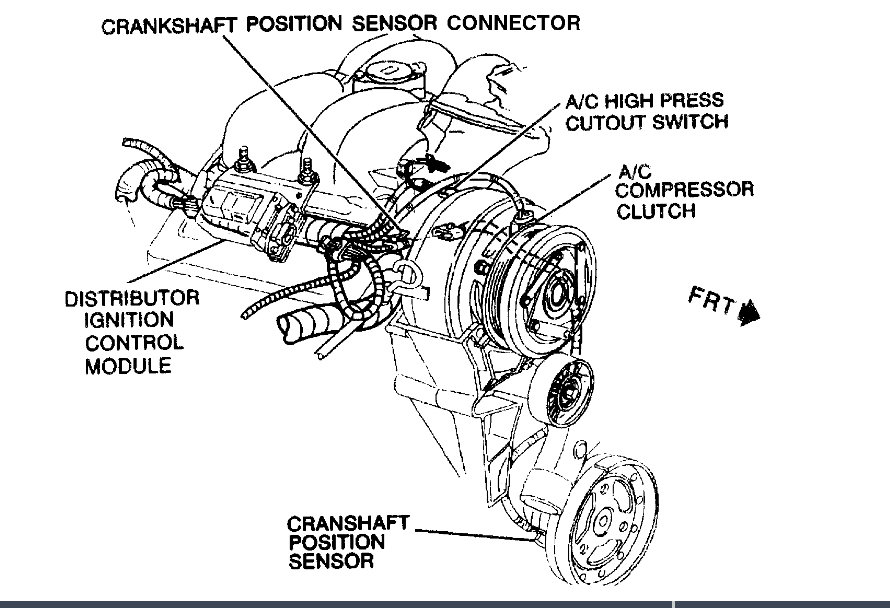

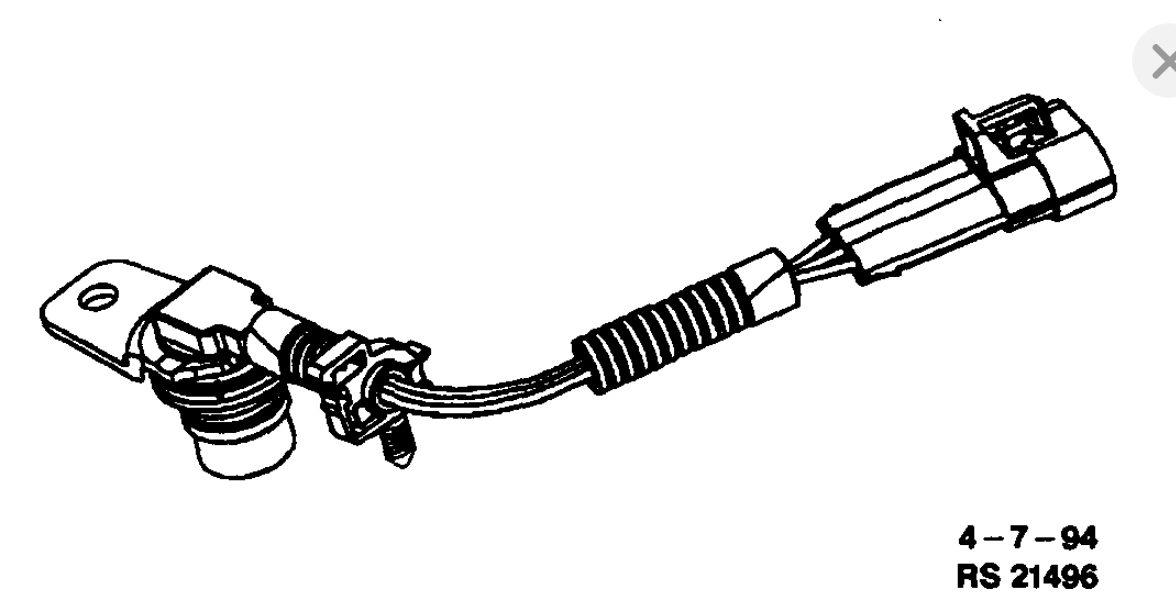

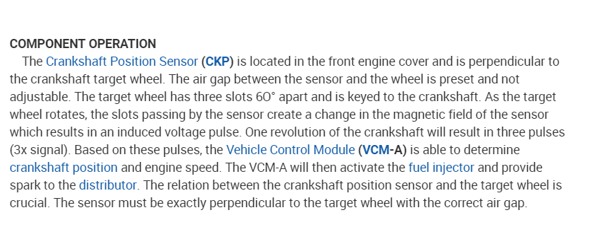

SCGRANTURISMO
  • 4,897 POSTS
This could be a problem with your vehicle's Crankshaft Position Sensor (CKP) starting to fail. The CKP sensor is used by the vehicle's Vehicle Control Module (VCM) to determine the rotational speed of the crankshaft and uses this signal to start both spark and fuel injector control. When the CKP starts to fail, it will fail when it starts to get warm. I have included a few links for you to go to below:
https://www.2carpros.com/articles/how-a-crank-shaft-angle-sensor-works
I have also included location and operation information in the diagrams down below for you as well. Please go through these guides and get back to us with what you are able to find out.
Thanks,
Alex
2CarPros
