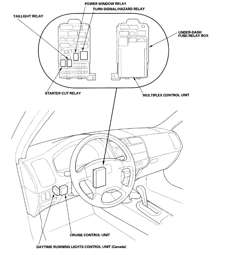

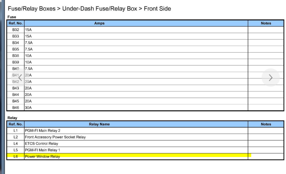

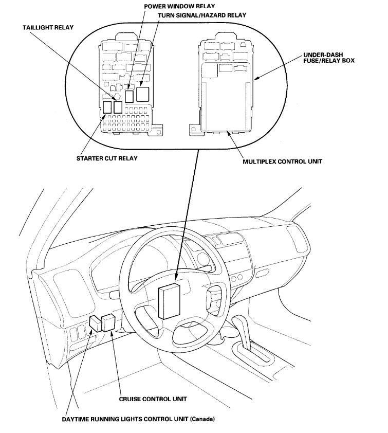

Have you checked the power window relay? It is L6 relay on the under dash relay box. Swap out this relay and let me know if they start working. Check out the diagrams (Below). Please let us know if you need anything else to get the problem fixed. Thanks
Nov 8, 2019 at 3:19 PM

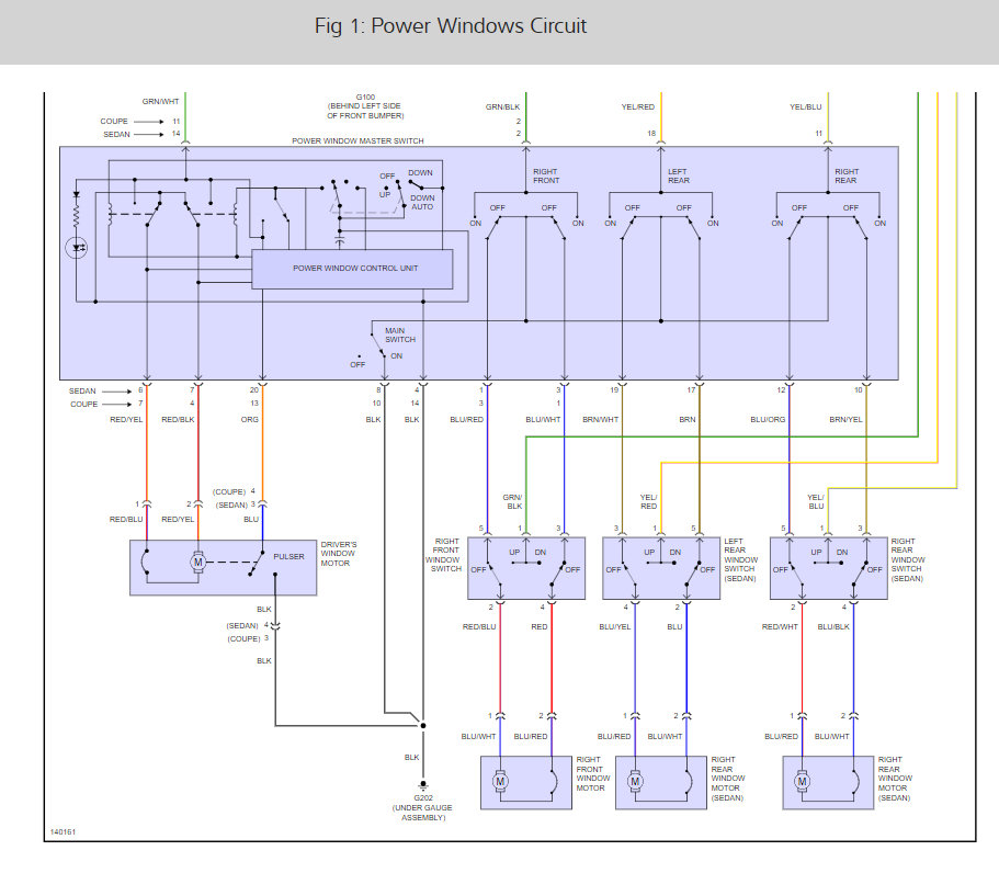

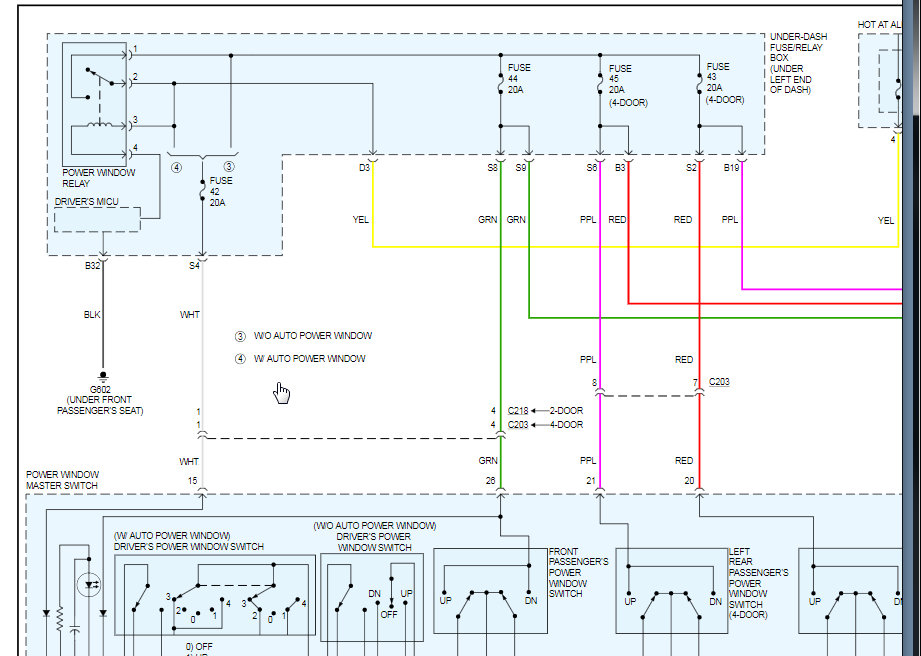

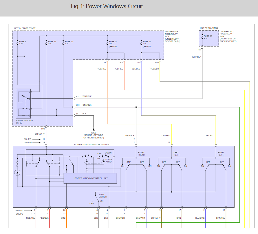

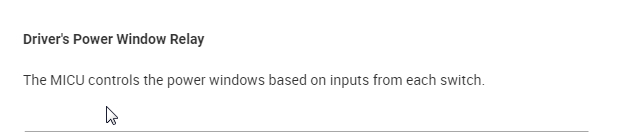

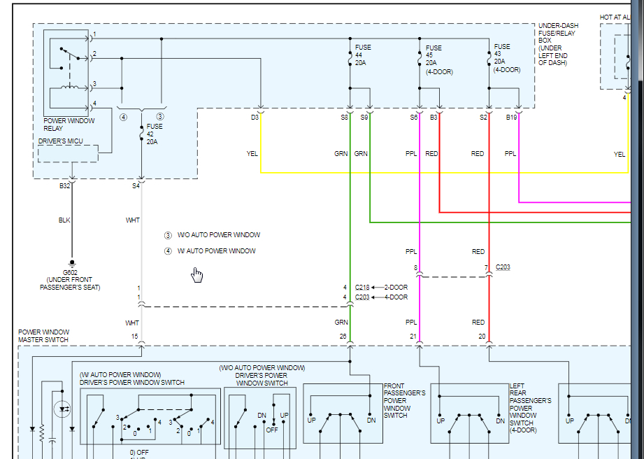

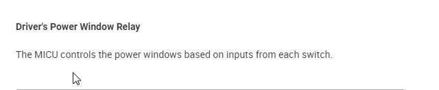

Here are the window wiring diagrams so you can see how the system works. There is a window relay that needs to be checked here is a guide and the location of the relay.
Check out the diagrams (Below). Please let us know what you find. We are interested to see what it is.
