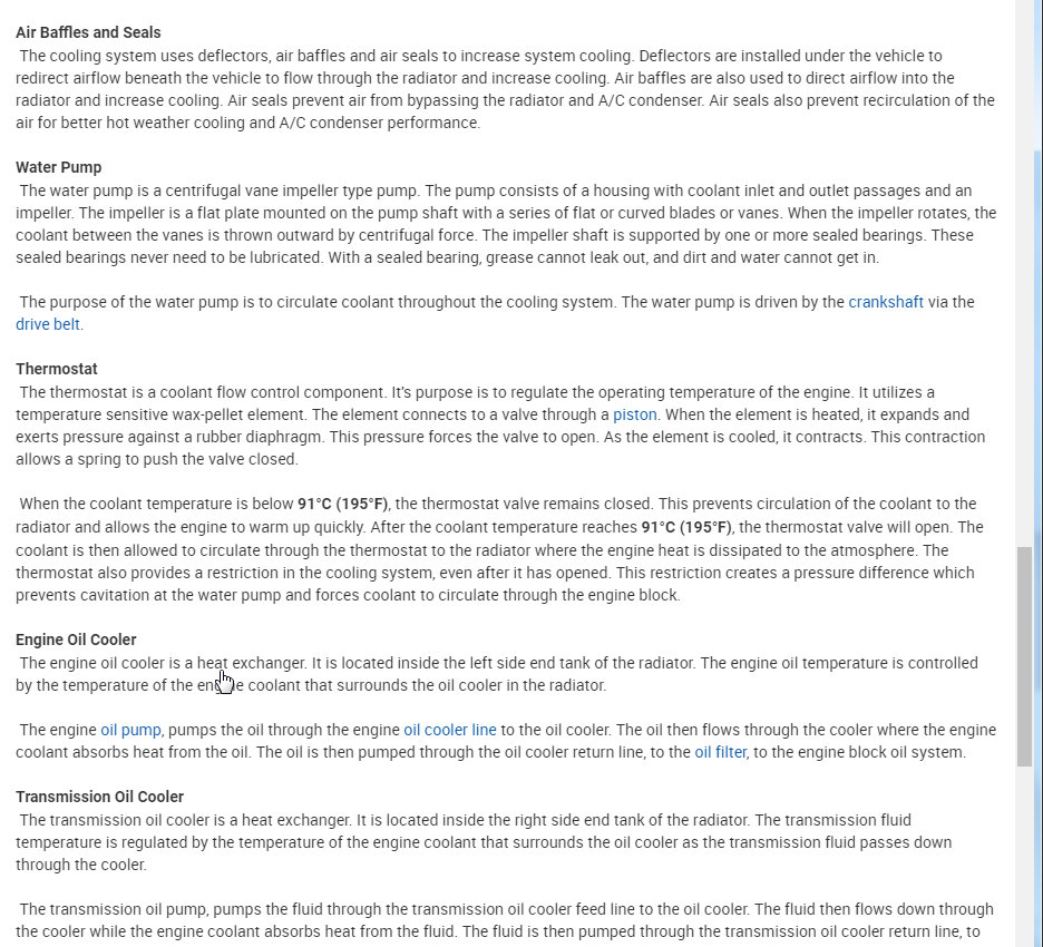

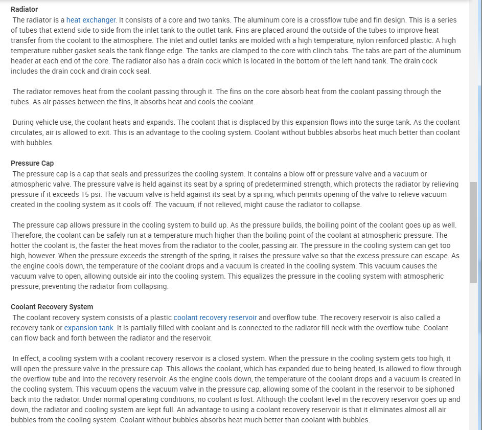

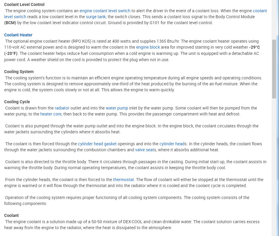

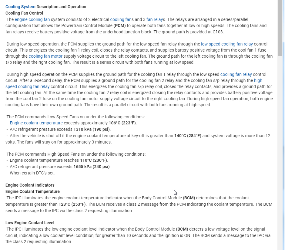

I attached the system info so you can get familiar with how it works but we need to start with filling the system and monitoring if the cooling fans behind the radiator are coming on. If they are then we need to check the upper hose to see if it is hot. If when the temp is in the middle of the gauge that the upper hose is not hot to the tough then your thermostat is not opening and needs to be replaced. It could be a failed water pump but a thermostat is much more likely. I would remove it and put in boiling water and see if it opens before the water gets to 215 degrees. If it doesn't open then that is the issue.

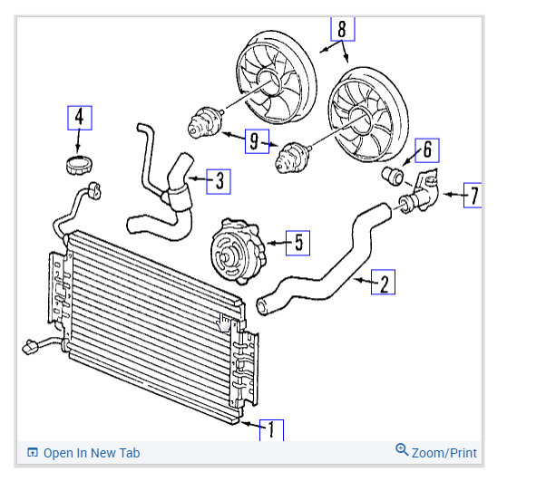

Are the cooling fans working? this guide will help us
https://www.2carpros.com/articles/engine-overheating-or-running-hot

Cooling fans are working on time-radiator not clogged-could be airlock in it-try bleeding the cooling system -don't work get it block and pressure tested
This guide can help us

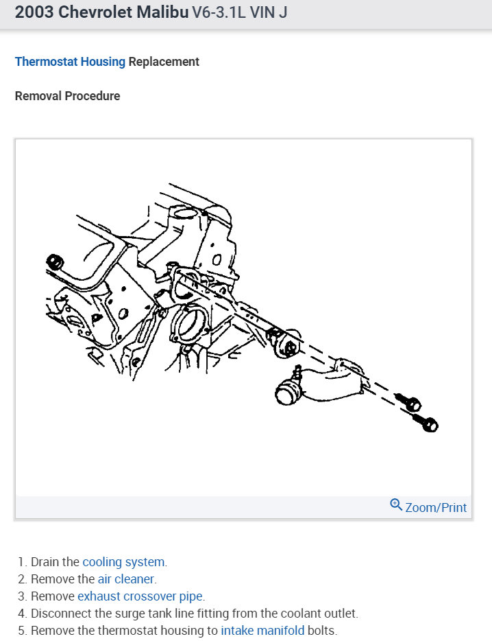

This sounds like stuck thermostat which is common. Here are two guides that will help you confirm and repair the problem which diagrams below to show you how the repair will be on your car:
and
Please run down these guides and diagrams and report back.

can the themostat be replaced without removing the intake manifold and what type of coolant do I use?
