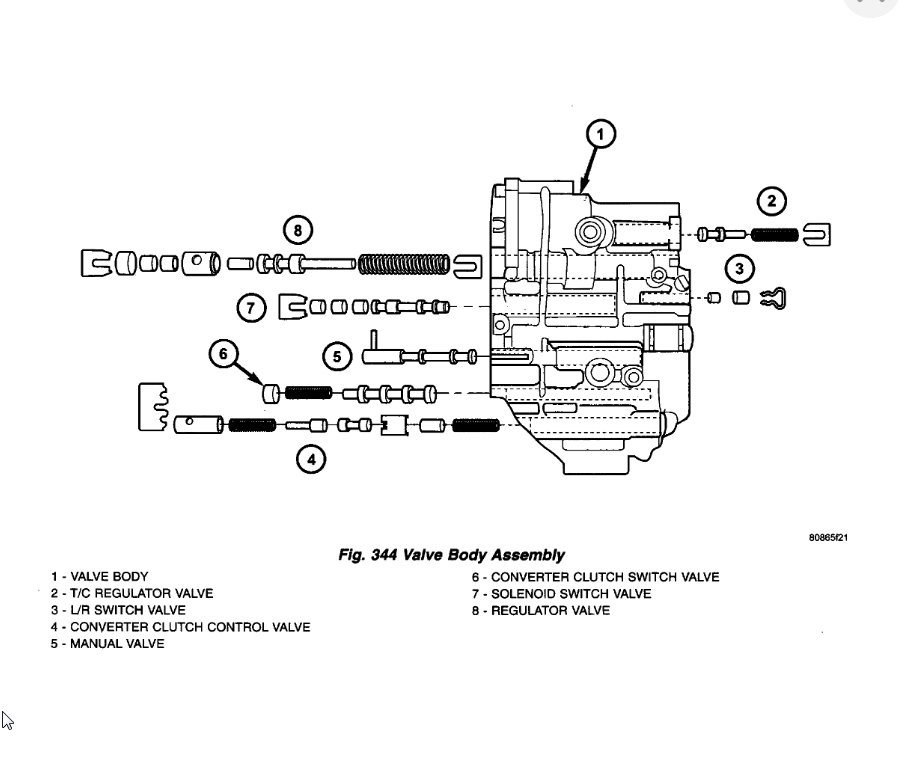

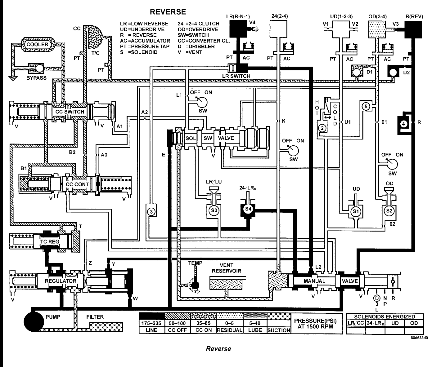

After doing some line pressure tests and code scan I have a P0882 and P0732. It failed the following test as per service manual. But being there is no reverse at all, I am not sold on a solenoid or TCM fault, because based upon pressure gauge responses when shifting. However, In limp mode as per the manual, I should have park, neutral, reverse and second gear.No reverse I am stumped.
