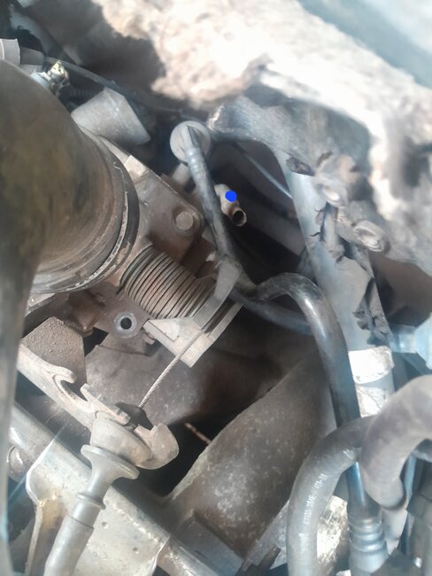

In addition, please where does the hose I identified with blue go into and the one with yellow coming from the exhaust seems to be broken off at the opposite end. Where is it supposed to continue to or join to? Thanks once again.
Nov 29, 2023 at 4:19 AM

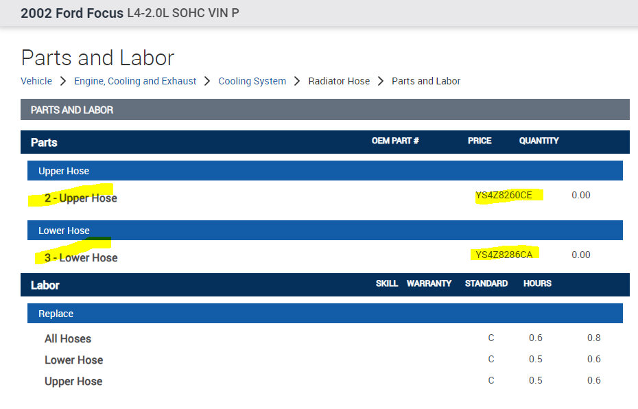

Lower radiator hose.
Nov 30, 2023 at 1:34 PM
The lower hose does look like it needs to be replaced. I attached the OEM part numbers for the upper and lower radiator hoses below. As far as the hoses from the reservoir are concerned, there is no listing for them in my manual. However, that really isn't a specific hose. You should be able to remove them and have a parts store match what you need.
Also, the bolts for the throttle body are not listed in the manual. I'm sorry about that.
If you purchase anything from Rockauto, here is a discount code to get 5% off. Copy and paste it where it asks how you found out about them.
249331811212288178
Nov 30, 2023 at 7:18 PM

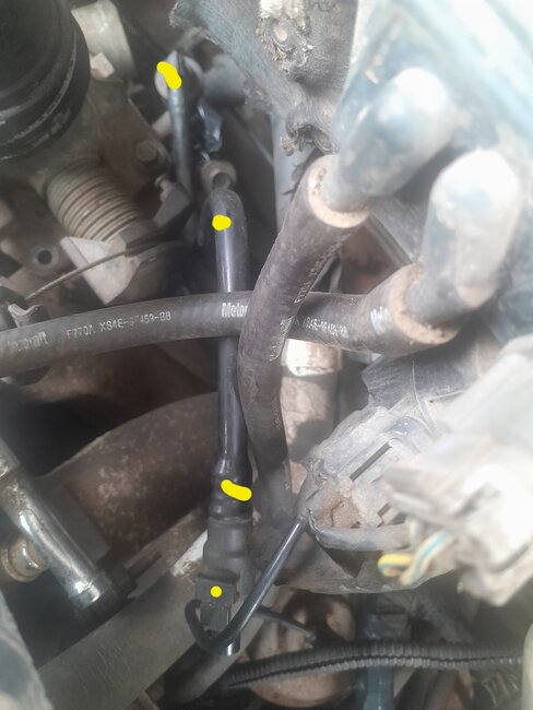

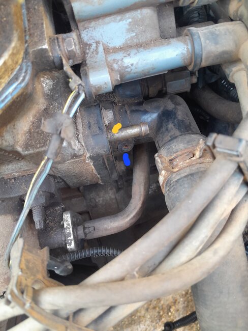

Good day sir! I just discovered that one of the pipes of the thermostat housing has not been there. I have now known the source of my confusion about the hoses LOL. In the end, the car must still drive if someone has damaged it. I don't know the choice to make between Dorman, Motorad and SKP for the thermostat housing unit with the sensor. Does cleaning agent like liquid molly work? In the attached image is another metal pipe identified with yellow. Where does it lead to? I can't find the brake level sensor cap. Can the car work well without it or will it affect the electrical circuit? Can I still apply the same discount code because I have made an order of the lower radiator hose and pipe already. Thank you very much for being amazingly supportive. God bless you richly.
Dec 2, 2023 at 6:53 AM
MAMIRORO SMITH
  • 83 POSTS
3M5Z-8K012-BA is this the right part number from the expansion tank to the thermostat housing.
Dec 2, 2023 at 8:00 AM
I believe that the pipe runs to the heater core. Do you know if the heater worked before now?
As far as the parts are concerned, I have always had luck with Dorman parts.
Dec 2, 2023 at 7:42 PM

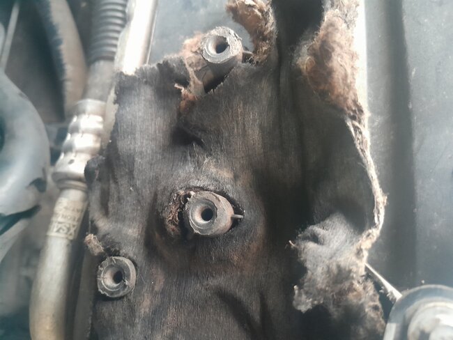

Greetings boss, I just observed now that the EVAP hose is broken close to its attachment. Where does the EVAP pipe lead to? Can the car function without it? Kindly help me identify the hoses and pipes that go into those places identified. Does anything supposed to be on firewall that was removed without those pipes looking agape. Thanks for all that you have been doing and God bless you.
Dec 17, 2023 at 8:51 AM
MAMIRORO SMITH
  • 83 POSTS
What name or part number can I use to search for the hose/pipe from the vapor canister even if it has been discontinued? Thanks
Dec 17, 2023 at 9:32 AM
MAMIRORO SMITH
  • 83 POSTS
What's the function of this hose/pipe and it connects to where please? Your response is very much appreciated. Thanks, and God bless you.
Dec 17, 2023 at 11:36 AM

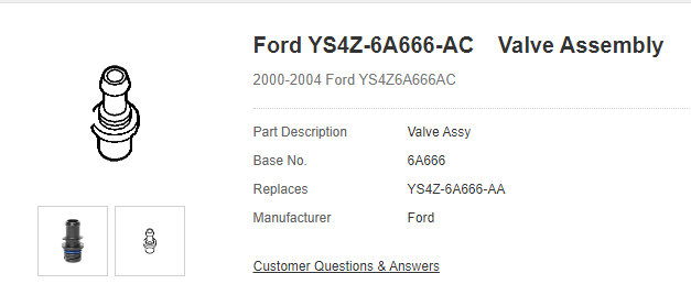

I believe that it is the PCV valve hose. If you follow it, does it go to the valve cover and connect to the PCV valve? See pic below. If it does, the opposite side should be to either the air inlet tube or throttle body.
Dec 18, 2023 at 7:46 PM

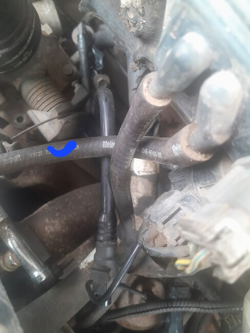

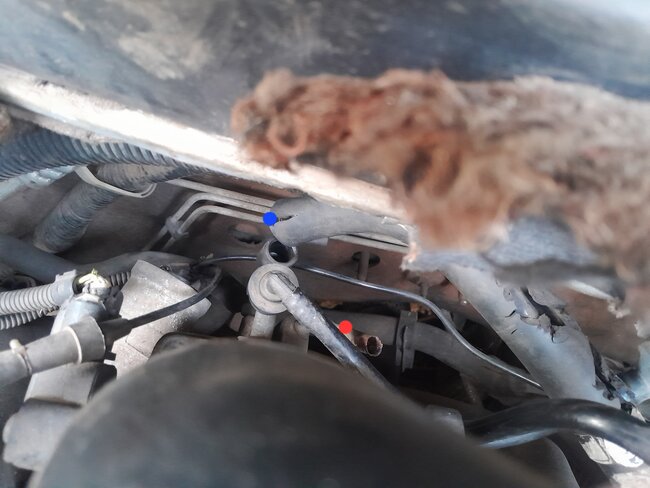

I can identify where the PCV hose which I highlighted with blue. There's another opening I highlighted with red. Which hose goes into it?
Dec 19, 2023 at 9:07 AM
I'm sorry, but I don't have access to the part numbers. It may be due to the model year. As far as the hose, can you tell me where it leads on either end?
Dec 20, 2023 at 9:14 PM

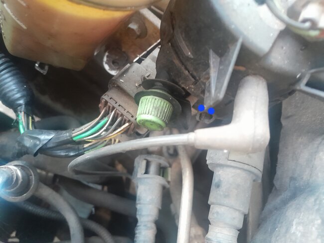

Good morning sir, I got this vapor canister on the Internet, can it work for my model. Where does the hose from the vapor canister leads to. If this is resolved, I have just these two intake manifold hoses figure out, we are good for the the moment. What are the two hoses and where do they connect. All your contributions and efforts are well appreciated. God bless you abundantly.
Dec 20, 2023 at 10:41 PM

Do the EGR, vapor canister purge regulator, brake booster connects to the intake manifold?
Dec 21, 2023 at 10:12 AM
All of them require a vacuum supply.
Dec 21, 2023 at 10:13 PM
