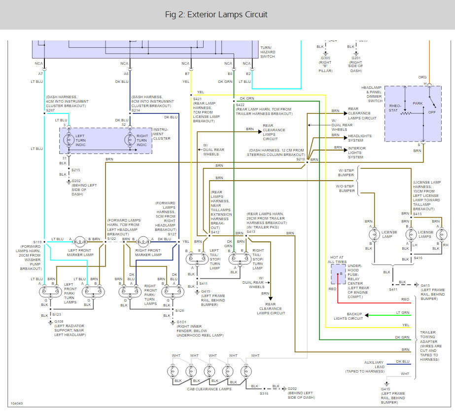

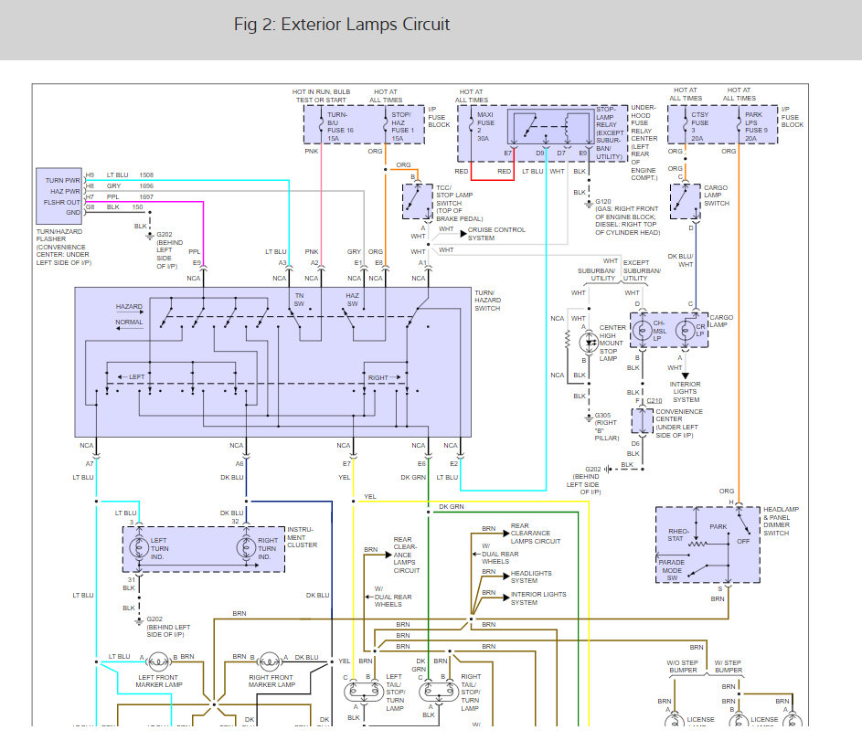

Neither one of my turn signals work. My hazards do but neither left nor right side work individually. The turn light won't even light up on my dash but does for my hazards. I've replaced the relay located by the foot pedals so not sure what it could be. Please help.
Mar 4, 2019 at 4:51 AM
JDL
  • 16,098 POSTS

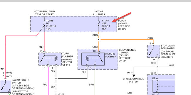

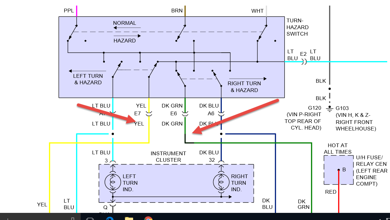

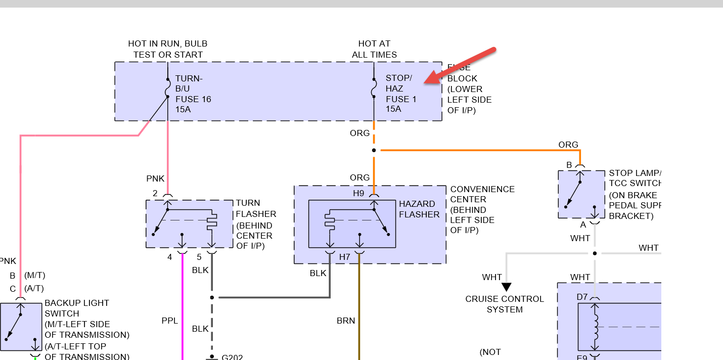

Did you check the fuse, upper left in diagram, turn/backup fuse? Not only check the fuse, use a test light on fuse circuit to check for voltage, goes hot with key on. Could be other issues like turn signal switch? Always check voltage and grounds.
https://www.2carpros.com/articles/turn-signals-not-working-blinker
Mar 4, 2019 at 6:41 AM
JASON ARCHAMBEAU
The diagram you attached, is that for the fuse panel on the drivers side of dashboard? Also, does that mean to check fuse #16? Sorry but I'm completely ignorant when it comes to electrical issues.
Mar 4, 2019 at 6:56 AM
JDL
  • 16,098 POSTS
Yes, fuse 16--15 amp, interior fuse box.

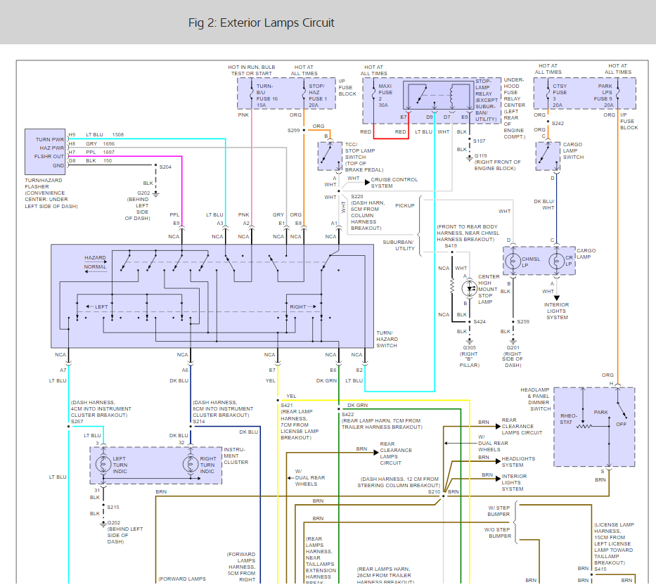

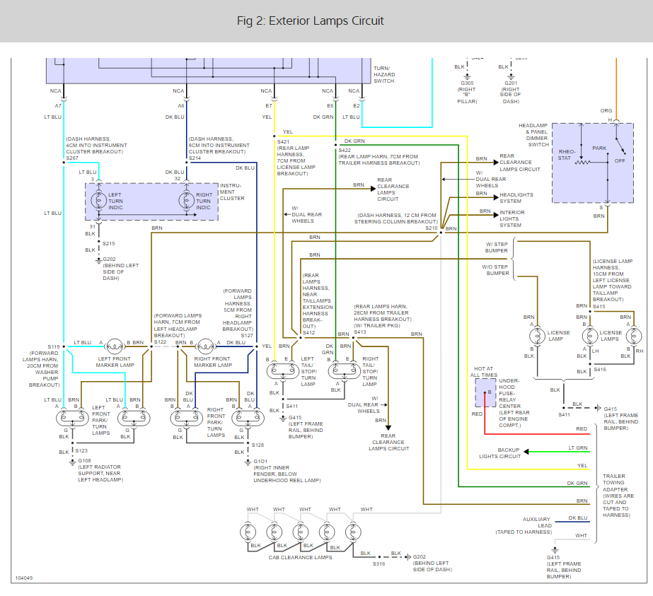

i found you a diagram in "mitchell"
this one is for "exterior lamps"...looks like it shows what you are interested in
there are many more for the rest of the wiring, it is not feasible to get 'em all for you (mitchell sorta wants you [and me] to subscribe to their system, they are not a non-profit organization!)
without broadcasting your email address in open forum, if you cannot see this diagram well......tell me....i will initiate a way to get it to you. mitchell diagrams are "crisp" in my downloads, they are so ez to understand. depending on size and content, they may show up great....then again, could be a blur, once i load it into my answer

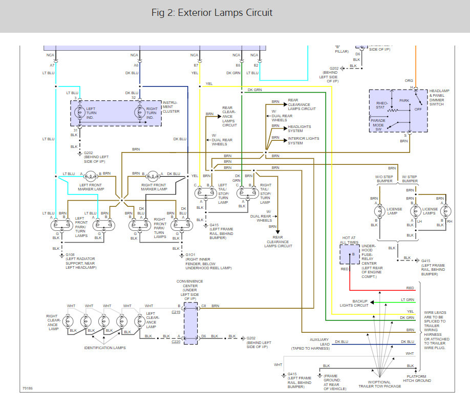

VTOWNER
i have the same drawing and i did check everything with a voltmeter, discovered a new problem with driver front light too, its being looked at again by GM at the moment.everything points to the switch in steering column malfunctioning intermittently from conversation with mechanic so there looking into for me if parts are needed

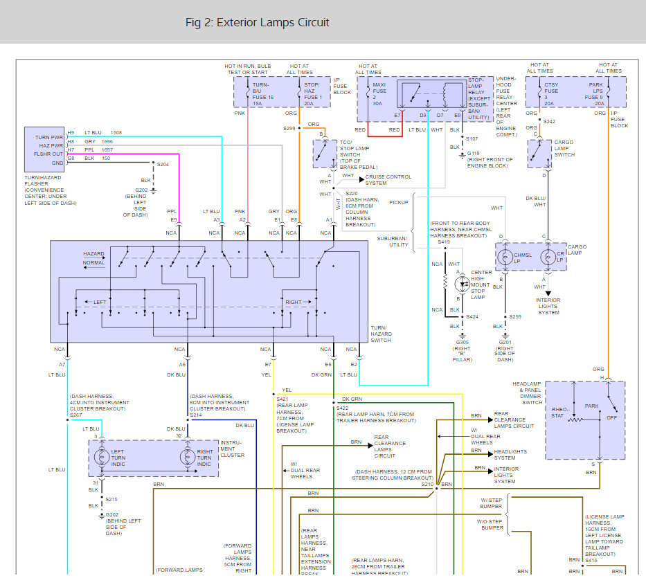

LUCKY_SEVANS
Girl friend's truck has no brake lights or signals, but hazards work. Turn signals work up front. Parking lights work. Assuming double filament bulbs good based on hazards. Been reading online and cannot figure out what to do. Not familiar with truck and only barely familiar with electrical. No money to take to professional and she needs a running vehicle. Please point me in right direction. Today is perfect because in Washington and it is not raining,
Oct 25, 2020 at 12:05 PM (Merged)

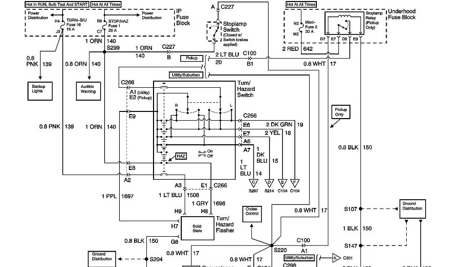

CARADIODOC
  • 34,306 POSTS
The best suspect is the turn signal switch. The hazard function goes through just one small part of that switch, but when switched on, it disconnects a number of circuits within the signal switch. It's one of those contacts that is likely failed.
First, check if the backup lamps work. If they do, the turn signal fuse is okay.
The "Brake light" fuse has to be okay because that runs the hazard flasher.
Look for the "Brake light" relay in the fuse box under the hood. Feel if it clicks when a helper presses the brake pedal.
Next, we'll have to go to the wires going to the signal switch and test for voltage with a test light. I'm trying to figure out from the diagram which wires to check.
LUCKY_SEVANS

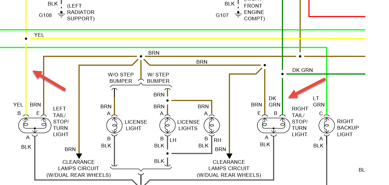

I figured it out! tracing the wires from the front I kept getting voltage all the way back to the tail light plug. But still could not get turn signals or brake to light bulbs (right or left). When I was pulling out one of the bulbs while turn signal was on I saw it light the second filament as I pulled it out. If bulb seated properly no contacts, but pulled out some and jiggled a bit and I had function. I manipulated the contact (springs) and voila! Rinse and repeat for the other side.
Wait, why was I getting hazards originally? Do they light up the other (top) bulbs and I just do not remember?
CARADIODOC
  • 34,306 POSTS
My diagram showed the same one bulb on each side for signal and brake function. Don't have a suitable answer as to why the hazards worked.
Common things to look for on the sockets include rusty housings for the older 1157 brass-base round bulbs, and contacts overheated and melted into the plastic base. Those contacts are spring-loaded, so when the plastic melts, the contacts sink into the base and no longer touch the contact on the bulb. You can make a temporary fix by adding a drop of solder to the contacts on the bulb.
For the newer plastic-base 3057s, it's real common to find the contact tabs in the socket badly-corroded. Two of them are grounds, but for the two different filaments. You can get a clue a ground is bad by observing that with only one working signal light, it will stop lighting up when the bulb on the other side is removed. Current goes through the bulb that appears to be working, can't get to ground, so it doubles back and goes through the tail light filament, over to the tail light on the other side, through it, THEN to ground on that side. Current goes through three filaments so the one that appears to be working is actually not full brightness. That three-filament circuit can't occur when the brake lights are on, so the signal works properly on the good side, and the one on the bad side goes fully-off. This is where you see the two lights switch between bright filament and dim filament alternately, especially on trailers.
