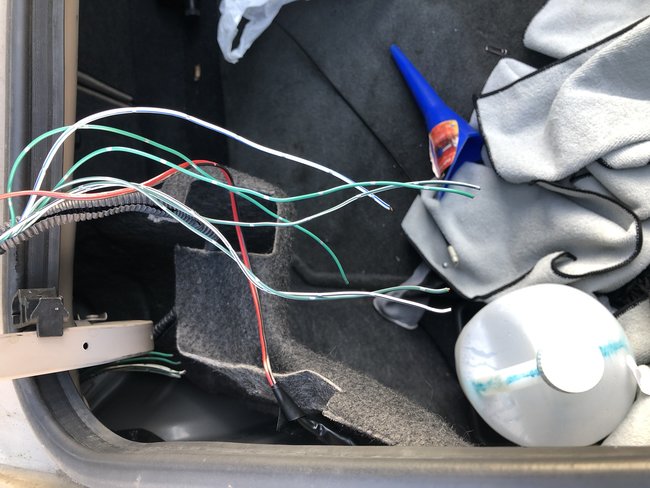

Trunk latch not working
2003 TOYOTA CAMRY
120,000 MILES
VLADSC50
  • 42 POSTS
All right. I’ll keep looking for a scanner. Any recommendations that I can purchase?
Sep 10, 2021 at 2:08 PM
No, call around to local shops and ask them if they can access body control module information.
That is the easiest and cheapest way to get to the root cause of failure here.
Sep 10, 2021 at 2:09 PM
VLADSC50
  • 42 POSTS
Hey Roy, it turns out I found the problem. It seems like the wires were severed by lack of flexibility. thank you for everything.
Dec 8, 2021 at 7:44 AM
