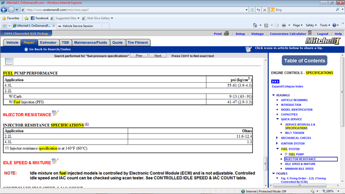

See attached image of fuel pressure specs.

I have a 1995 Chevrolet Blazer 4x4 . my issues is; when I turn the key it fires and stalls right away . If I give it a lot of gas it will run a little bit and it sounds like it's misfiring horribly and then it will turn off a few seconds later . Two months ago I replaced the fuel spider the two incoming lines that go through the throttle body the fuel filter the entire fuel pump and assembly . A week ago I changed the oil everything was fine drove it to work three days later and on the way home from work the next day it started what seemed like a horrible misfire although I was able to make it home. Now when I turn the key it sputters and shuts off . Fuel pressure is between 58 and 61 .
