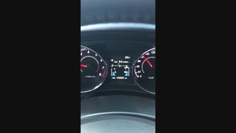

Hi,what happen in this video?what problem?
Apr 19, 2019 at 10:03 PM
PETROYADA
  • 66 POSTS
during driving ,i sense shock.
Apr 19, 2019 at 10:05 PM
Welcome back:
You really need to have the transmission control module scanned to determine what is causing that to flash. My first guess is the range sensor, but it could also be a loose or corroded connector. However, my first suspect is the transmission range sensor.

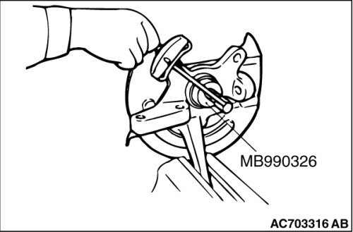

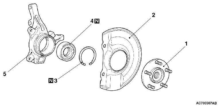

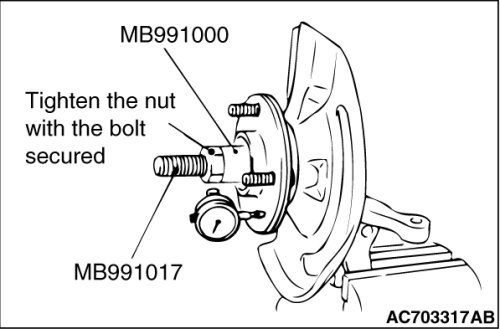

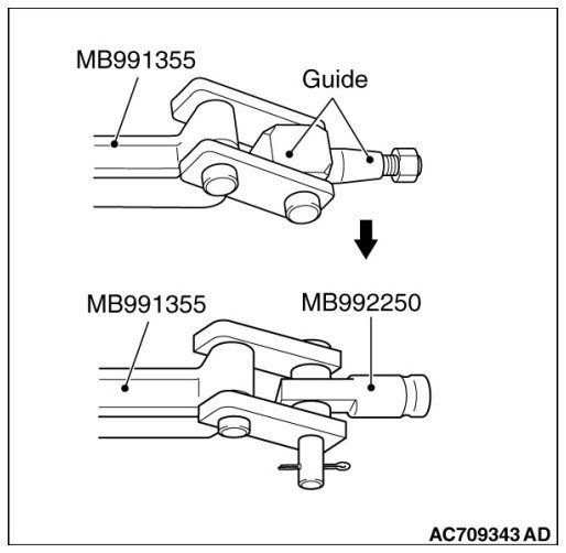

I have noise from front wheel, it seems front wheel bearing are dry. it needs to inject grease to housing. so could you please send to me exploded drawing related to front wheel bearing?
And i need part number for bearing type.
Thanks
May 26, 2019 at 3:22 AM
PETROYADA
  • 66 POSTS
VIN for my car as below:
4p3xtga2wee801499
Welcome back:

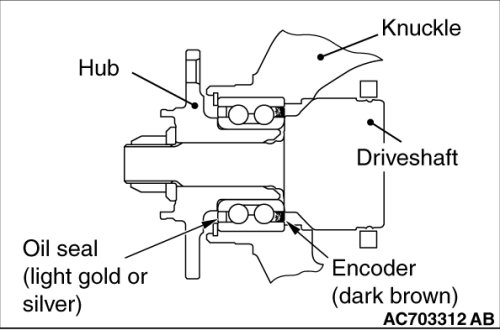

The front wheel bearing is a sealed bearing and not serviceable. When they go bad, they are replaced.
Here are the directions for replacement. The attached pics correlate with the directions.

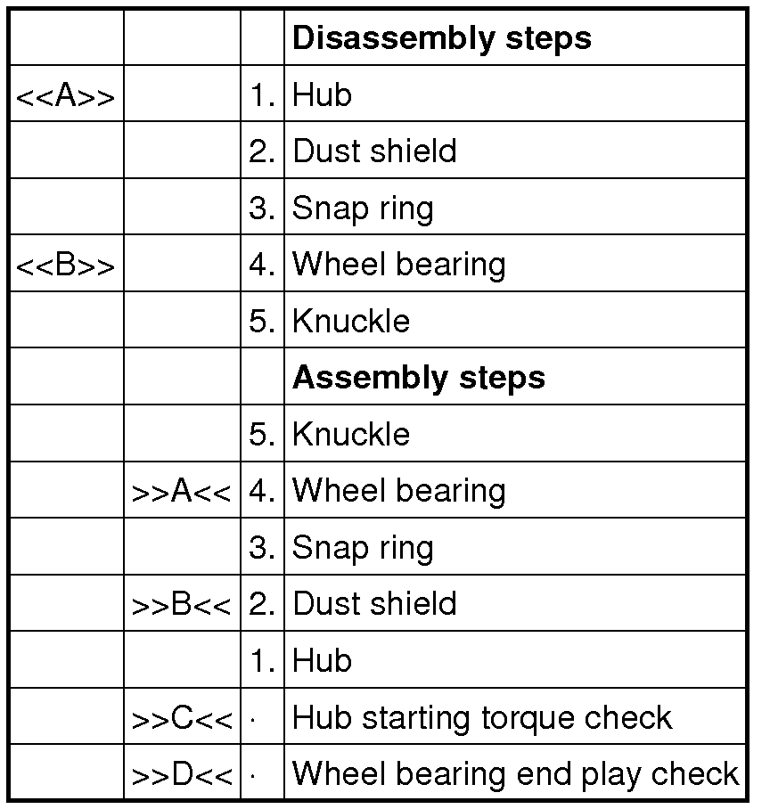

DISASSEMBLY AND ASSEMBLY
pic 1
pic 2

DISASSEMBLY SERVICE POINTS
[[A]]
HUB REMOVAL
CAUTION:
In the hub removal operation, make sure to replace the wheel bearing with new one.

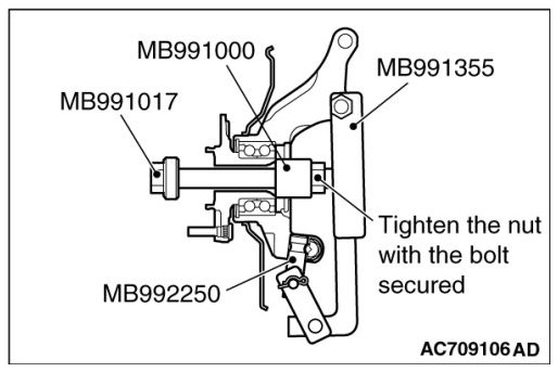

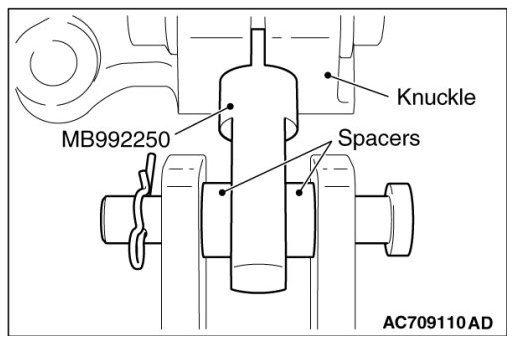

1. Replace special tool MB992250 with a guide of special MB991355 as shown in the figure.
pic 4
2. Insert special tool MB992250 in the knuckle and tighten it with a bolt and nut.
NOTE:
Set the spacers of special tool MB992250 as shown in the figure.
pic 5
3. Use special tools MB991000, MB991017, MB991355 and MB992250 to remove the hub.

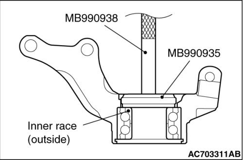

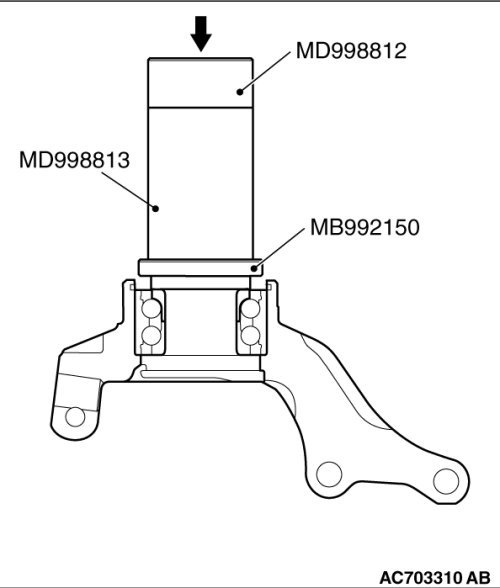

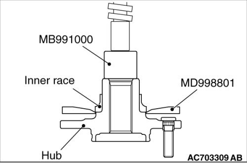

WHEEL BEARING REMOVAL
pic 6
1. Use special tools MD998801 and MB991000 to remove the wheel bearing inner race (outside) from the hub.
pic 7
2. Use special tools MB992150, MD998812 and MD998813 to assemble the inner race (outside) removed from the hub to the wheel bearing.
pic 8
3. Use special tools MB990935 and MB990938 to remove the wheel bearing.

WHEEL BEARING INSTALLATION
pic 9
CAUTION:
- The magnetic encoder for wheel speed sensor is installed in the wheel bearing. Install the wheel bearing so that the encoder is positioned in the direction shown in the figure.
- When press-fit the wheel bearing, push the outer race.
- After press-fit the wheel bearing, wipe off the extra grease in order not to remain on the magnetic encoder.

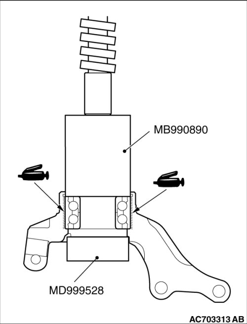

3. Use special tools MD999528 and MB990890 to press-fit the wheel bearing.
4. Remove excessive grease seeped out between knuckle and wheel bearing outer race after press-fitting the wheel bearing.

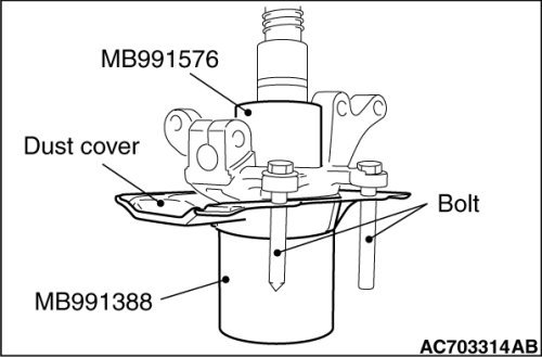

DUST SHIELD INSTALLATION
pic 11
Use special tools MB991388 and MB991576 to press-fit the knuckle into the dust shield.
NOTE:
Use the bolts (M12) to align the caliper mounting holes.

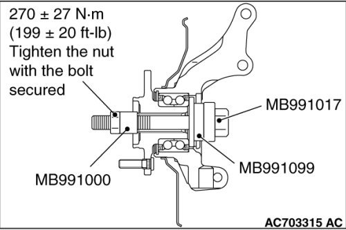

HUB ROTATION STARTING TORQUE CHECK
pic 12
1. Set special tools MB991000, MB991017 and MB991099 as shown in the figure, tighten the nut to the specified torque, and press-fit the hub into the knuckle.
Tightening torque: 270 ± 70 Nm (199 ± 20 ft-lb)
2. Rotate the hub to make the bearing well-greased.
pic 13
3. Use Special tool MB990326 to measure the hub rotation starting torque.
Limit: 1.5 Nm (13 in-lb)
4. Hub rotation starting torque should be within the limit value, and there should be no roughness and gritty feeling in rotation.

WHEEL BEARING END PLAY CHECK
pic 14
1. Use special tools MB991000 and MB991017 to measure to determine whether the wheel bearing end play is within the specified limit or not.
Limit: 0.05 mm(0.002 inch)
2. If the end play is not within the limit range while the nut is tightened to specified torque, the bearing, hub and/or knuckle have probably not been installed correctly.
Replace the bearing and re-install.

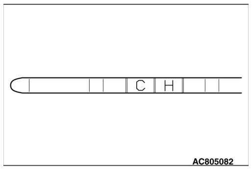

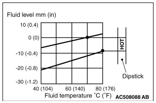

Could you tell me please how much i should be replaced CVT flush oil. how much oil should be refilled?
Also i needed procedure for this instruction.
Aug 23, 2019 at 9:25 PM
Here are the directions for servicing the transmission. The directions include how much fluid is needed. The attached pics correlate with the directions.
______________
2014 Mitsubishi Truck Outlander AWD L4-2.4L (4J12)
Transmission Fluid Change
Vehicle Maintenance Fluids Fluid - CVT Service and Repair Procedures Transmission Fluid Change
TRANSMISSION FLUID CHANGE
pic 1

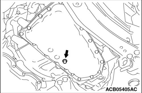

1. Remove the drain plug on the bottom of the transaxle case to drain the transmission fluid.
Draining amount: Approximately 5.5 dm3 (5.81 qt)
2. Install the drain plug with a new gasket to the transaxle case, and tighten it to the specified torque.
Tightening torque: 34 ± 2 Nm (25 ± 1 ft-lb)
3.
CAUTION:
If the transaxle case becomes full before filling 5.5 dm3 (5.81 qt) of transmission fluid, stop filling the transmission fluid.
Fill in the new transmission fluid through the oil filler tube.
Filling amount: Approximately 5.5 dm3 (5.81 qt)
Transmission fluid: Mitsubishi Motors Genuine CVTF-J4
4. Start up the engine and let it idle for 1 to 2 minutes.
5. Move the selector lever to every position, and then move it to the P or N range.
6. Stop the engine and perform the above steps 1 to 5 again.
7. Stop the engine, and discharge a small amount of transmission fluid to check for fouling. If fouling is found, repeat steps 1 to 5 until clean transmission fluid comes out.
pic 2
8.
pic 3
9. Drive the vehicle until the transmission fluid is warmed up to the normal operating temperature 70 - 80°C (158 - 176°F), and check the transmission fluid level. It must be within the "H" area on the oil level gauge.
NOTE:
The "C" level is for reference only. Use the "H" level as the criteria.
NOTE:
Use scan tool (M.U.T.-III) to measure the transmission fluid temperature.
NOTE:
When a certain amount of time is required to warm up the transmission fluid to the normal operating temperature 70 - 80°C (158 - 176°F), check the oil level referring to the characteristics chart.
10. Adjust the transmission fluid level to the specified level. Refill the transmission fluid when the fluid level is low, and drain the transmission fluid through the drain plug when the fluid level is high.
11. Securely insert the oil level gauge into the oil filler tube.
12. TCM records the deterioration level of the transmission fluid. After replacing the transmission fluid with new one, use scan tool (M.U.T.-III) to reset the deterioration level recorded in TCM.

where do we find out that the time has come to replace the CVT oil?
Aug 24, 2019 at 12:20 AM

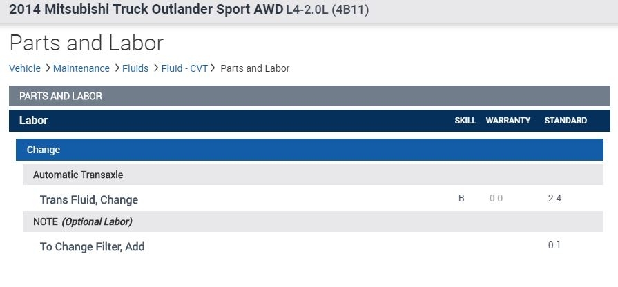

I'm not sure what you needed or why you provided the VIN. As far as labor is involved with servicing the CVT, see the attached picture.
A maintenance schedule should be in the vehicle owner's manual.
Let me know if that helps.
