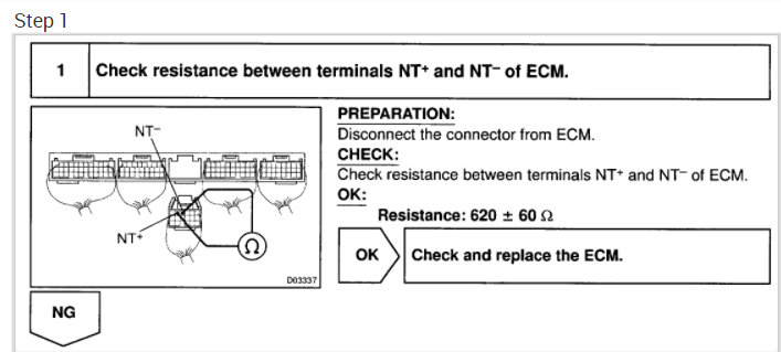

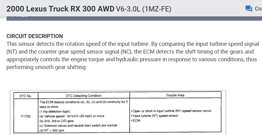

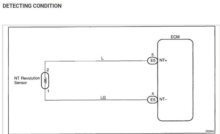

My transmission doesn't shift to higher gear and drives sluggishly when check engine comes on. Note check engine shows after driving for 5 minutes.
I scanned and got a p1725 error, what can I do?
Sep 13, 2020 at 6:31 AM
DANNY L
  • 5,648 POSTS
Hello, I'm Danny.

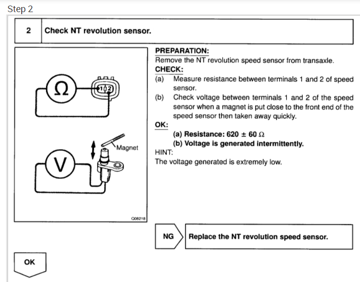

I've attached picture diagnostic steps below relating to the trouble code P1725 you provided.Hope this helps and thanks for using 2CarPros.
Sep 13, 2020 at 2:23 PM

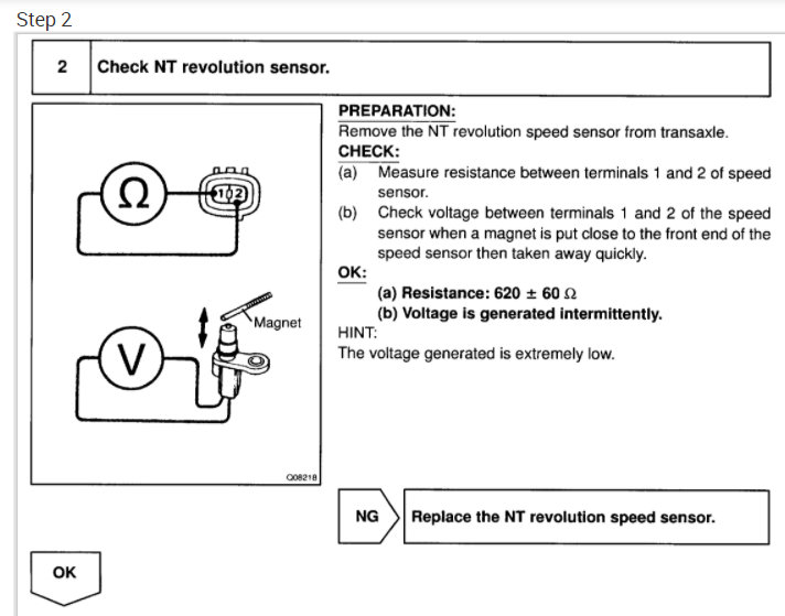

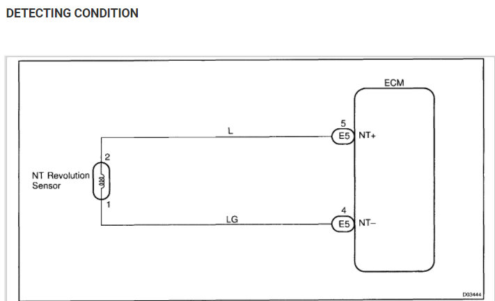

Hi, thanks. I removed the NT speed sensors and tested it's resistance it read 667 and 686 respectively, the voltages was extremely low. Is this a good sign? So I just cleaned it.
Sep 19, 2020 at 8:26 AM
It sounds like the input shaft speed sensor is bad. here is how you can replace it. Check out the diagrams (below). Please let us know what you find. We are interested to see what it is.
Sep 22, 2020 at 12:24 PM

Yes, the resistance is within range.. It seems you are having an issue with the ECM then. You can find them remanufactured online but I suggest to buy new. I can give you a part number but I would need your VIN - vehicle identification number to confirm proper part. Hope this helps and thanks again for using 2CarPros.

Hi, thanks Danny. I changed the NT sensor and all is well. I guess it was damaged a little. Thank you once again.
