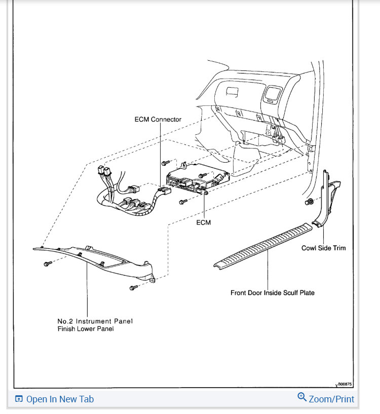

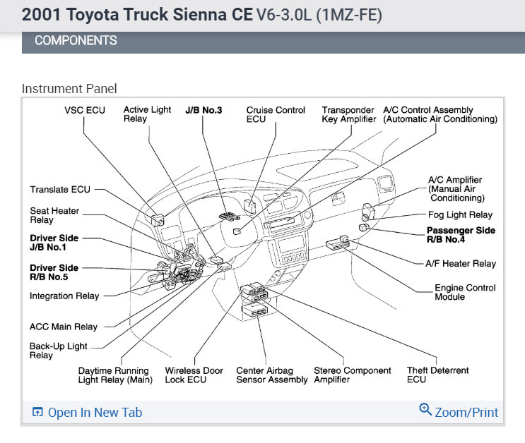

That is a good one. I would replace the ECM please give your VIN number to the rebuilder. The instructions to do so is in the diagrams below. Check out the diagrams (below). Please let us know what happens.
