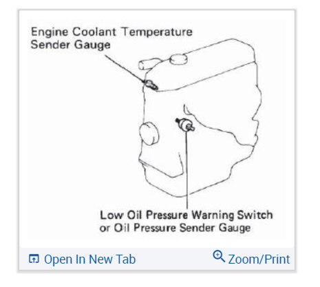

I have seen the engine coolant temperature sensor causing this issue it shorts out at times causing the engine to have issues. Here is a guide to show you the steps to change it and the location of the sensor on your car below:
https://www.2carpros.com/articles/coolant-temperature-sensor-cts-replacement

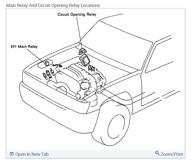

If the gauge is working the sender can be okay, does the EFI and circuit open relay work? Here is the location and a guide to test them:
https://www.2carpros.com/articles/how-to-check-an-electrical-relay-and-wiring-control-circuit.
If they check out I would get a used ECM and install it.

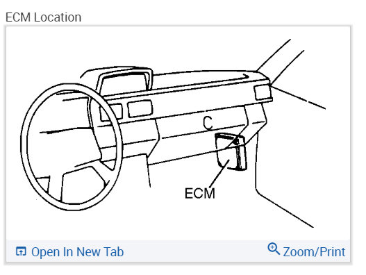

JOSH BUKOSKEY
  • 5 POSTS
The issue/result.
I did end up taking the computer out and sending it in to get checked. It tested out fine and nothing wrong so the computer testing company (based out of FL) sent it back. When I put it back in everything was good for a few days and then the same issue happen again...
After a lot of headaches I figured out that the issue was indeed the computer. I ordered a completely new one and the one sent me was bad (after more headaches). Sent it back and got a new one and everything works great. I also replaced the MAF after already replacing before.There were other frustrations while looking for the problem.
If I learned anything from this its just because a part you get is new doesn't mean its good.
