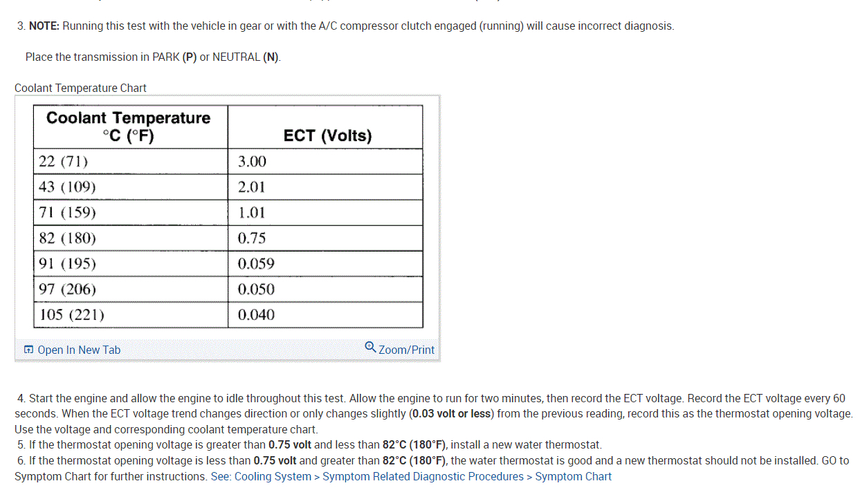

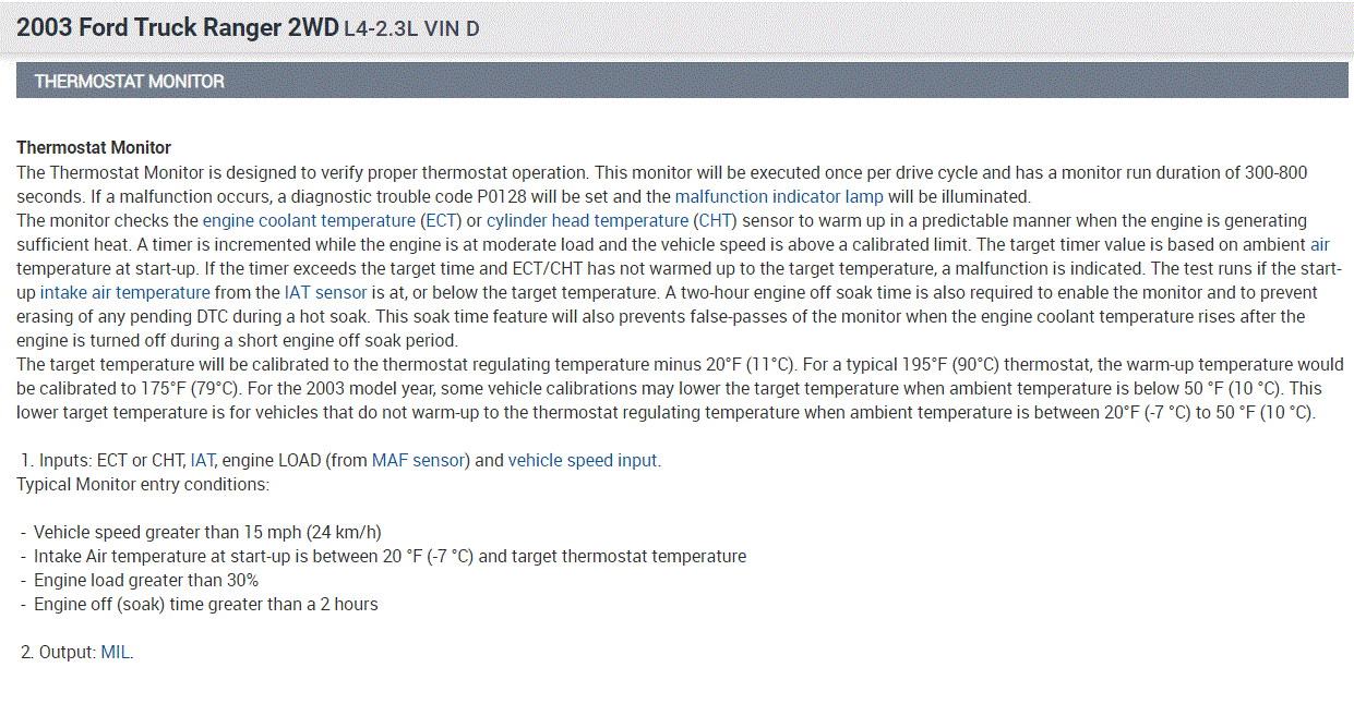

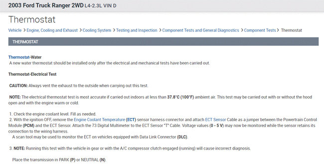

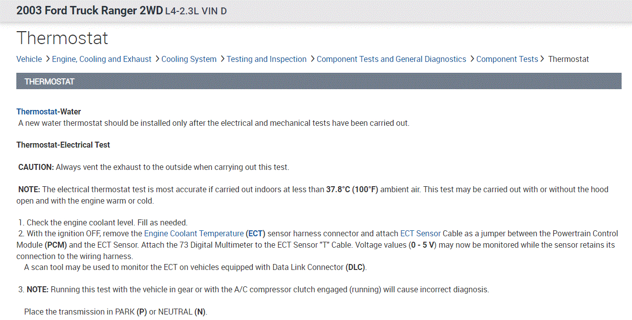

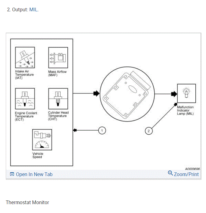

Oct 29, 2021 at 11:18 AM
It could be the thermostat monitor. Do me a favor. I attached the diagnostics for testing the system. Take a look through them and let me know if you are comfortable performing the tests.
See pics below.
