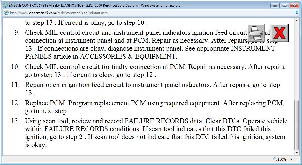

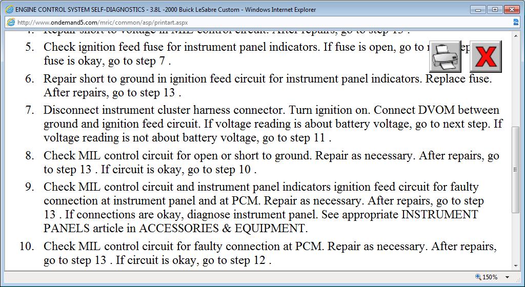

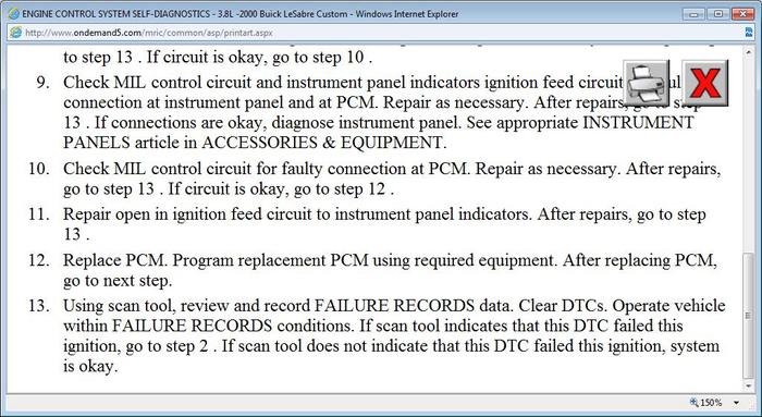

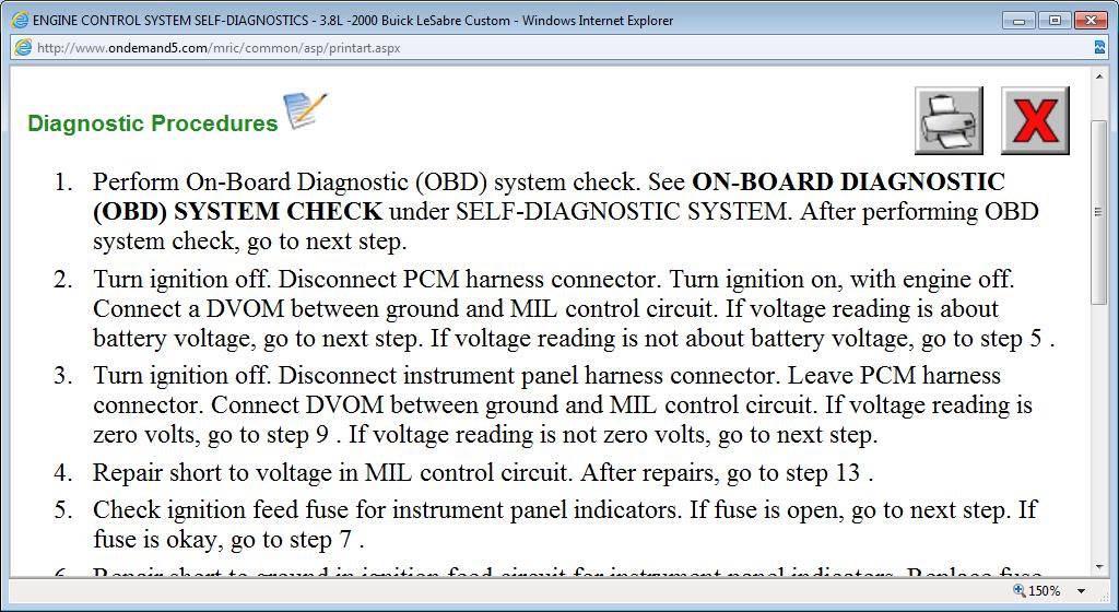

Follow the trouble tree for the P0650 i posted.I cant find any info on any of the B codes.The U codes are class 2 data codes it says if there is a total loss of class 2 data the car wont start.

Hmmmm..... ok what is PCM, and a DVOM? Where are they located? Will need to borrow the code tester again? What is the MIL control circuit? Dude I'M not trying to sound stupid /but I'm a helo engine mechanic not an electrician, so I'm gonna ask alot of questions. As my son nor I have a manual the ability to locate these components is gonna be challenging. please bare with me

The pcm is the powertrain control module the cars computer for the engine and transmission.Its located in the air cleaner housing.He mil is the check engine light does that come on when you turn the key on?Also the mil control circuit is the wires that run from the pcm to the mil to turn it on.Dvom digital volt ohm meter iam sure you have used those to fix the helos?

what is needed to perform the OBD and where is the MIL control circuit located?

There asking if the check engine light works when you turn the key to the run position without starting it.The control circuit for the light runs from the pcm to the cluster then to the blub.
