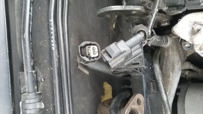

What is this and it it suppose to have power?
Apr 30, 2018 at 3:34 PM
Looks like it plugs into the connector next to it.
Apr 30, 2018 at 3:35 PM

Okay, did you receive my picture? It is on the fire .
Apr 30, 2018 at 3:46 PM

did you plug the connector in??
did you do the tests I suggested a while ago looking for power to the solenoid wire???

Did you remove that connector when you removed the upper manifold??
Let me check the wiring diagram.

The picture you sent me with the open connector.
May 1, 2018 at 2:44 PM

Can you recheck that connector? I am very curious about that. it looks like it needs to be connected somewhere.
May 1, 2018 at 3:02 PM
I got one picture. and it looks like they are both female connectors. that means there are two connectors that go in there from the upper intake you have off.
May 1, 2018 at 3:21 PM
TIMMAHANEY
  • 65 POSTS
I pulled them apart.
May 1, 2018 at 3:26 PM
what did they hook up to?
May 1, 2018 at 3:29 PM
TIMMAHANEY
  • 65 POSTS
I just connected them.
TIMMAHANEY
  • 65 POSTS
The closet one to the fire wall is female.
May 1, 2018 at 3:31 PM
TIMMAHANEY
  • 65 POSTS
Each other.
May 1, 2018 at 3:32 PM
ok, check for power to the starter wire now.

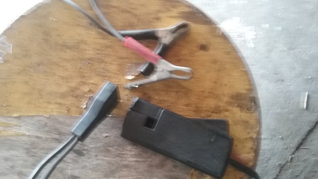

Hey, it is me again. I still have not gotten my car started. Can you please tell me what this is?
