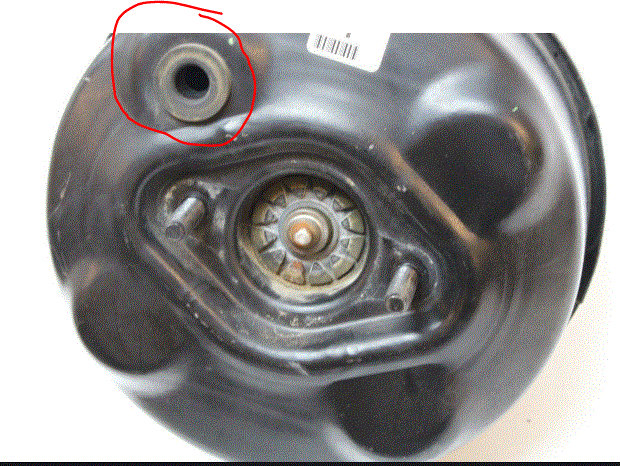

Run two cans of either one or you can do a direct pour into the engine using the brake booster vacuum line as your entrance to pur it into the engine. If you choose to pour it directly into the vacuum line leading into the intake manifold, there are a few things to know;
