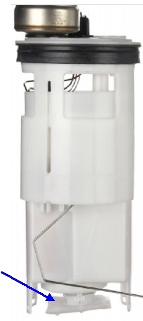

Next day it was just as hot, and the engine died repeatedly around town, then it was fine for the next six months. Funny thing is, outside temperature should not have played a role with this problem. The solution was a new strainer in the gas tank. $12.00 and didn't have that problem until about 12 years later, then only when dragging a huge tandem axle enclosed trailer that's bigger than the van. While driving with the fuel pressure gauge attached, I could see the fuel pressure gradually drop off from the normal 50 psi to less than 20 psi. It wasn't until it hit 15 psi that the engine would start to sputter.

but that is not what we're after. It's important to understand that when Chrysler fuel pumps fail, they almost always fail to start up, leaving you sitting in the driveway or parking lot. Once they start up, they rarely quit while you're driving. (GM fuel pumps are just the opposite. They almost always start up, then they quit or slow down while you're driving, leaving you sitting on the side of the road). On Chrysler products, with running problems that develop while you're driving, the fuel pump is way down at the bottom of the list of suspects, but that strainer is up at the top of the list. From your description of the symptoms, the strainer is a far better suspect than any sensor, but we want to verify that first by watching what the fuel pressure does when the problem occurs. This article shows how to connect the gauge. The first time I drove my minivan with the gauge attached, I had it stuck under the right wiper arm. The second time I drove it for a year and a half with the gauge strapped to the radio antenna.
