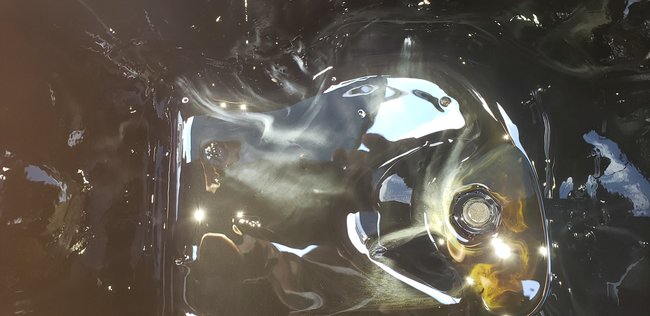

Doing pressure test with oil pan off, lost 1 pound in 35 minutes, saw a few drips. 15 to 14. Going to do it again, the drips were from all other. Very slow, 1 per minute maybe.
Apr 24, 2020 at 4:05 PM
PAUL KRAUSE2
  • 62 POSTS
4 drops in 11 minutes. 2 sround 1 2 around 7, strangely i just seen three slow 1 second streams from oil pump screen. 1 second steam, stop 4 a few seconds and do it 2 more times. Gauge reading 14.5 lbs.
Apr 24, 2020 at 4:24 PM
Okay, then you have an internal leak in the motor itself.
You need a bright LED light and look up inside the motor and see where the source of the leak is located.
It could be a head gasket, intake manifold or a cracked block.
Apr 24, 2020 at 4:31 PM

40 minute, 14.5 lbs, wiped oil off bottom of pistons i could, 5,7 and a couple others. Stayed dry, i think the oil is coming from up above, dripping off cam. 1 place in back, 1 place in front. I'm wiped out, will it hurt if i leave oil pan off tonight? That oil pan is after 4 hours or so of idling.

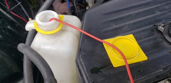

did anyone ever check the voltage in the coolant? Electrolysis will destroy a block if there is too much voltage in the coolant. The voltage comes from bad grounds.

No and I have never heard that. i adjusted voltage on fuel sync from .05v to 5v. where do i check coolant voltage?

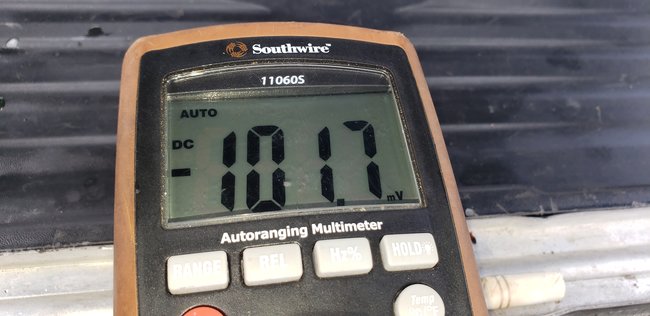

You put your voltmeter in the coolant. Red lead in the coolant and black to ground. anything over .2 volts is too much.
This is a common voltage drop test on any electrical system. It has been done for years.

Hi, for some reason i couldn't find latest message about pulling motor taking engine to a mechanic. I'm amazed i got this far. I have a condition that shuts my brain down and it's all over. Anyway last you told me the voltage in coolant should be no more than .2 v.
Apr 25, 2020 at 11:29 AM
PAUL KRAUSE2
  • 62 POSTS
Was over 120mv in tank.

Hi, for some reason I couldn't find latest message about pulling motor taking engine to a mechanic. I'm amazed I got this far. I have a condition that shuts my brain down and it's all over. Anyway last you told me the voltage in coolant should be no more than.2 v.
Apr 25, 2020 at 11:31 AM
PAUL KRAUSE2
  • 62 POSTS
How can this be be so high? Its mv does that matter?
Apr 25, 2020 at 11:32 AM
That is a good reading.
