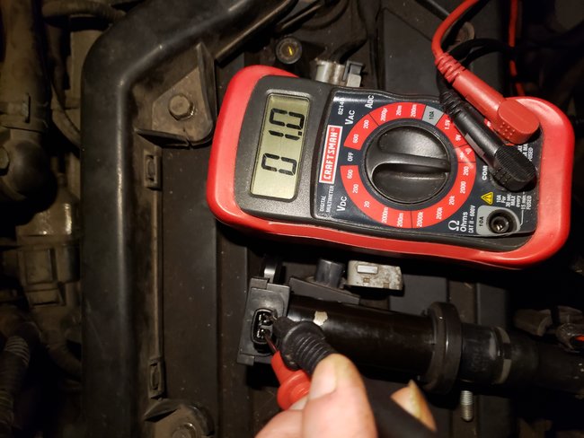

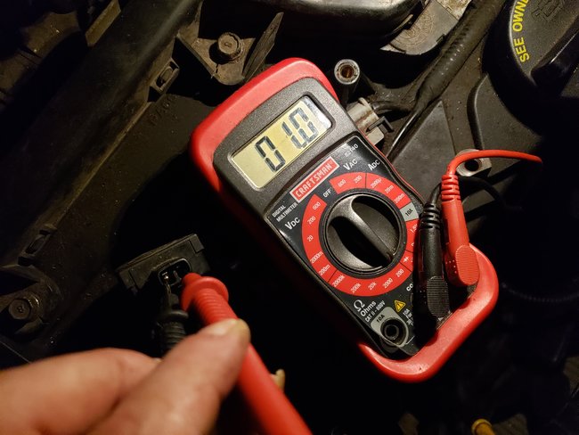

I get 1ohms on all the coils with the multimeterset at 200ohms. If I set it at any other setting for ohms it reads 0. Does that mean they need to be replaced?
Aug 18, 2020 at 11:08 PM
No, not at all.
The real way to test coils is with a scope to see what voltage is being sent to the plugs.
That would be part of the diagnostic from a shop unless you have a scope.
