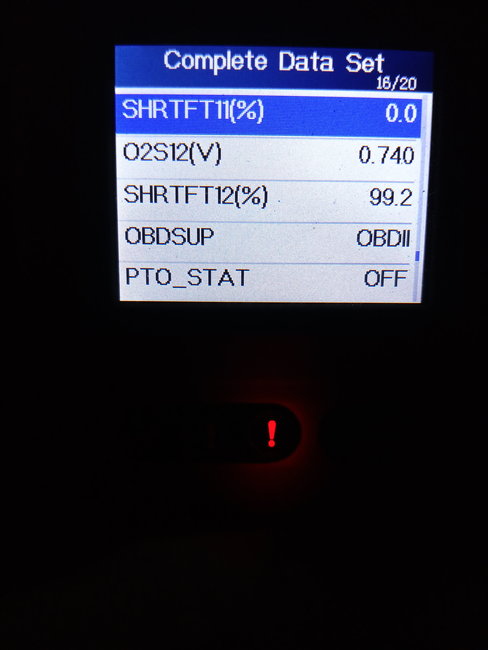

Engine randomly shuts off, sometimes I can drive for 5 minutes sometimes an hour?
1996 DODGE RAM

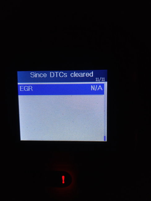

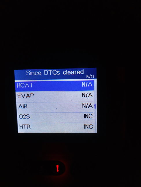

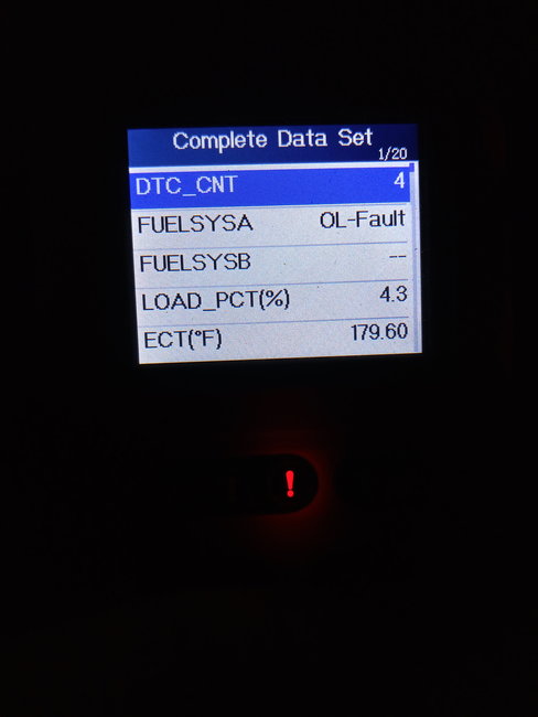

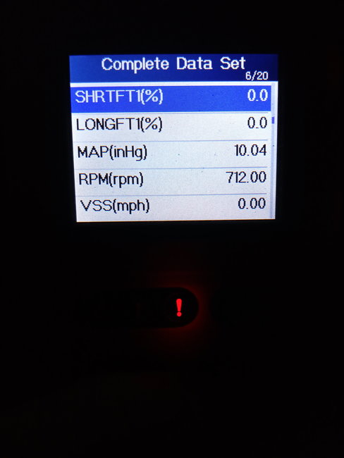

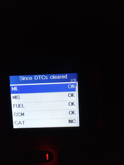

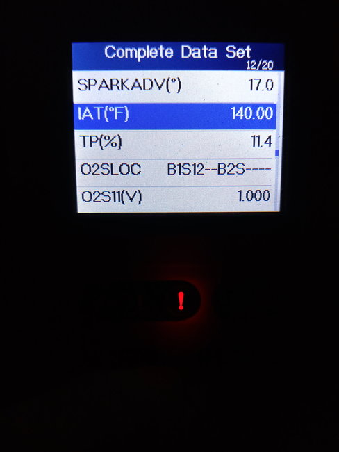

When I took these pictures it was running fine.
When I checked for vacuum leaks I didn't hear anything, but I didn't spray anything on the hoses I just checked to see it there was any wear and tear holes or splices and didn't see anything like that.
