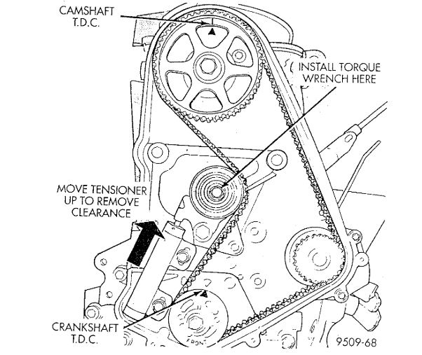

I just had good friend put the car on code reader an the code was P 1390. cam/crank timing. is that saying timing belt needs be replaced?
Dec 23, 2019 at 7:10 PM
Yes. I would check it out to be sure. When there is too much slack in the belt it will set the code
Dec 23, 2019 at 7:15 PM
JOHN GLASS
  • 53 POSTS
thank you. and when I get tore down I just need make sure the marks are in line before pulling belt??
Dec 23, 2019 at 7:33 PM
Okay, just pull the cover and see if the marks are aligned.
I attached a view below for you to view.
