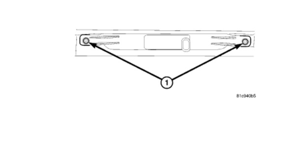

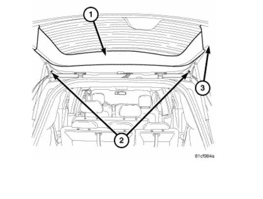

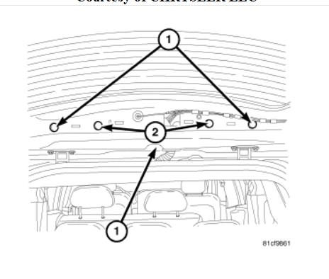

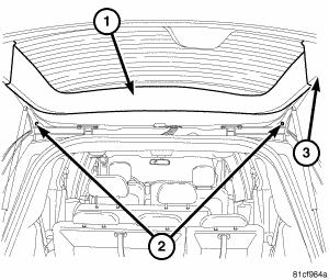

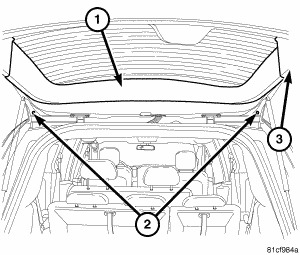

the bulbs are led and the whole CHMSL must be replaced as a unit. you have to open liftgate take off panel then spoiler here are pics.
CLICK TO ENLARGE!

Need to remove liftgate panel see diagrams

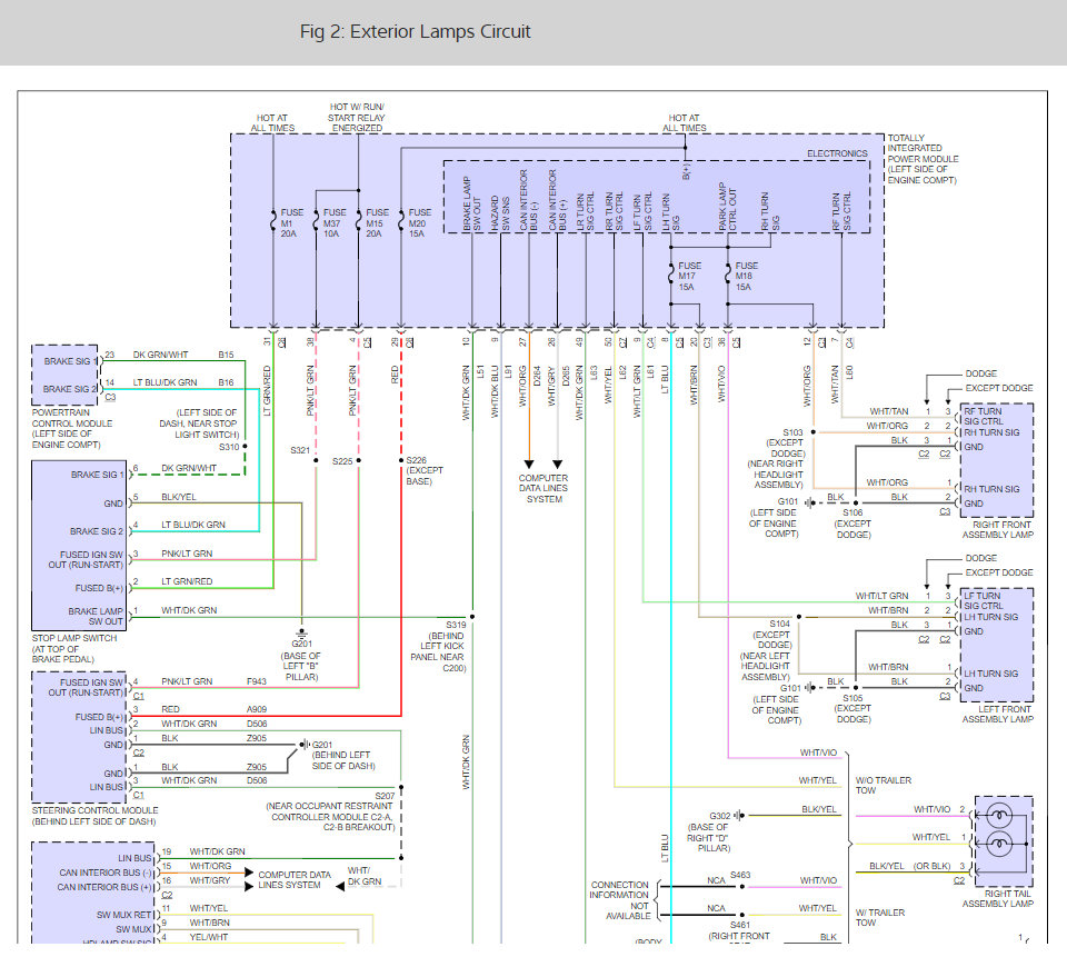

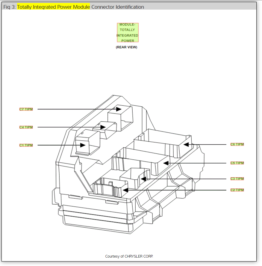

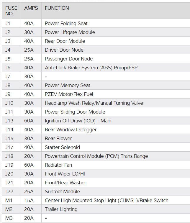

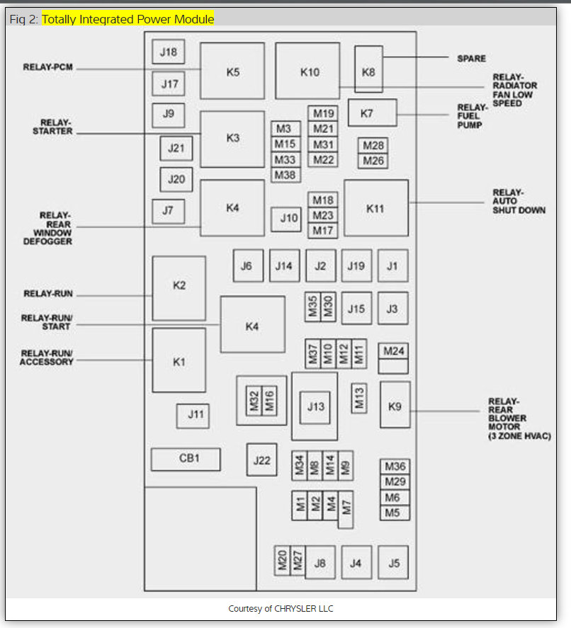

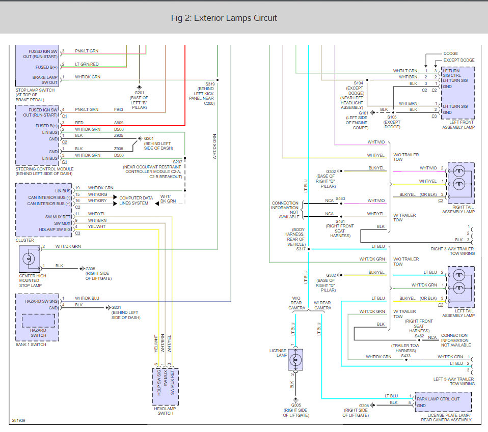

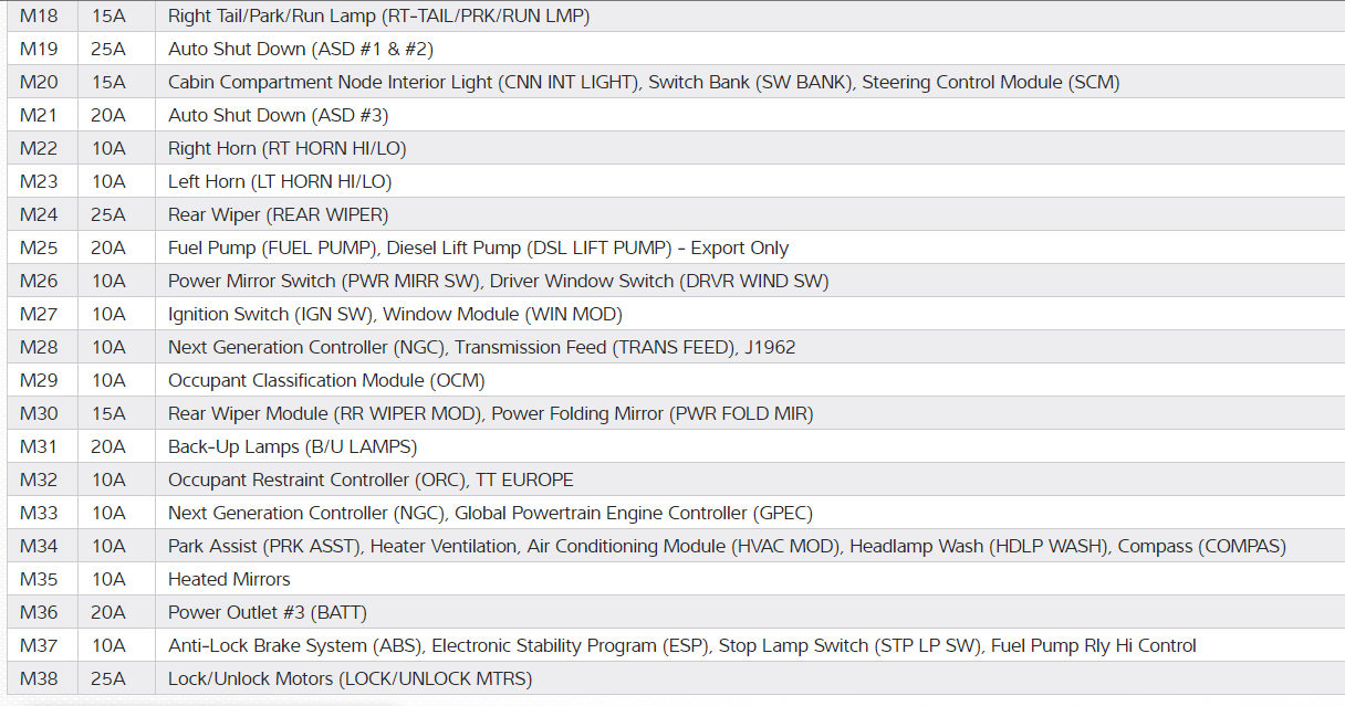

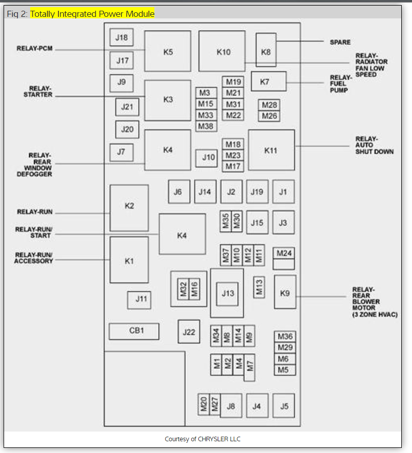

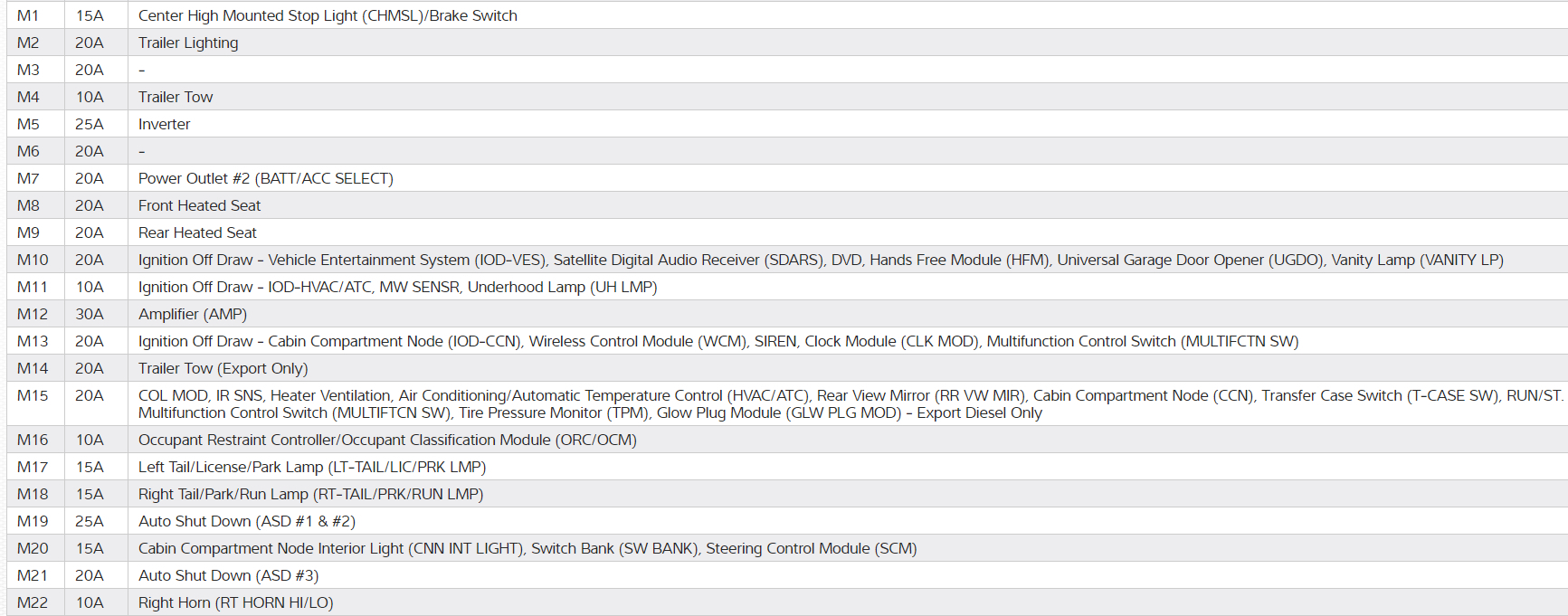

Here are the wiring diagrams and a guide to help you see what the problem is. The power to the third brake light comes from the TIPM and there are many fuses that run it. First see if the brake light is getting power at the light.
then check the fuses,
Here is the fuse location and the diagrams (below)
If all of the fuses are good then its most likely the TIPM is going out which they had problems with. A shop will need to program the unit unit in.
Please let us know what you find.

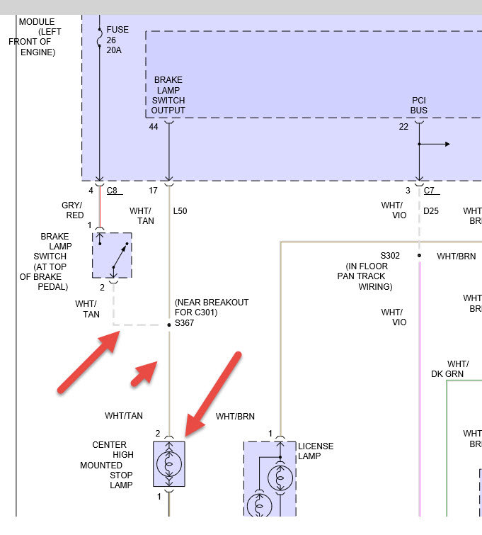

HMAC300
  • 48,601 POSTS
you can see by the picture it may already be wired direct, so see if power is going to the light then backtrack wire to see if it is broken. If no power, if power is there then check the ground wire which is in lift-gate.

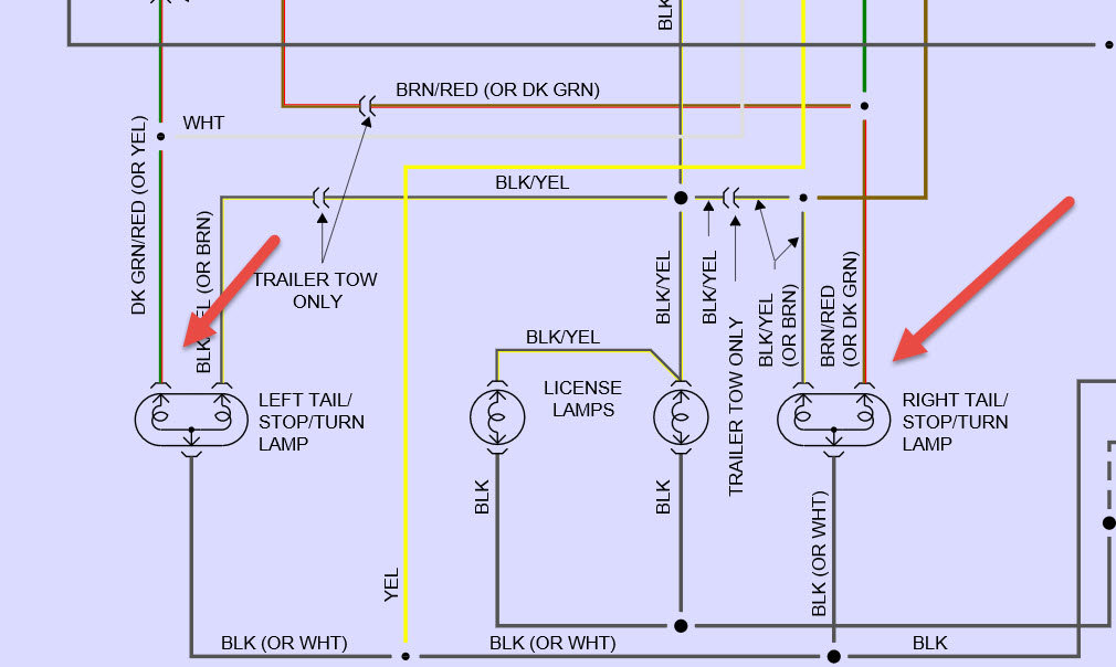

HMAC300
  • 48,601 POSTS
check bulbs first you shouldn't have to remove wires. see pic arrows point to brake/turn signal wires then check to see if you have a bad brake switch if turn signals work

BMRFIXIT
  • 19,053 POSTS
check fuse 26 its 20A fuse
fuses located under hood beside battery

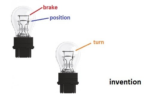

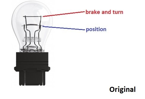

OTEADOR
so is.
in my vehicle the brake light bulb is the same as the turn light.
attached referential image (original)
I want to separate the lights so that the signal is turned separately. attached image called invention.
excuse my drawings, I did the best I did.
greetings and thanks.

DANNY L
  • 5,648 POSTS
Hello again.
So just to be on the same page you are just trying to flip the positions of the brake and taillight positions on the filaments? Let me know.
