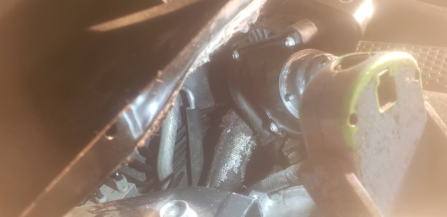

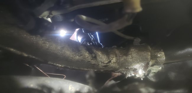

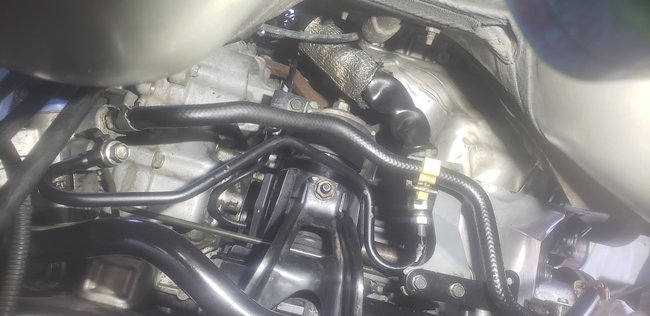

Sorry that cut off. it's covered by a cloth like covering making seeing a leak impossible. however i see fluid wetness at the end of this cloth above the switch leading me to believe it's that line somewhere behind the rubber and cloth and not from the switch after all. what are your thoughts? Below are some pics.
Sep 22, 2021 at 9:45 AM

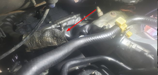

Just to confirm we are talking about the same hose. You are seeing the one I am pointing to with moisture on it? If so, it looks like it is twisted as it should not be collapsed like that.
If you are seeing oil on it, then it needs to be replaced.
Sep 23, 2021 at 9:12 AM

Yes, it's the same one. there's what feels like a metal line inside of it but you say it's not supposed to be collapsed like that though. well, good thing i have ordered it then. should have it by the 30th. so I will let you know from there. thank you so much for all your advice so far.

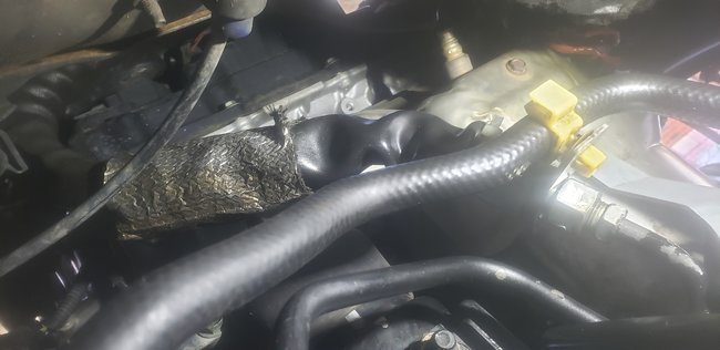

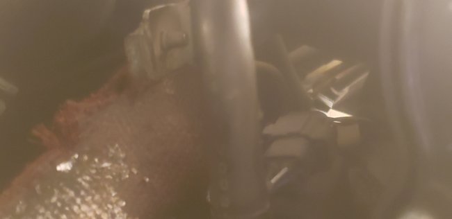

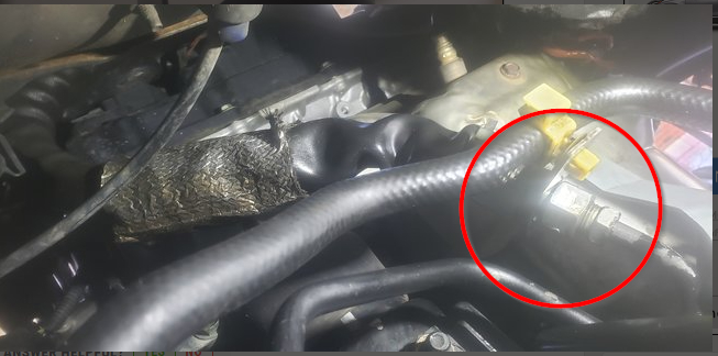

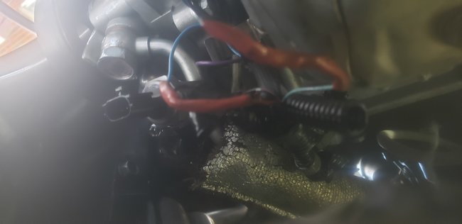

Okay. so, i got the line disconnected at both ends but up at the top behind I'm guessing is the manifold its connected to it somehow by 1 or more bolts. i have included pics that a size 11 socket fits on but there's not enough room for a ratchet and a wrench can't get to. any suggestions? blew up the 2nd pic to see the bolt the 1st is showing the approximate location.

Yep. That bolt is going to secure the line so that it doesn't move around as it is most likely the pressure line.
The only suggestion I can make is to use an electric or air powered ratchet. That way you don't need to have any excess room. Short of that, you will need a gear ratcheting box end wrench with very fine teeth so that you can use the small amount of room you do have to get it to remove it.
