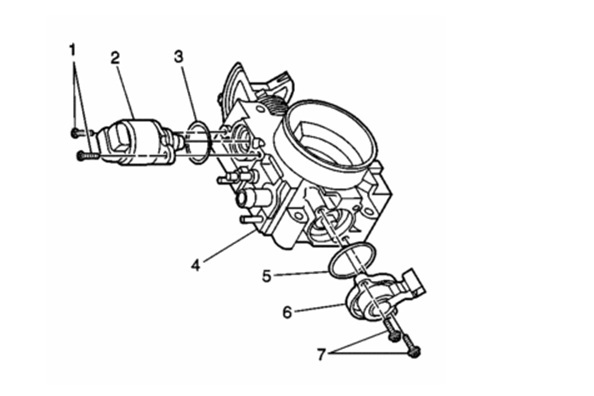

JDL
  • 16,098 POSTS
Remove the throttle-body to clean. Some of the national brand autostores used to check trouble codes for free. There should be some codes.
In the picture, #2 should be the iac.
