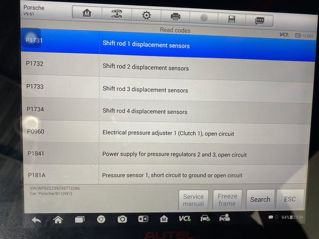

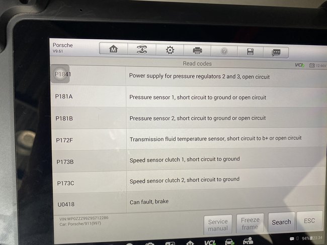

Hi Ken, actually I made the can test while right now nothing useful because I removed the transmission plug from down took it inside the car to test the voltage. so you will find a lot of faults which mean if I fix the plug back the only shift rods faults will stay.
Anyway I uploaded the pictures.

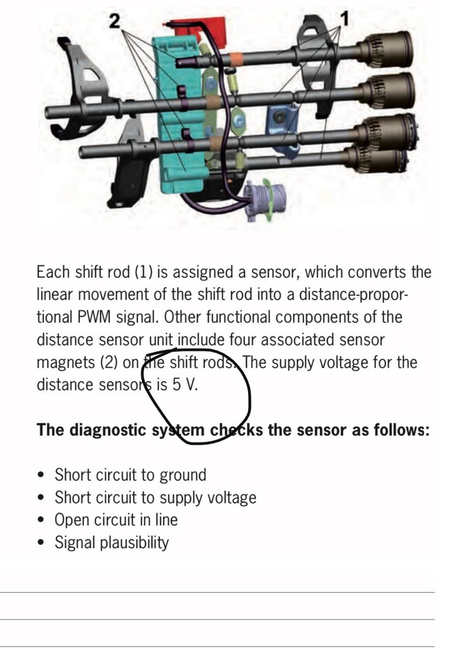

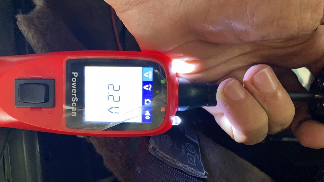

Last thing which I noticed that each shift rods should be 5v but here only 2.2v from the control unit.
I don’t know.

The voltage issue would cause it. Check the powers and grounds for the module. It sounds like there is a bad connection with high resistance.

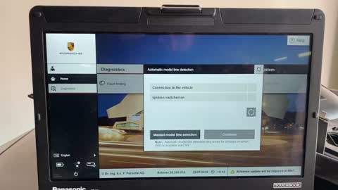

That sounds normal, have we did a CAN scan on this car? This video will help us see if the module is bad.
https://youtu.be/InIlnsjOVFA

The battery voltage sounds good. If you still have the old module you might plug it in and see if you get the 5 volt feed then. The low voltage would easily set the codes you have.

Dear Ken,
Here’s the can scan.
But you will find some errors it must not be only because I removed some wires from inside.

Dear Steve,
It’s giving the same voltage!

Okay, if both new and old modules give the same voltage when connected trace the power feeds to the module and use a heavier load like a carbon pile tester or even a bigger test light to see if the voltage drops with a load applied. Internal wire damage could show the correct voltage if on'y one strand of wire was good, but it wouldn't carry a load without dropping voltage. Bad connection could do the same.
