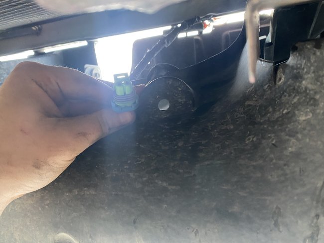

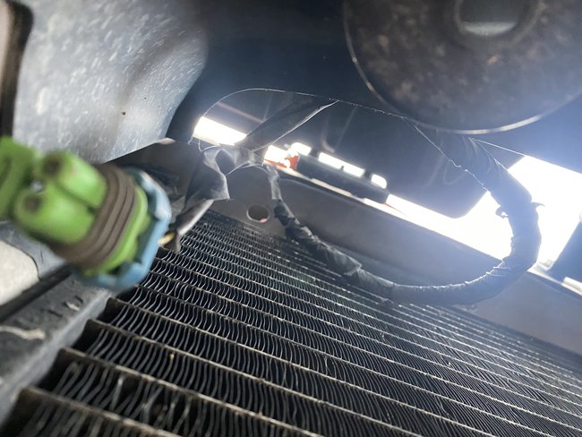

So not sure if you’d have a clue as to why this is for but was changing out some radiator hose clamps and found this connected dangling down looks like a light bulb connector, but nothing is missing a plug it’s also either wired in or tied into the same harness that runs through the front bumper that connects to the airbag sensors on the front. Only odd thing I have seen or if you know if a trailer plug could be causing these issues because I noticed my car has one hooked up.
Oct 6, 2021 at 2:05 PM
The trailer wiring certainly could be causing issues. I don't believe this vehicle came with one from the factory. So, someone must have added it.
As far as the plug in the pic, can you tell me what color the wires are going to it? Also, are there two wires?
Let me know,

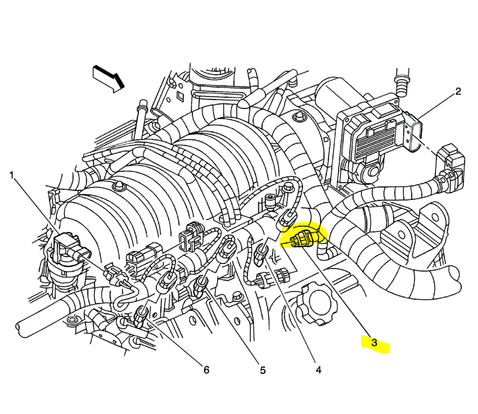

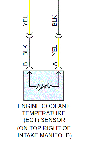

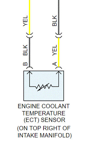

Confirm the wires are solid yellow and solid black. I looked through everything I could find and the only two-pin connector with a yellow and a black wire is the engine coolant temperature sensor. I attached two pics below. One shows the wiring to the sensor, and one shows the coolant temperature sensor location.
See if that helps.
