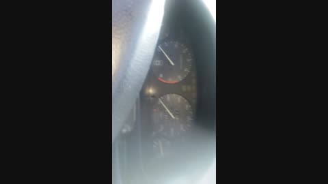

Here is a video.
Oct 7, 2018 at 5:55 PM
It looks like the gauge is having an issue, I would drive it for a while to see if the speedo starts to act normal. This can happen when the battery is disconnected and then reconnected.
Oct 8, 2018 at 10:02 AM
MIGUEL VARGAS2
  • 31 POSTS
Actually it does act normal only sometimes while I was driving though so could it be just a fuse? Sensor or a relay? :/
Oct 8, 2018 at 4:11 PM
Nope that is a gauge issue no relay or fuse will change that. You can try a used cluster.
