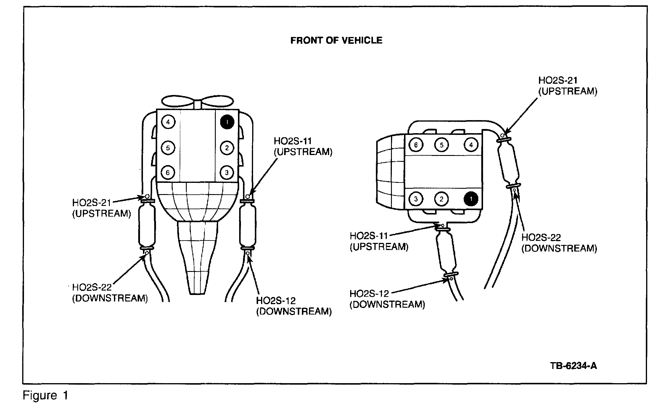

Also, does exhaust leaks affect the readings from the 02 sensors? The only exhaust leaks I know of is on the passenger side. One is at the donut gasket (upstream and near 02 sensor) the other one is covered up by the heat shield I guess. It is about two feet downstream from the other leak

Nov 30, 2018 at 8:44 PM
Okay, I got ya man. P0430 is passenger side, right?
