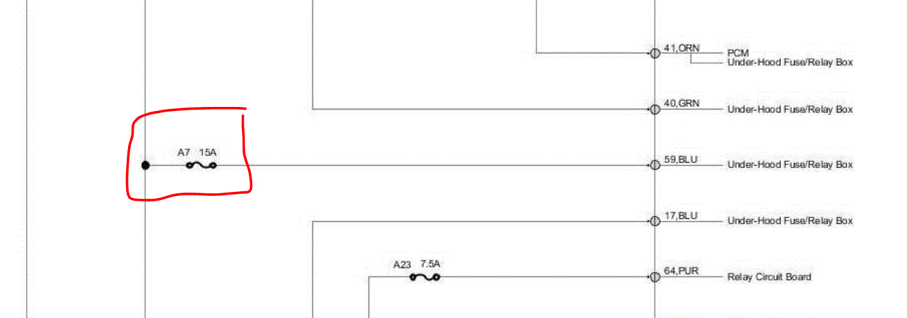

There is a fuse. It is A7 (15amp) in the underhood fuse box. For some reason, my manual doesn't have a layout of the fuses. See pic 1. That is what I have.
Now, start by checking that fuse. In addition to inspecting the fuse, confirm there is power both to it and from it. Here is a link to help:
Let's start with that. Let me know what you find or if you have other questions.

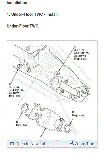

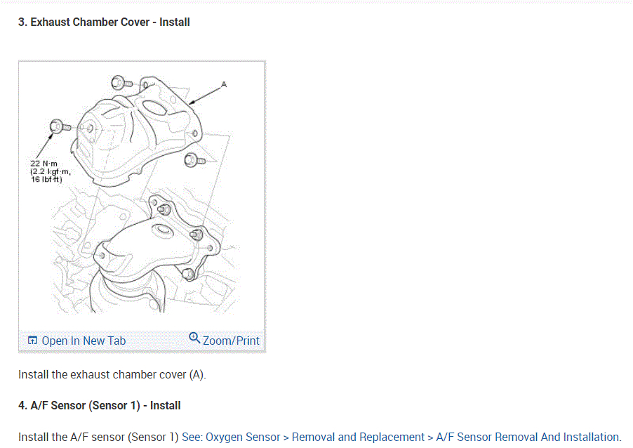

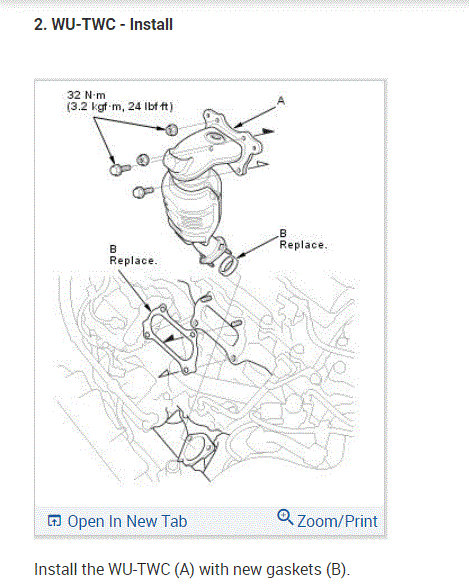

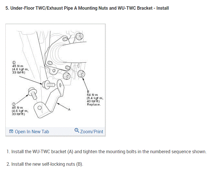

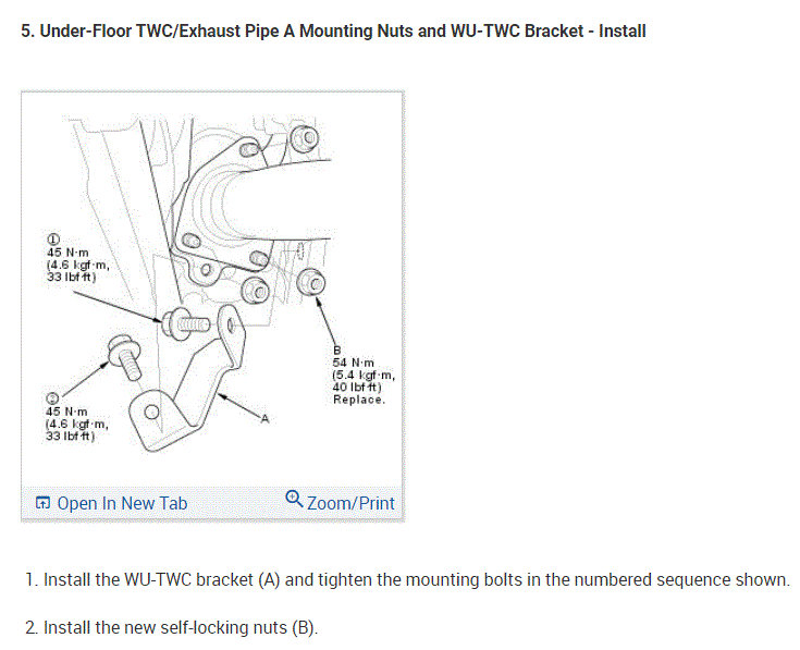

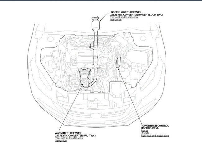

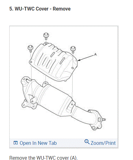

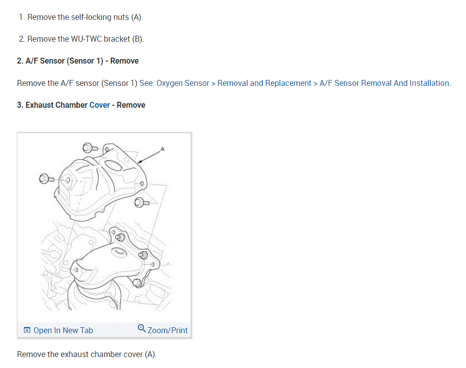

I can tell you a new "aftermarket" catalytic converter is required to meet EPA emissions standards for 25,000 miles. Have you contacted the people that installed it? I would hope they would stand behind it.
Also, the 25,000 miles is a requirement by the EPA. That isn't something that the manufacturer can change. I doubt you put 25K miles on it in a couple of months. LOL

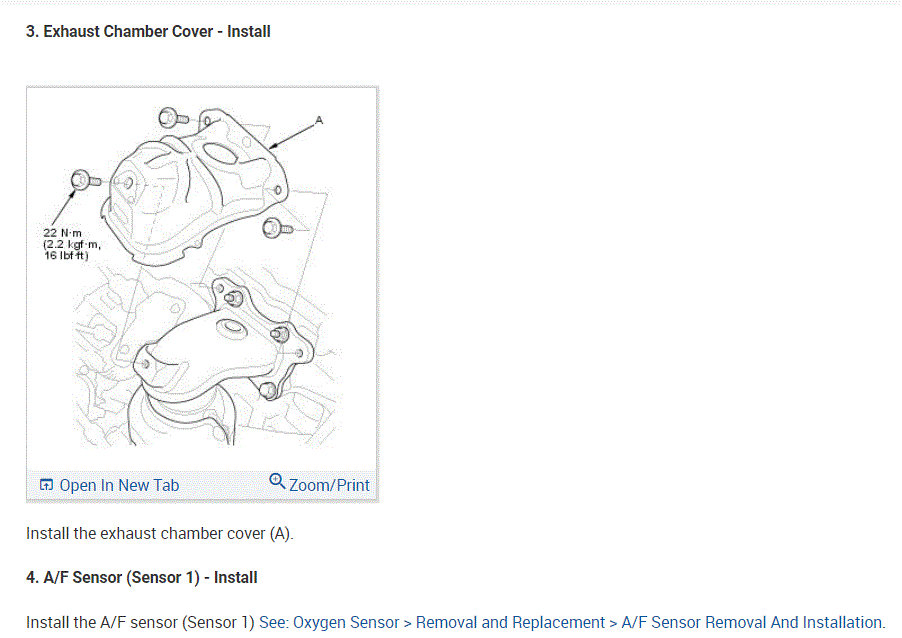

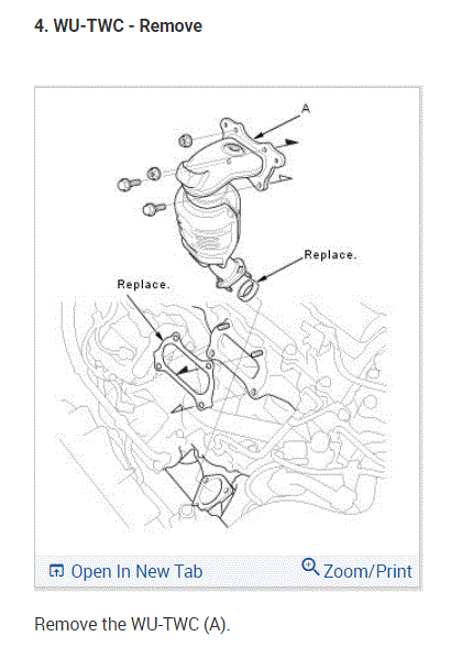

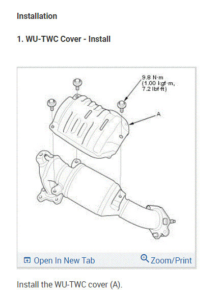

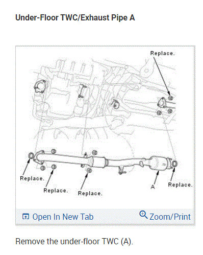

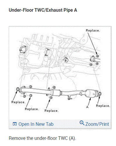

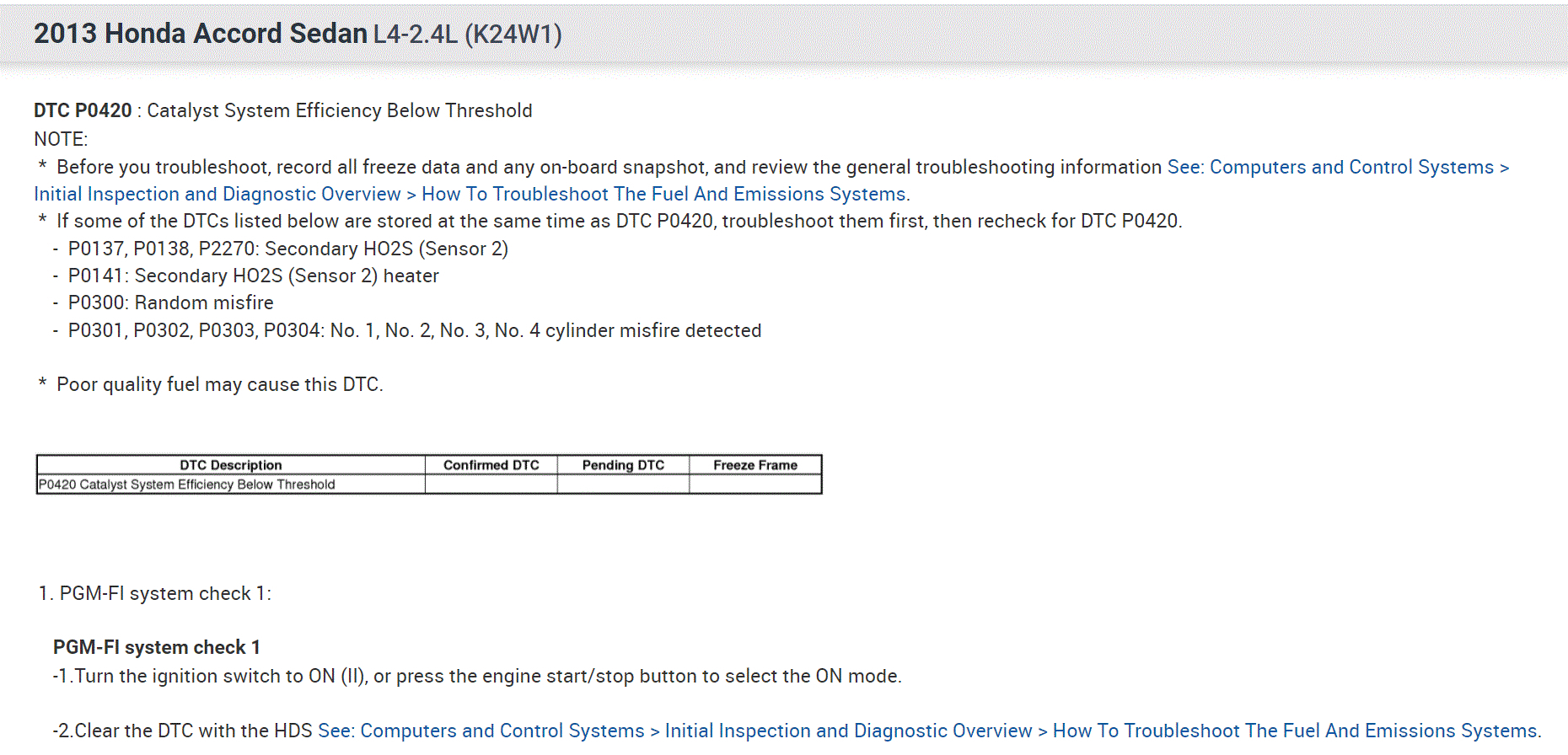

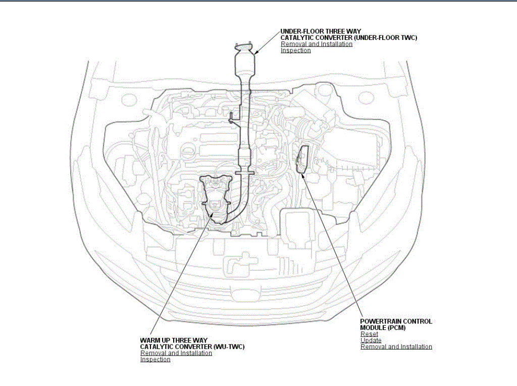

Here is the only issue I can think you may have. The vehicle has a warm-up catalytic converter in the exhaust manifold and then another converter under the vehicle. See pic 1
If the same one has failed again, we need to check a few other things. For example, high fuel pressure can cause a rich fuel mixture. That can damage a converter. Also, even an engine coolant temp sensor can cause issues because it indirectly controls the air-fuel mixture.

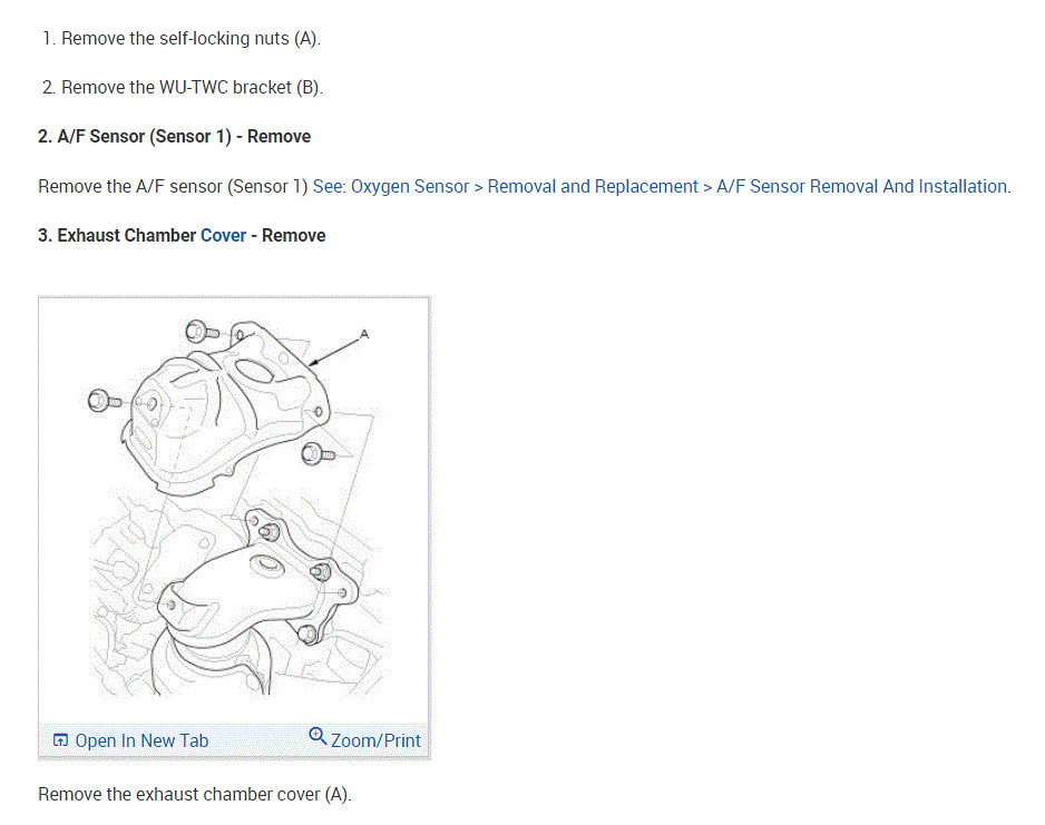

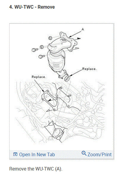

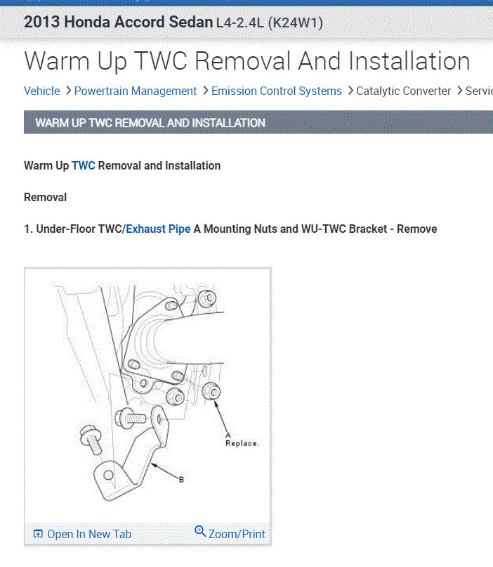

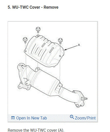

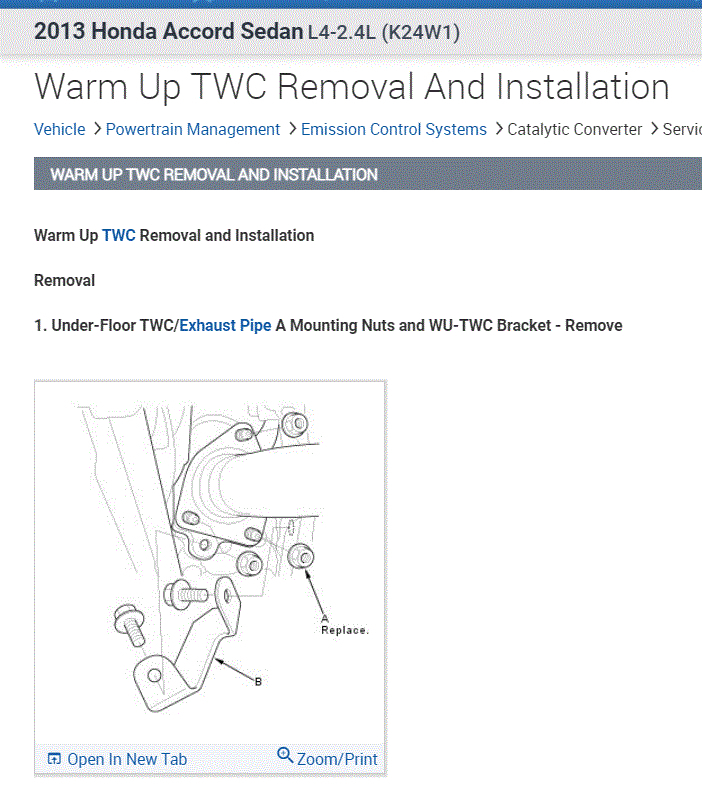

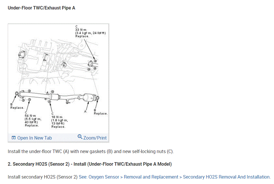

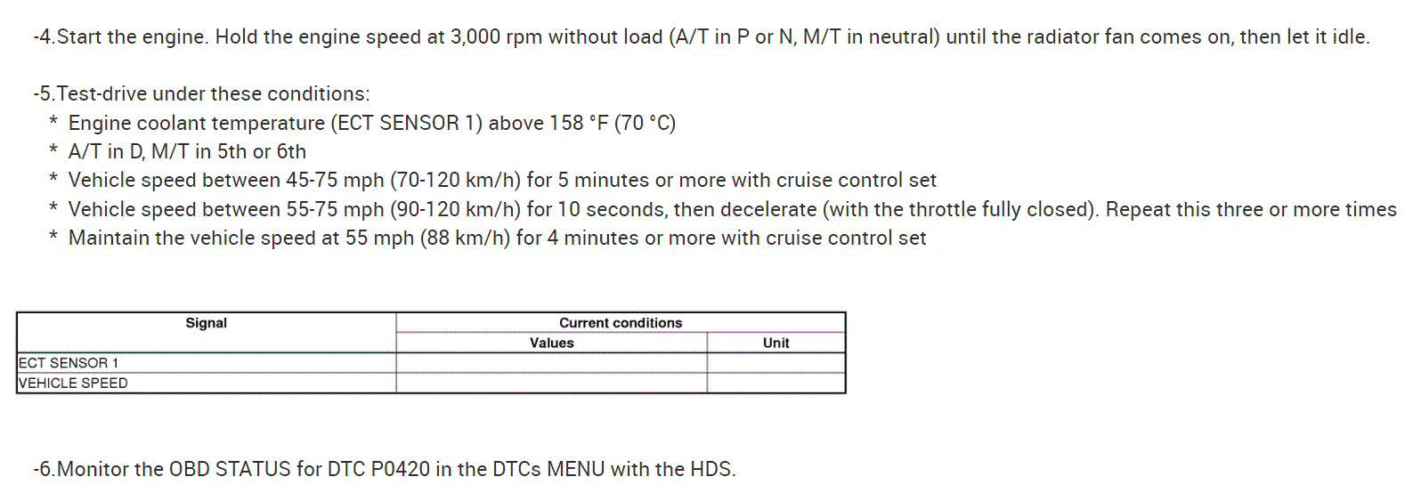

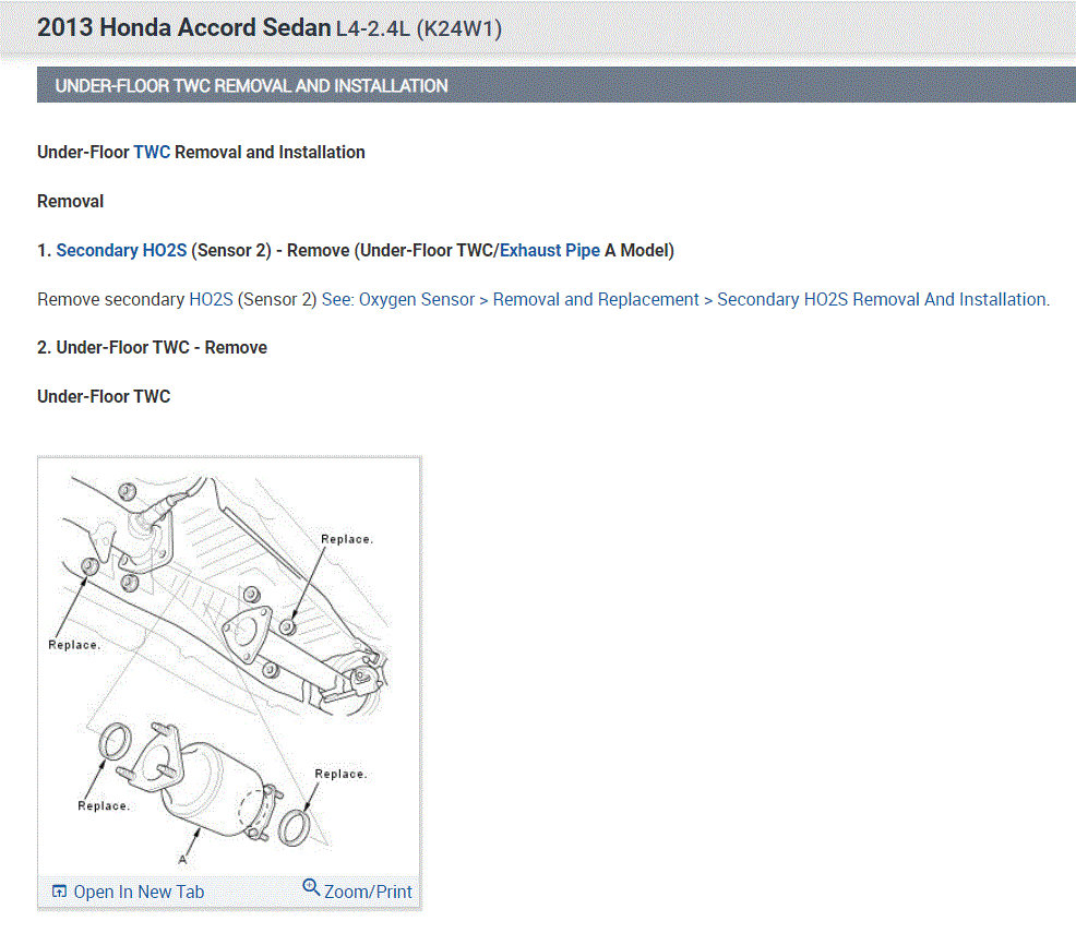

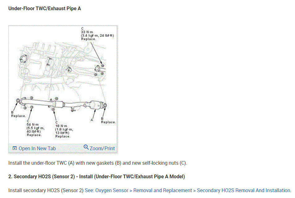

I don't know if you have any interest, but the remaining pics below are the directions for the removal and replacement of the converters. I figured I would add them in the event you want to do it yourself.
Let me know if I can help.
See pics below.

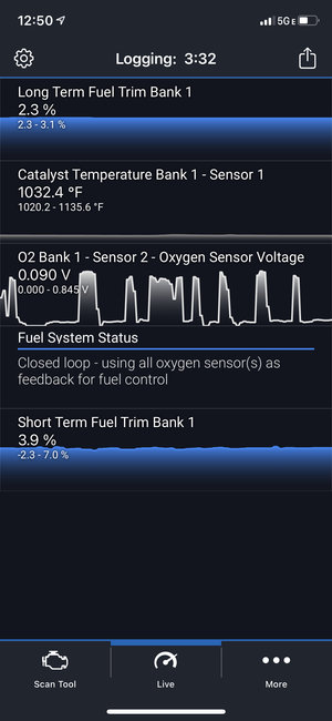

To check the fuel issues, you need a live data scan tool. Once it is plugged in and the vehicle is running, you can tell how rich or lean the engine is running based on what is called short-term and long-term fuel trims. Specifically, short-term fuel trims.
If you have a live data scan tool, let me know what the fuel trims are.
Apr 18, 2021 at 5:13 PM

Hello Joe, I took this live reading after my car was at operating temperature and drove a couple of miles.
Apr 19, 2021 at 12:54 PM
The fuel trims look okay. They can be plus or minus approximately 10%. In a perfect world, they would stay at 0%.

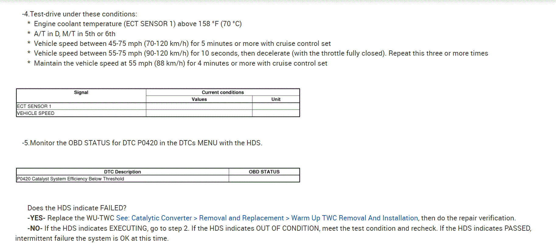

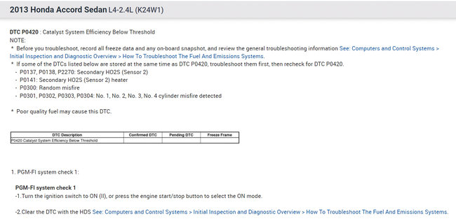

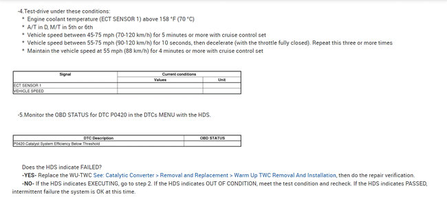

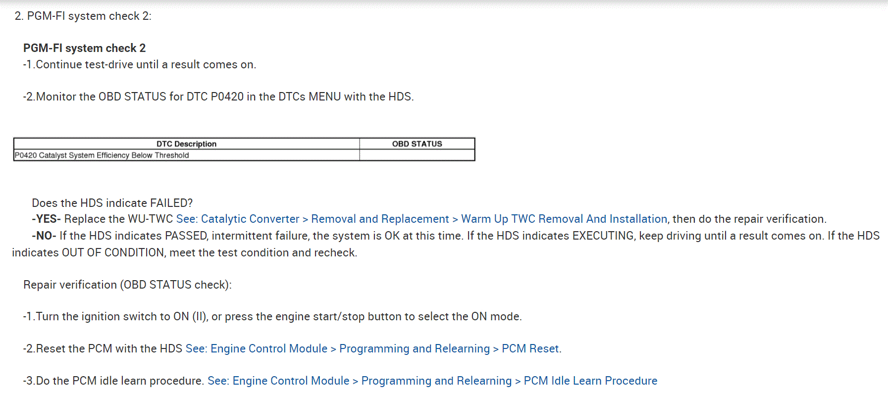

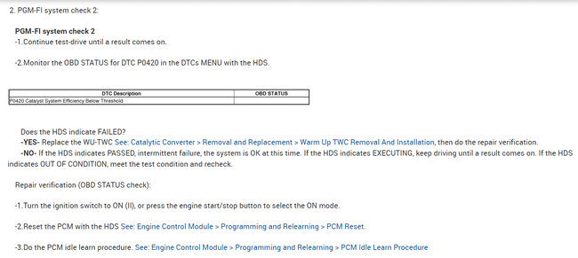

Below I attached the diagnostics for the code. Take a look through it and let me know if it is something you feel comfortable doing.
Apr 19, 2021 at 5:23 PM
