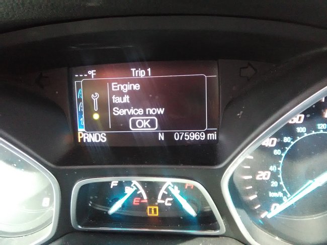

Right now I have Engine failure Service now on car and twice when I turn it on. First time it showed up twice. No codes.

I had injectors all cleaned. A bit later when I got in my car at home message came up three times and was acting rough like I pushed hard on gas in park then message actually went away. No codes when I went back up to Goodyear. They suggested dealership??

Ughh. I just wanted the inside of my injectors cleaned like you suggested and they said they would be. Should I be worried about the engine failure messages yesterday with no codes?
Jun 3, 2019 at 1:02 PM
I would not ignore it. It is not efficient the way it is.
