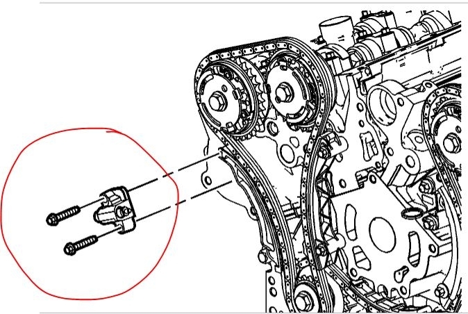

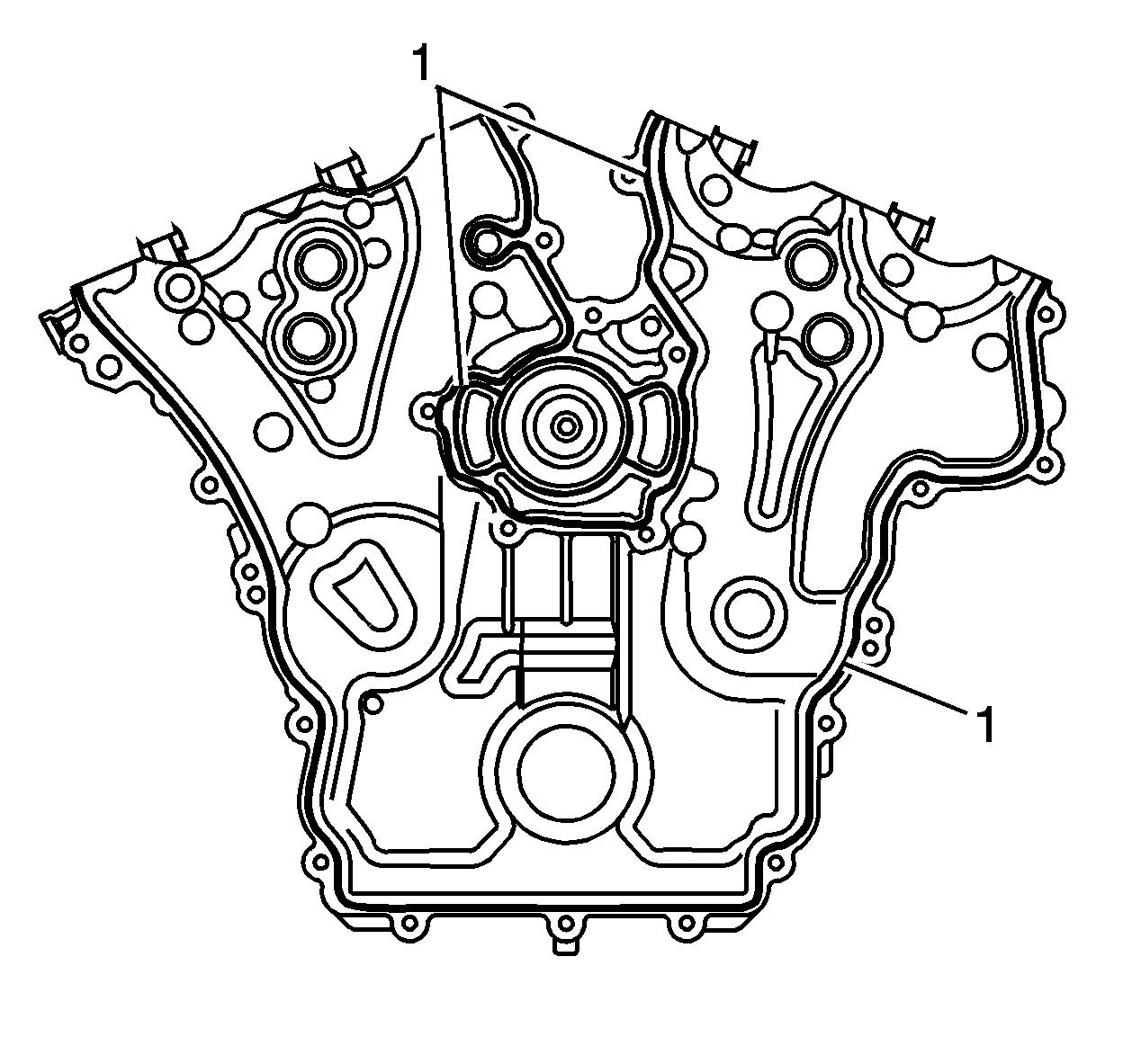

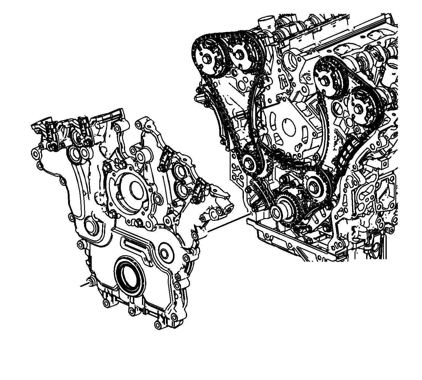

Here are the directions for the left cam chain. The attached pictures correlate with the directions.

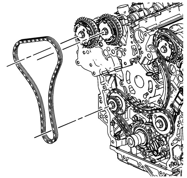

13. Remove the left bank camshaft intermediate drive chain idler. See: Engine > Overhaul > 29. Camshaft Intermediate Drive Chain Idler Removal - Left Side

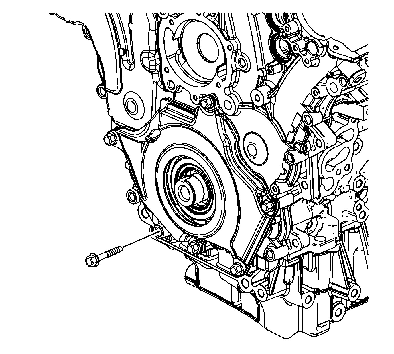

pic 1
14. Remove the left bank secondary camshaft drive chain. See: Engine > Overhaul > 28. Secondary Camshaft Drive Chain Removal - Left Side
15. Clean and inspect all of the camshaft timing drive components. Replace components as necessary. See: Engine > Overhaul > 67. Camshaft Timing Chain and Sprocket Cleaning and Inspection

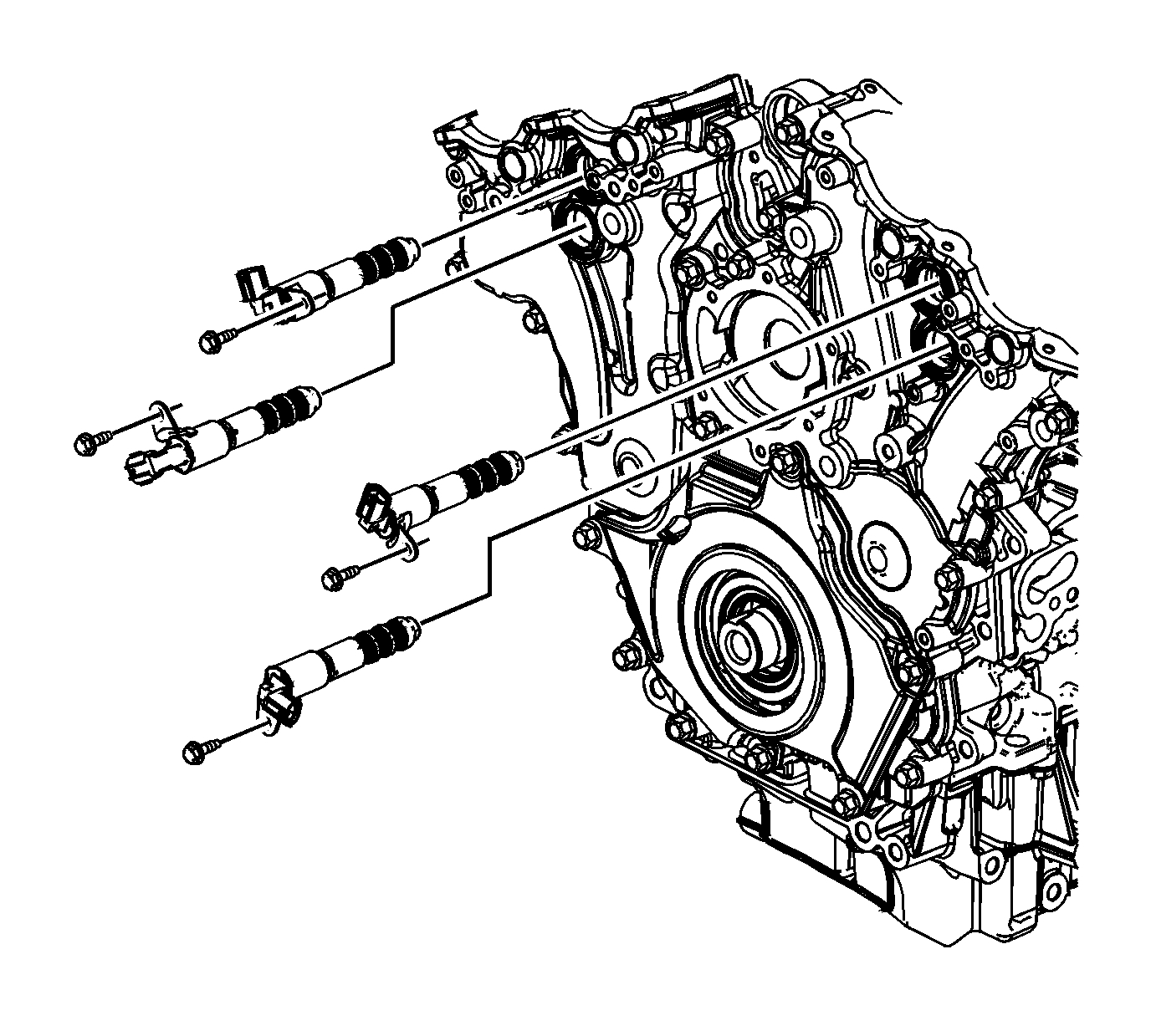

Installation Procedure

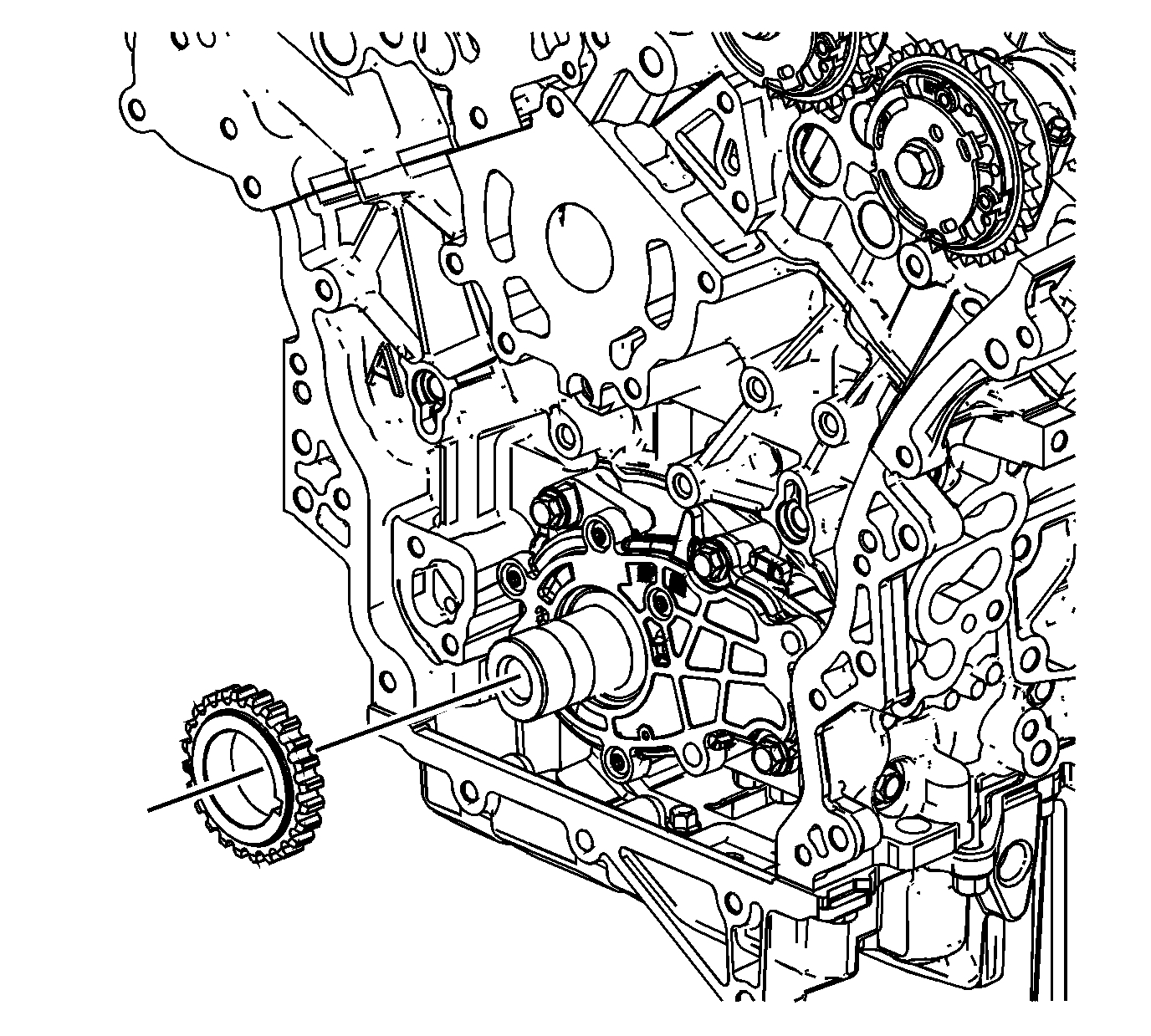

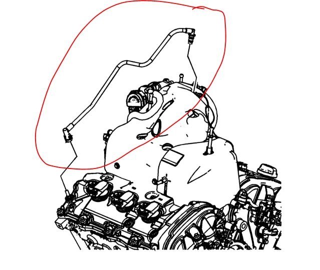

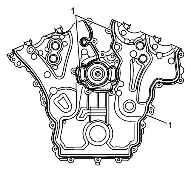

pic 2
1. Install the left bank secondary camshaft drive chain. See: Engine > Overhaul > 113. Secondary Camshaft Drive Chain Installation - Left Side

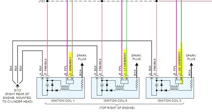

Welcome back:

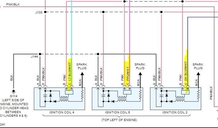

I totally understand. I wouldn't want to pull it out either. You know, if the coils are wired wrong, that would make more sense than the timing since nothing was touched.

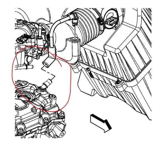

I attached two pictures below. One is bank 1 and the other bank 2. What you will have to do is one at a time, check that the correct wiring is going to each coil. I highlighted the wires that will be different and specific to each cylinder.
Check that and let me know.
Oct 22, 2019 at 8:32 PM

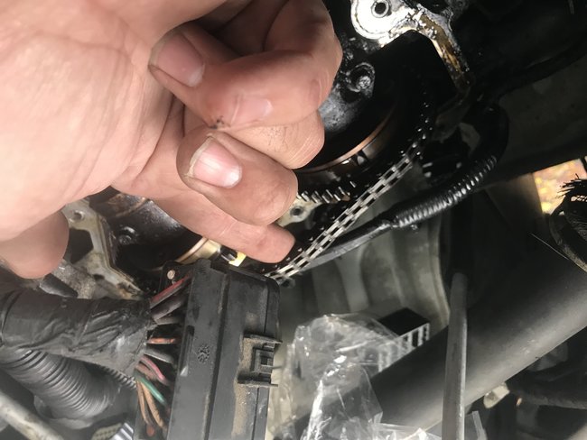

Thanks Joe. I had a friend come look at it with me tonight. He found that there is extreme air pressure blowing out of the hose that hooks back into my air intake. Vapor return line, I sure what to call it. He, without knowing your response, thought it was a cracked piston or more likely a timing chain issue. He also suggested first step, check compression, second step timing belt. So I’m going to start easiest and work up. First I’ll check wiring of coils, then check compression, lastly will attempt the timing belt change.
Do you know if it can be done in vehicle? I assume so and some videos show it can be but it’s very difficult.

The chain can be done in vehicle. It's tight, but if you get things out of the way, it can work. I have no idea why you are getting a lot of pressure. Usually blow-by is caused by excessive ring / cylinder wear. I suspect you are referring to the PCV. See pictures below.
After you check things out, if you decide you are replacing the chains, let me know. Setting the VVT is a bit tricky. I attached a picture below. You'll see there are three chains. If you need directions, let me know if you need them all or just a specific one.

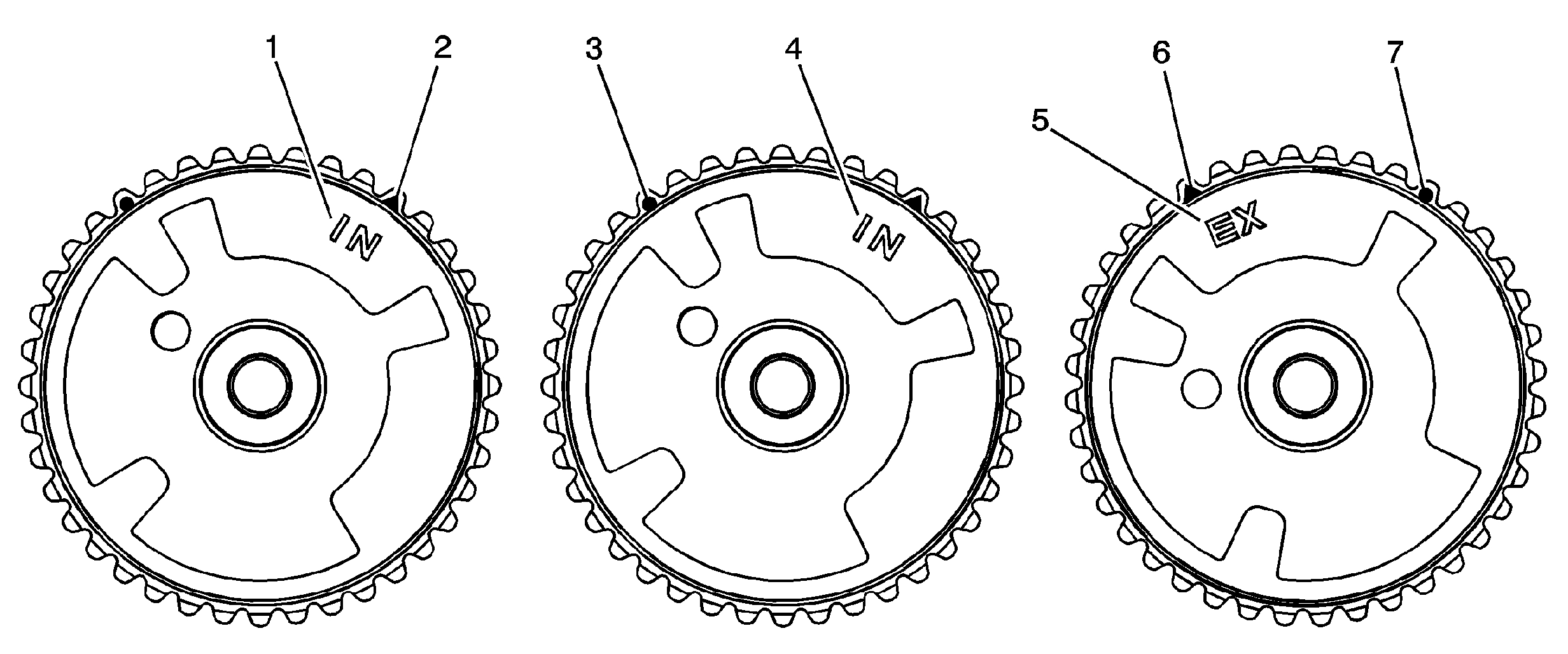

To check timing before you remove the chains, you will have to see if all the marks align, which may require several crankshaft rotations to happen. I am going to provide the directions for replacing the primary and secondary chains. Just fyi, this isn't going to be the easiest thing you have ever done. In fact, it can be frustrating.

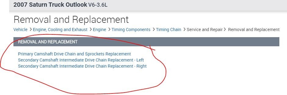

Here are the directions. I will break them down this way: Primary, Secondary Left, and Secondary Right. All attached pictures will correlate with the directions. Note: The secondary left must be installed before the right side.

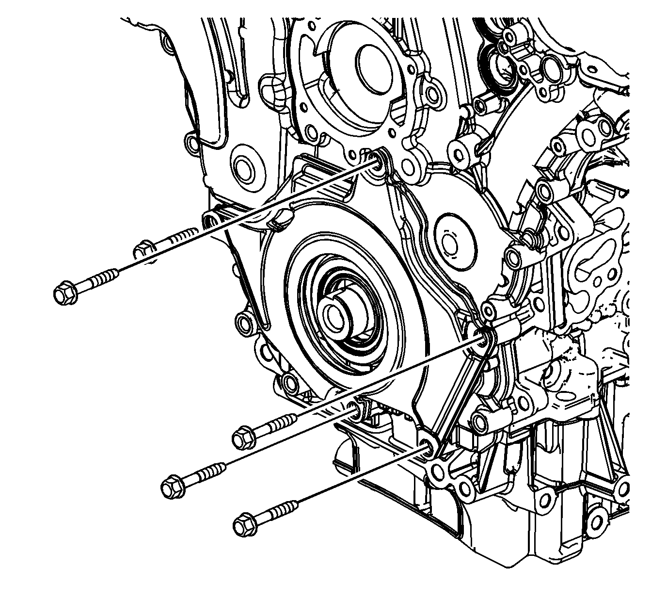

1. Remove the engine front cover. See: Timing Cover > Removal and Replacement > Engine Front Cover Replacement

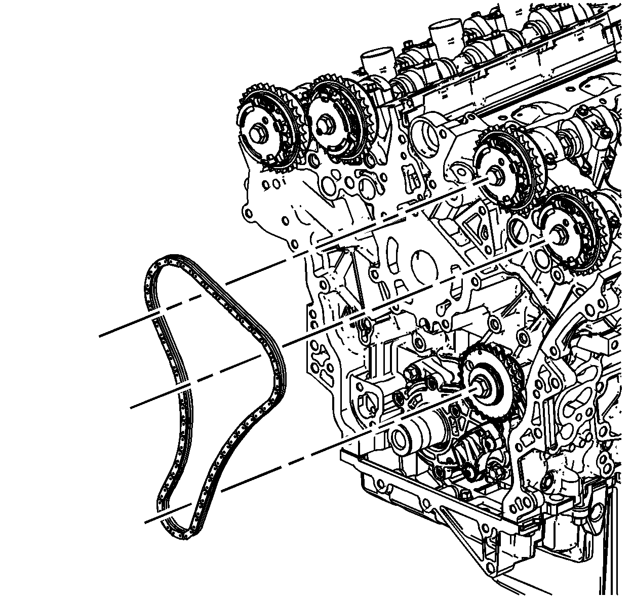

9. Remove the primary camshaft timing chain. See: Engine > Overhaul > 23. Primary Camshaft Drive Chain Removal
pic 2
10. Remove the crankshaft sprocket from the nose of the crankshaft.

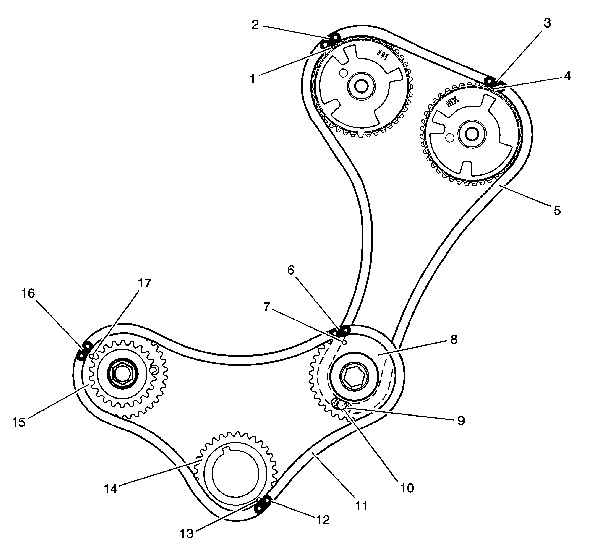

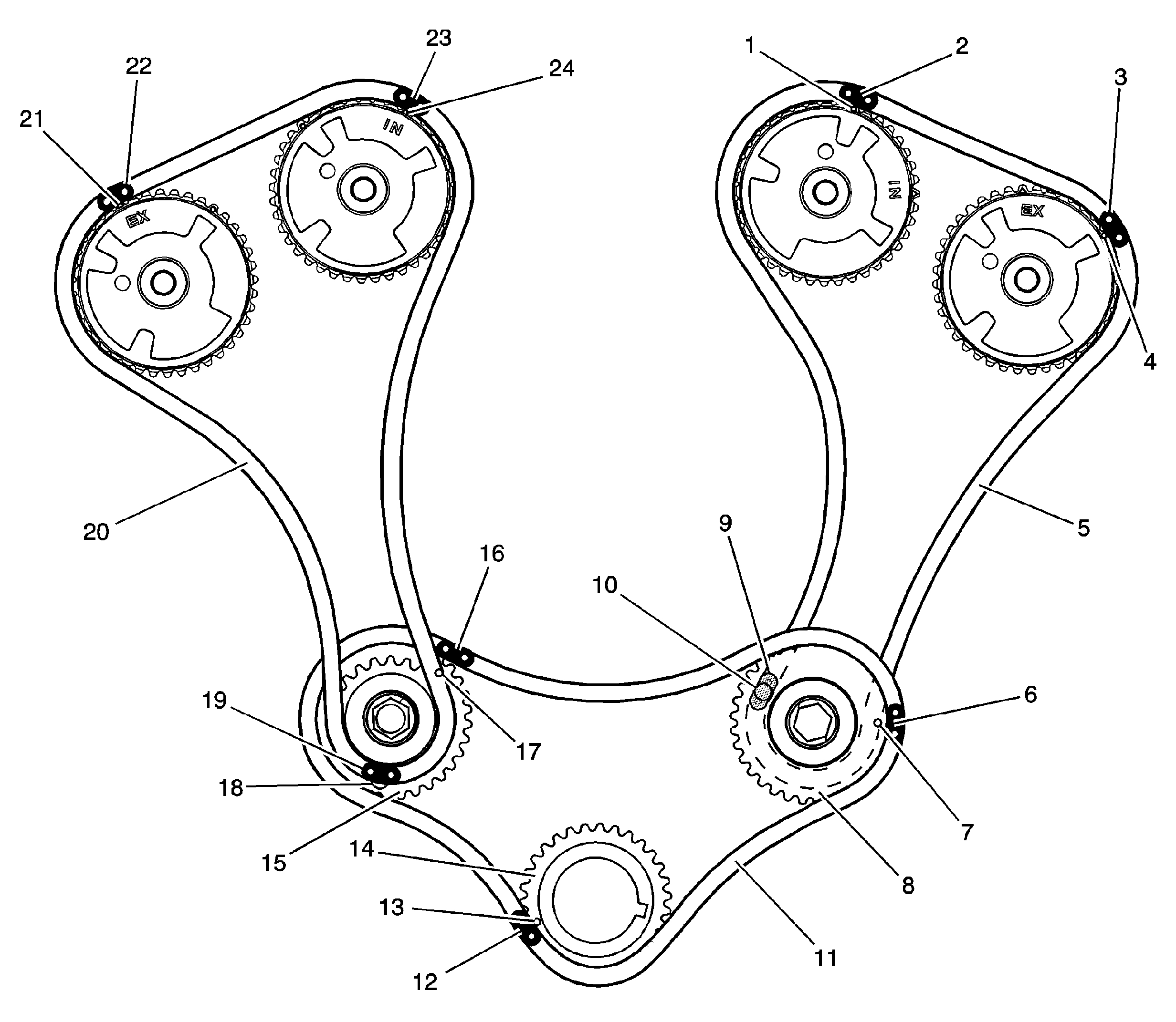

1. Ensure the secondary timing chain is in the stage 1 timing position. See: Timing Component Alignment Marks > Components

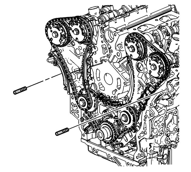

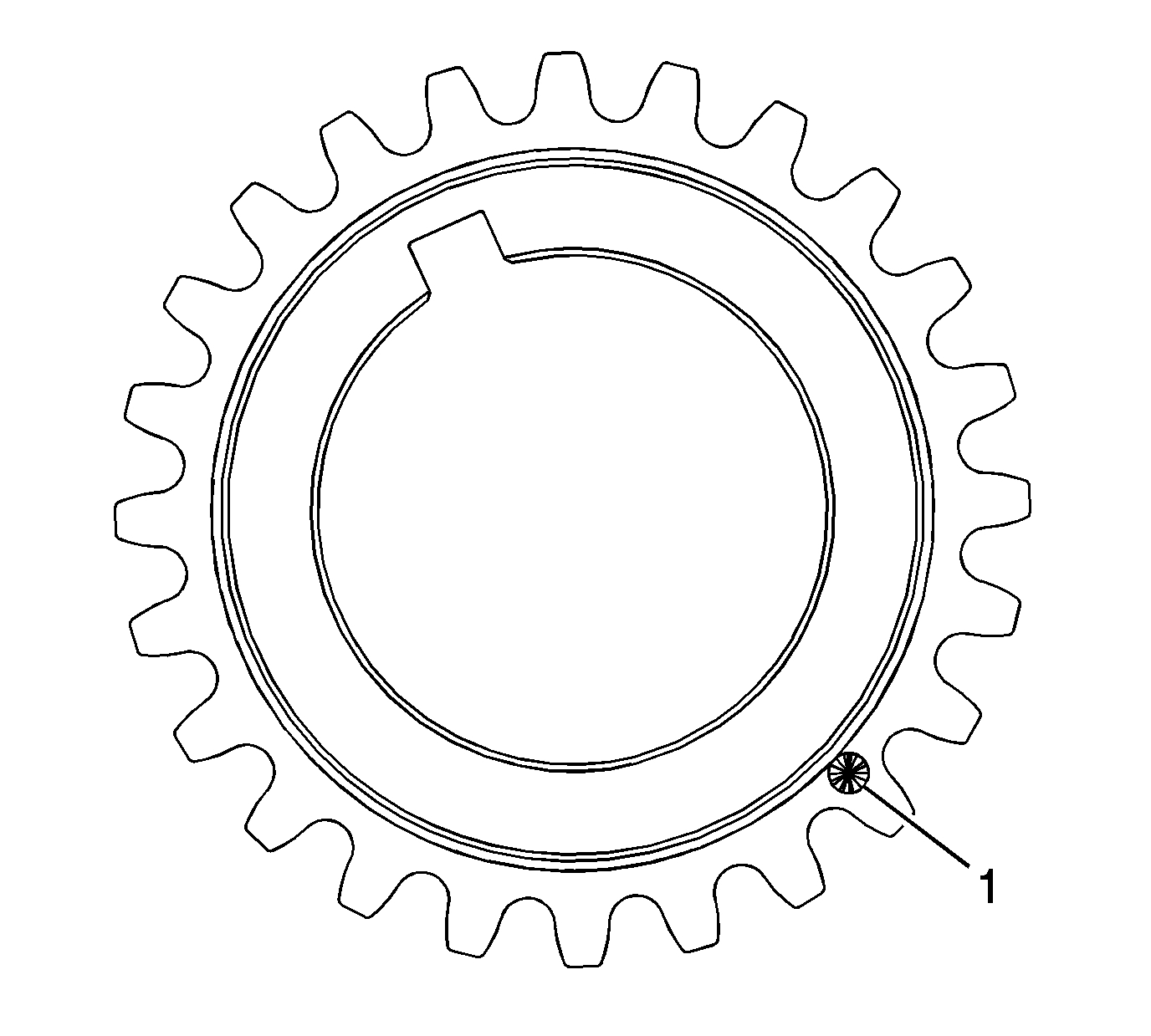

pic 3

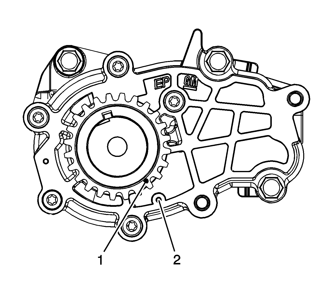

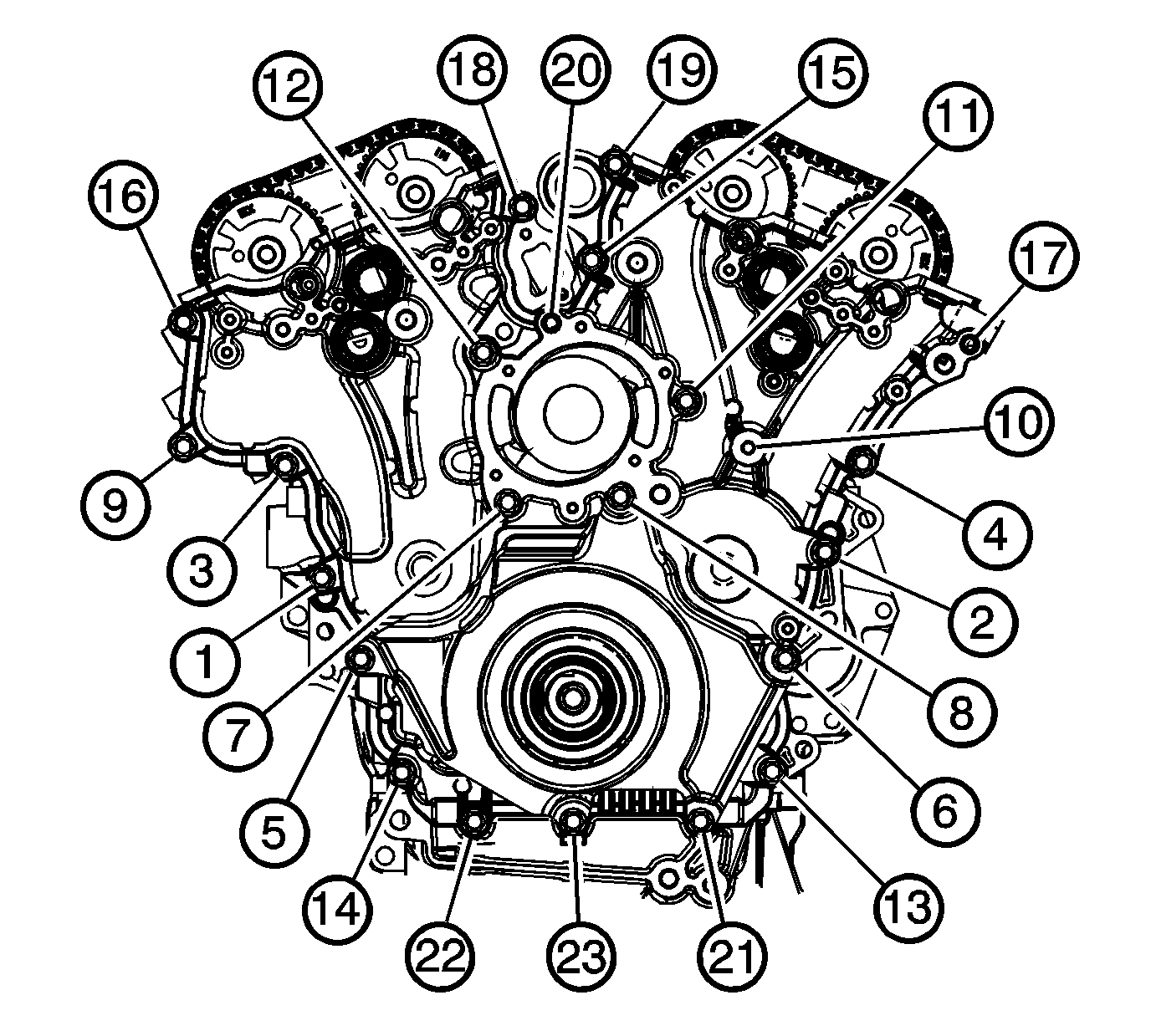

2. Ensure the crankshaft sprocket is installed with the timing mark (1) visible.

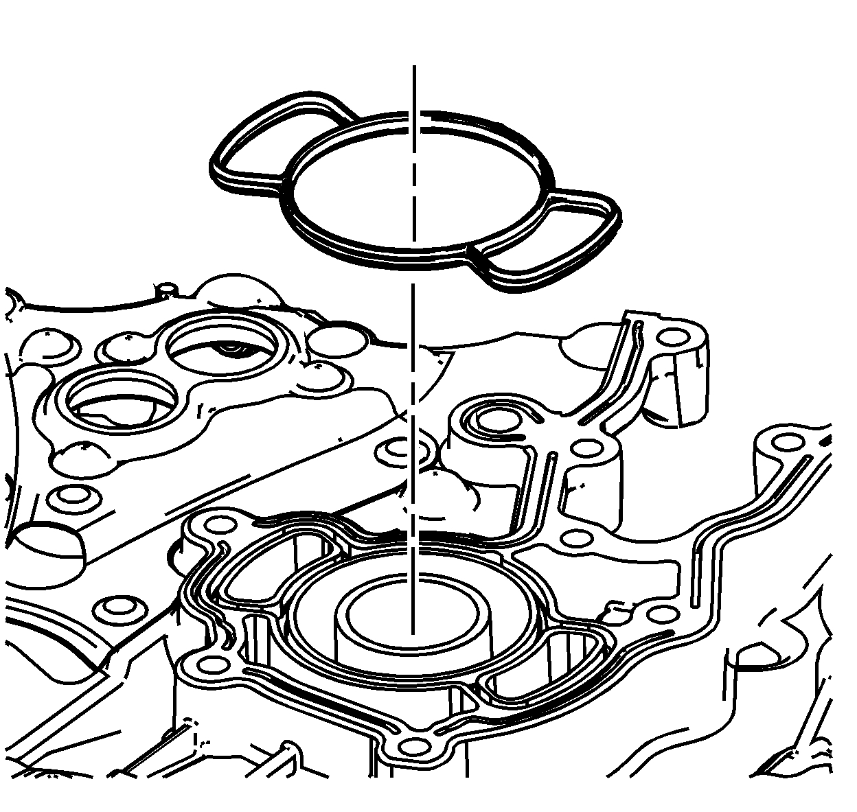

pic 4
3. Install the crankshaft sprocket on to the nose of the crankshaft.

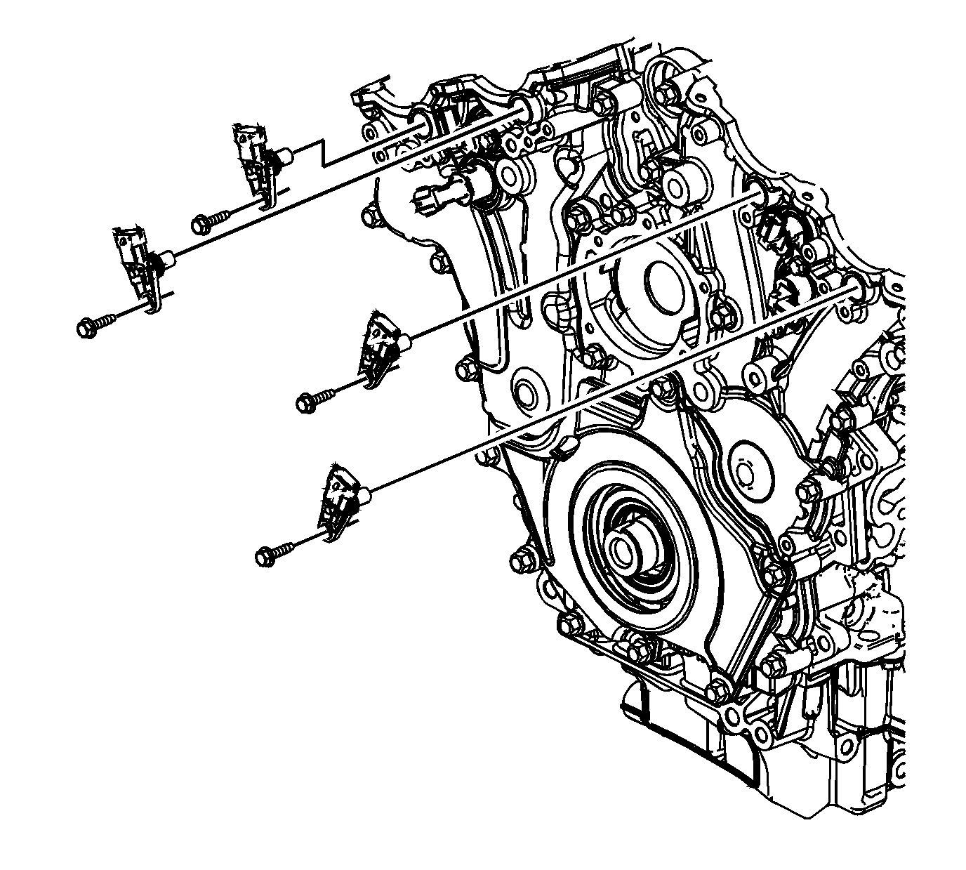

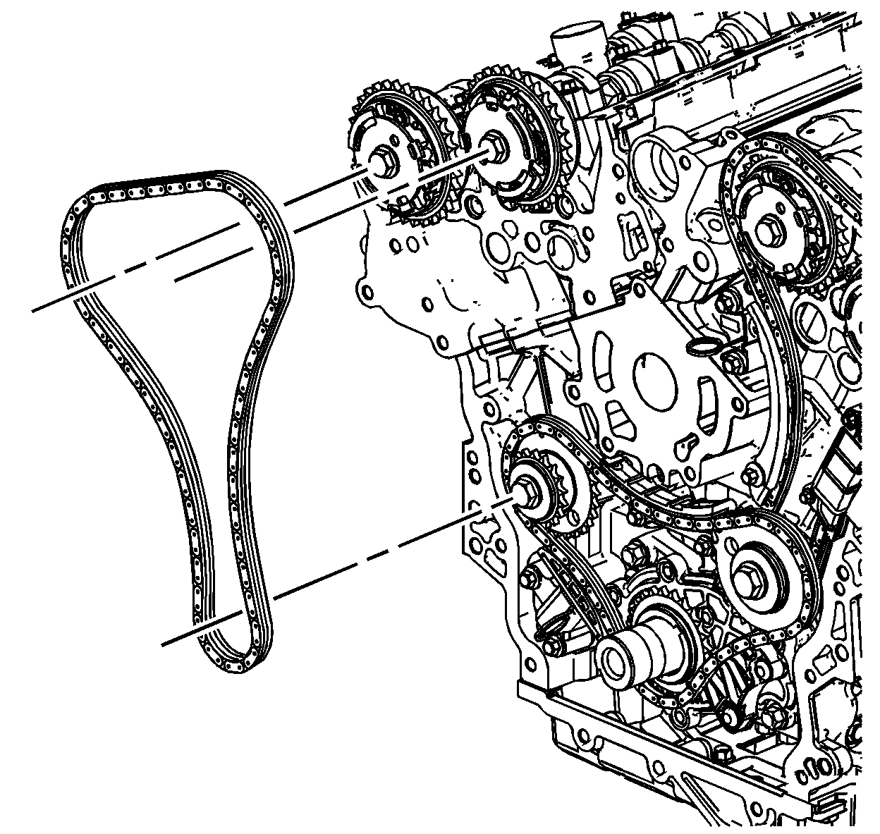

5. Slide the crankshaft sprocket on the crankshaft nose until the crankshaft sprocket contacts the step in the crankshaft.
pic 5

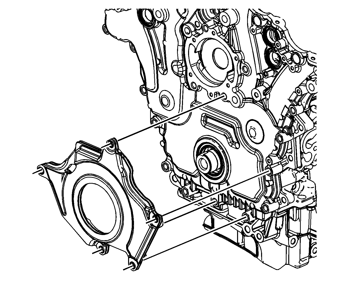

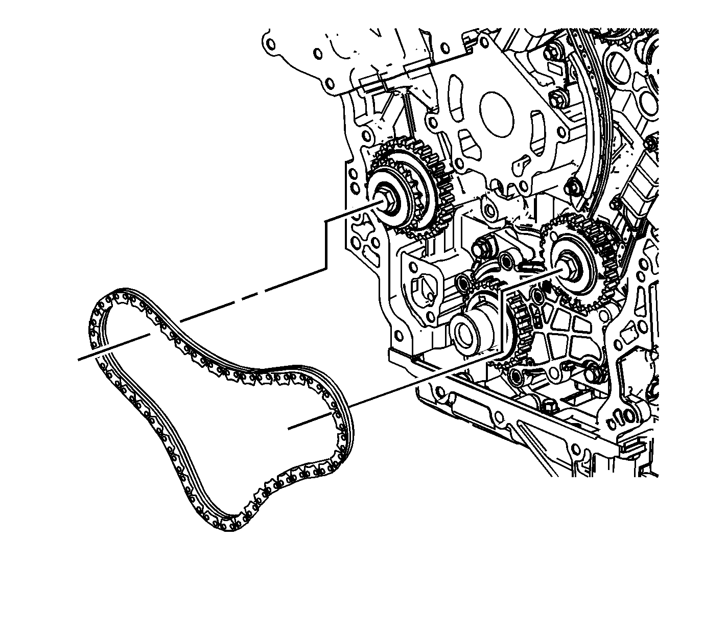

6. Ensure the crankshaft is in the stage one timing position with the crankshaft sprocket timing mark (1) aligned to the stage one timing mark on the oil pump cover (2) using the EN 46111. See: Timing Component Alignment Marks > Components
pic 6
7. Install the primary camshaft timing chain. See: Engine > Overhaul > 114. Primary Camshaft Drive Chain Installation

15. Install the engine front cover. See: Timing Cover > Removal and Replacement > Engine Front Cover Replacement

12. Remove the left bank secondary camshaft drive chain guide. See: Engine > Overhaul > 27. Secondary Camshaft Drive Chain Guide Removal - Left Side
pic 7
15. Clean and inspect all of the camshaft timing drive components. Replace components as necessary. See: Engine > Overhaul > 64. Camshaft Timing Drive Components Cleaning and Inspection
pic 8
1. Install the left bank secondary camshaft drive chain. See: Engine > Overhaul > 109. Secondary Camshaft Drive Chain Installation - Left Side
2. Install the left bank camshaft intermediate drive chain idler. See: Engine > Overhaul > 108. Camshaft Intermediate Drive Chain Idler Installation - Left Side
3. Install the left bank secondary camshaft drive chain guide. See: Engine > Overhaul > 110. Secondary Camshaft Drive Chain Guide Installation - Left Side
4. Install the left bank secondary camshaft drive chain shoe. See: Engine > Overhaul > 111. Secondary Camshaft Drive Chain Shoe Installation - Left Side
5. Install the left bank secondary camshaft drive chain tensioner. See: Engine > Overhaul > 112. Secondary Camshaft Drive Chain Tensioner Installation - Left Side
6. Install the right bank camshaft intermediate drive chain idler. See: Engine > Overhaul > 113. Camshaft Intermediate Drive Chain Idler Installation - Right Side
7. Install the primary camshaft drive chain. See: Engine > Overhaul > 114. Primary Camshaft Drive Chain Installation
8. Install the primary upper camshaft drive chain guide. See: Engine > Overhaul > 116. Primary Camshaft Drive Chain Guide Installation - Upper
9. Install the primary camshaft drive chain tensioner. See: Engine > Overhaul > 117. Primary Camshaft Drive Chain Tensioner Installation
10. Install the right bank secondary camshaft drive chain. See: Engine > Overhaul > 118. Secondary Camshaft Drive Chain Installation - Right Side
11. Install the right bank secondary camshaft drive chain guide. See: Engine > Overhaul > 119. Secondary Camshaft Drive Chain Guide Installation - Right Side
12. Install the right bank secondary camshaft drive chain shoe. See: Engine > Overhaul > 120. Secondary Camshaft Drive Chain Shoe Installation - Right Side
13. Install the right bank secondary camshaft drive chain tensioner. See: Engine > Overhaul > 121. Secondary Camshaft Drive Chain Tensioner Installation - Right Side
14. Install the engine front cover. See: Timing Cover > Removal and Replacement > Engine Front Cover Replacement
____________________________________________
Secondary Right
2007 Saturn Truck Outlook V6-3.6L
Secondary Camshaft Intermediate Drive Chain Replacement - Right
Vehicle Engine, Cooling and Exhaust Engine Timing Components Timing Chain Service and Repair Removal and Replacement Secondary Camshaft Intermediate Drive Chain Replacement - Right
SECONDARY CAMSHAFT INTERMEDIATE DRIVE CHAIN REPLACEMENT - RIGHT
SECONDARY CAMSHAFT INTERMEDIATE DRIVE CHAIN REPLACEMENT - RIGHT SIDE
Removal Procedure
2. Remove the spark plugs in order to ease crankshaft/engine rotation. See: Spark Plug > Removal and Replacement
3. Remove the right bank secondary camshaft drive chain tensioner. See: Engine > Overhaul > 16. Secondary Camshaft Drive Chain Tensioner Removal - Right Side
4. Remove the right bank secondary camshaft drive chain shoe. See: Engine > Overhaul > 17. Secondary Camshaft Drive Chain Shoe Removal - Right Side
5. Remove the right bank secondary camshaft drive chain guide. See: Engine > Overhaul > 18. Secondary Camshaft Drive Chain Guide Removal - Right Side
pic 9
6. Remove the right bank secondary camshaft drive chain. See: Engine > Overhaul > 19. Secondary Camshaft Drive Chain Removal - Right Side
1. Ensure the stage 1 camshaft timing is correct. See: Timing Component Alignment Marks > Components
pic 10
2. Install the right bank secondary camshaft drive chain. See: Engine > Overhaul > 118. Secondary Camshaft Drive Chain Installation - Right Side
3. Install the right bank secondary camshaft drive chain guide. See: Engine > Overhaul > 119. Secondary Camshaft Drive Chain Guide Installation - Right Side
4. Install the right bank secondary camshaft drive chain shoe. See: Engine > Overhaul > 120. Secondary Camshaft Drive Chain Shoe Installation - Right Side
5. Install the right bank secondary camshaft drive chain tensioner. See: Engine > Overhaul > 121. Secondary Camshaft Drive Chain Tensioner Installation - Right Side
6. Install the spark plugs. See: Spark Plug > Removal and Replacement
7. Install the engine front cover. See: Timing Cover > Removal and Replacement > Engine Front Cover Replacement

Here is timing mark information.
STAGE ONE
pic 11
1. Left Intake Camshaft Position Actuator Timing Mark - Circle
2. Left Intake Secondary Camshaft Timing Drive Chain Timing Link
3. Left Exhaust Secondary Camshaft Timing Drive Chain Timing Link
4. Left Exhaust Camshaft Position Actuator Timing Mark - Circle
5. Left Secondary Camshaft Timing Drive Chain
6. Primary Camshaft Drive Chain Timing Link for the Left Primary Camshaft Intermediate Drive Chain Sprocket
7. Left Primary Camshaft Intermediate Drive Chain Sprocket Timing Mark for the Primary Camshaft Drive Chain
8. Left Primary Camshaft Intermediate Drive Chain Sprocket
9. Left Secondary Camshaft Timing Drive Chain Timing Link for the Left Primary Camshaft Intermediate Drive Chain Sprocket, behind hole in sprocket
10. Left Primary Camshaft Intermediate Drive Chain Sprocket Timing Window for the Left Secondary Camshaft Timing Drive Chain Timing Link
11. Primary Camshaft Drive Chain
12. Primary Camshaft Drive Chain Timing Link for the Crankshaft Sprocket
13. Crankshaft Sprocket Timing Mark
14. Crankshaft Sprocket
15. Right Primary Camshaft Intermediate Drive Chain Sprocket
16. Primary Camshaft Drive Chain Timing Link for the Right Primary Camshaft Intermediate Drive Chain Sprocket
17. Right Primary Camshaft Intermediate Drive Chain Sprocket Timing Mark
_______________________________________________
Pic 12
17. Right Primary Camshaft Intermediate Drive Chain Sprocket Timing Mark for the Primary Camshaft Drive Chain
18. Right Primary Camshaft Intermediate Drive Chain Sprocket Timing Mark/Window for the Right Secondary Camshaft Timing Drive Chain
19. Right Secondary Camshaft Timing Drive Chain Timing Link for the Right Primary Camshaft Intermediate Drive Chain Sprocket
20. Right Secondary Camshaft Timing Drive Chain
21. Right Exhaust Camshaft Position Actuator Timing Mark - Triangle
22. Right Exhaust Secondary Camshaft Timing Drive Chain Timing Link
23. Right Intake Secondary Camshaft Timing Drive Chain Timing Link
24. Right Intake Camshaft Position Actuator Timing Mark - Triangle
__________________________________________________________________
Camshaft Position Actuator Timing Marks
CAMSHAFT POSITION ACTUATOR TIMING MARKS
pic 13
1. Right Intake Camshaft Position Actuator Identifier
2. Right Intake Camshaft Position Actuator Right Side Timing Mark - Triangle
3. Left Intake Camshaft Position Actuator Left Side Timing Mark - Circle
4. Left Intake Camshaft Position Actuator Identifier
5. Exhaust Camshaft Position Actuator Identifier
6. Exhaust Camshaft Position Actuator Right Side Timing Mark - Triangle
7. Exhaust Camshaft Position Actuator Left Side Timing Mark - Circle

So I got the valve covers off and the left bank timing chain is visibly loose (see picture and video attempted attachments). The interesting part from my OP is when I replaced the valve cover gaskets last month I made note of the timing chains both being nice and tight with no apparent issues from the top. I’m curious how after that repair on seemingly the first crank it could go so south. Is there something I should be worried I damaged in the first repair? Anything I should keep my eye out for as I get the timing cover off?
Nov 3, 2019 at 11:00 AM
Welcome back:
That is extremely loose. Wow! I can honestly say that I can't think of anything you would have done by removing the valve cover. The cover you replaced has nothing directly associated with the chain.
The tensioner is hydraulically actuated. If there is an oil pressure issue, I guess it could have failed, but unlikely.
I attached a picture of the tensioner shoe and tensioner. It's well below where you would have been working. I can't see what you could have done to cause this.
Let me know if I can help.

Here are the specifics for replacing the cover:
122. Engine Front Cover Installation
Vehicle Engine, Cooling and Exhaust Engine Service and Repair Overhaul Unit Repair 07 Outlook 3.6L Repair Instructions 122. Engine Front Cover Installation
122. ENGINE FRONT COVER INSTALLATION
Tools Required
EN 46109 Guide Pins
pic 1
1. Install the 8 mm (0.315 in) guide from the EN 46109 into the cylinder block positions as shown.
pic 2
2. Install the NEW engine front cover to cylinder block seal.
pic 3
3. Place a 3 mm (0.118 in) bead of RTV sealant, GM P/N 12378521 (Canadian P/N 88901148) or equivalent, on the engine front cover as shown (1).
pic 4
4. Place the engine front cover onto the EN 46109 and slide into position.
5. Remove the EN 46109 from the cylinder block.
pic 5
6. Install the engine front cover deadener.
pic 6
Notice: Refer to Fastener Notice
7. Loosely install the engine front cover bolts to hold the engine front cover deadener into position.
pic 7
8. Loosely install the remaining engine front cover bolts.
pic 8
9. Tighten the engine front cover bolts in the sequence shown (1-22).
Tighten the engine front cover bolts in the sequence to 23 N.m (17 lb ft).
pic 9
10. Place the camshaft position actuator valves in position on the front cover.
11. Install the camshaft position actuator valve bolts.
Tighten the camshaft position actuator valve bolts to 10 N.m (89 lb in).
pic 10
12. Install NEW O-rings on the camshaft position sensor.
13. Place the camshaft position sensors in position on the front cover.
14. Install the camshaft position sensor bolts.
Tighten the camshaft position sensor bolts to 10 N.m (89 lb in).
