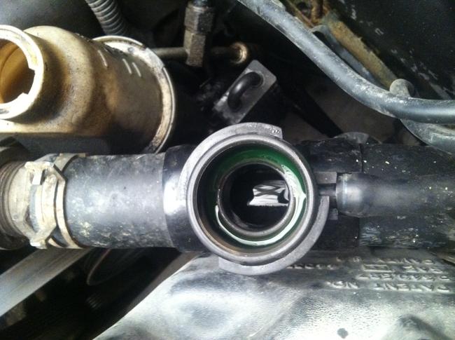

here is a picture of the hose. Could there be a blockage somewhere?
Oct 3, 2020 at 12:46 PM (Merged)
Is it the hose on the left or right? Also, the radiator looks low.
What to do is fill the cooling system and leave the radiator cap off. Start the engine. Allow it to warm up. When the engine temp gets to 195 degrees, the thermostat will be fully open and you should see the coolant circulating. Try that and see if that happens.
Let me know what you find.

Drained the radiator fluid (as it was looking dark) and flushed it out. Checked the thermostat and it was good to go so I put it all back together and filled it back up. Did what you suggested and it works fine now. Took it for a test drive and it did not over heat! Thanks for the info!!!
Glad it's fixed. I hope I helped. Take care and let us know if you have questions in the future.
