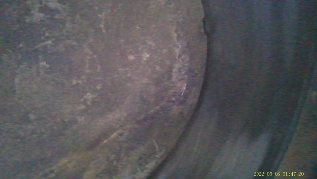

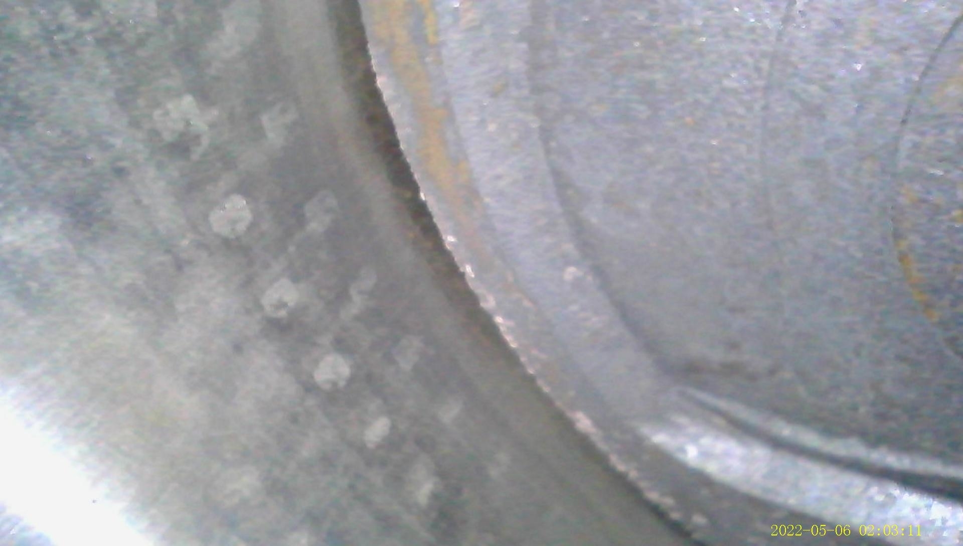

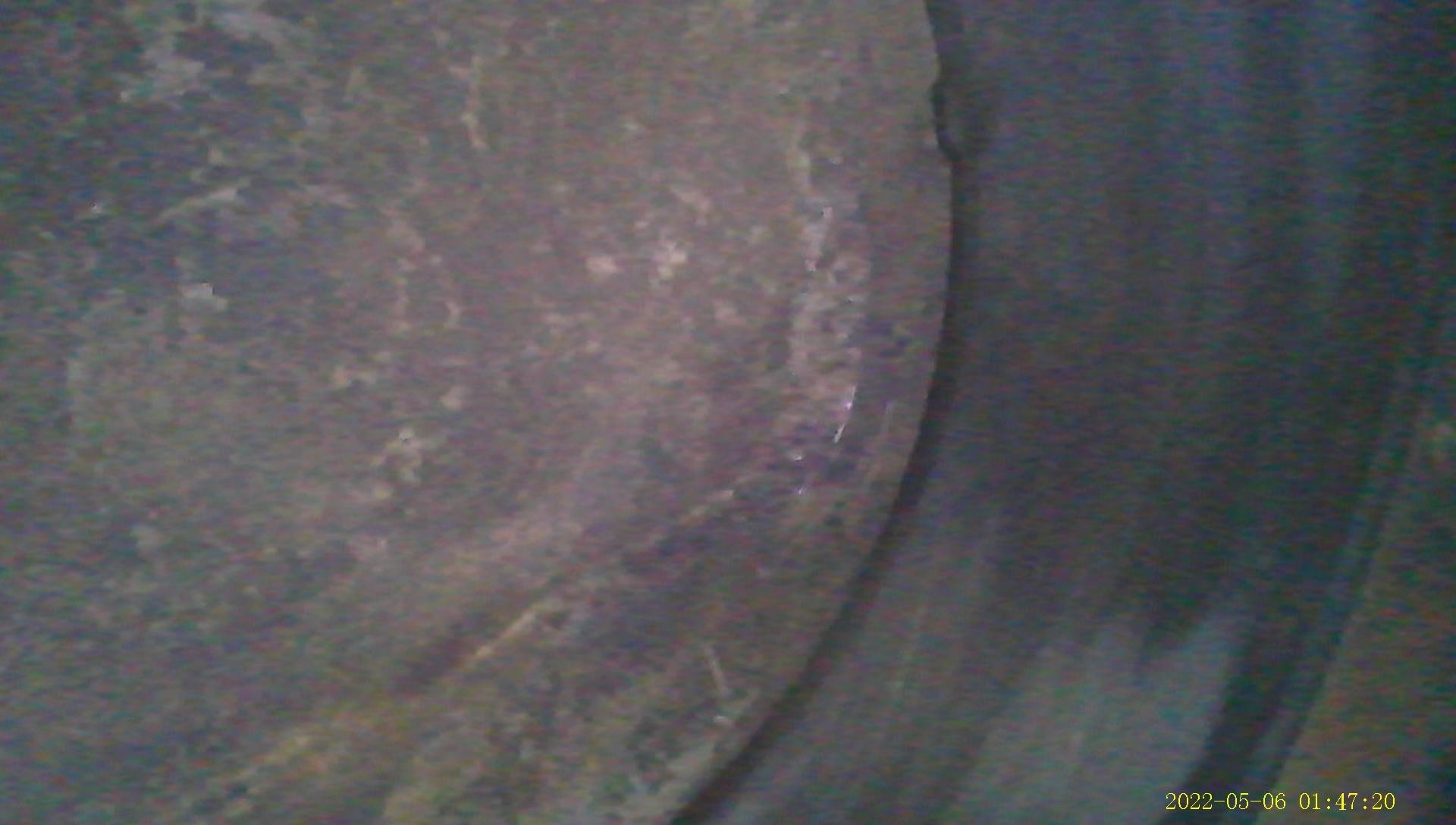

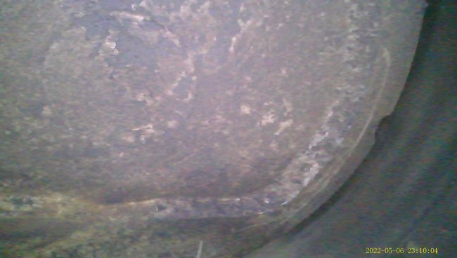

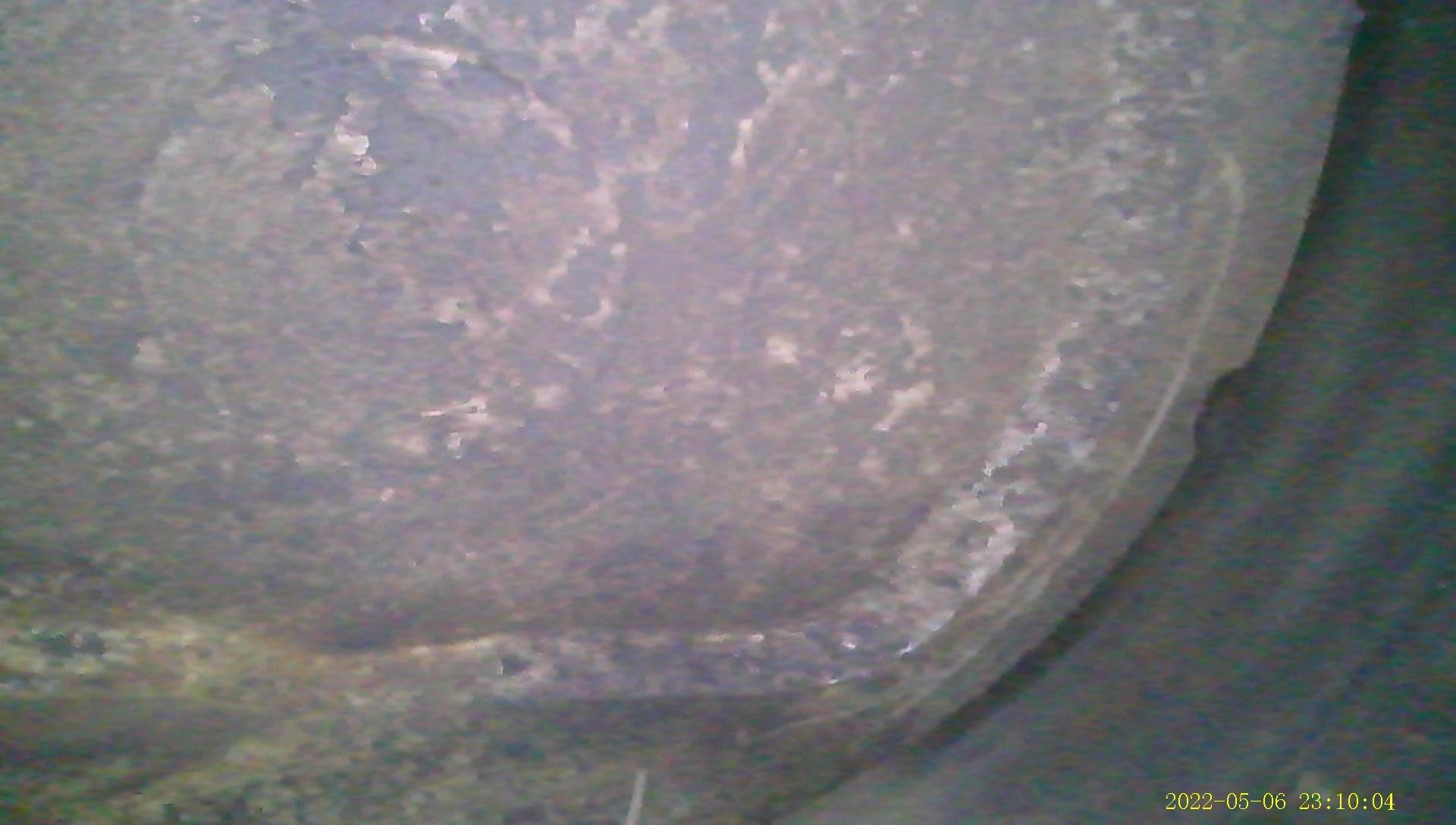

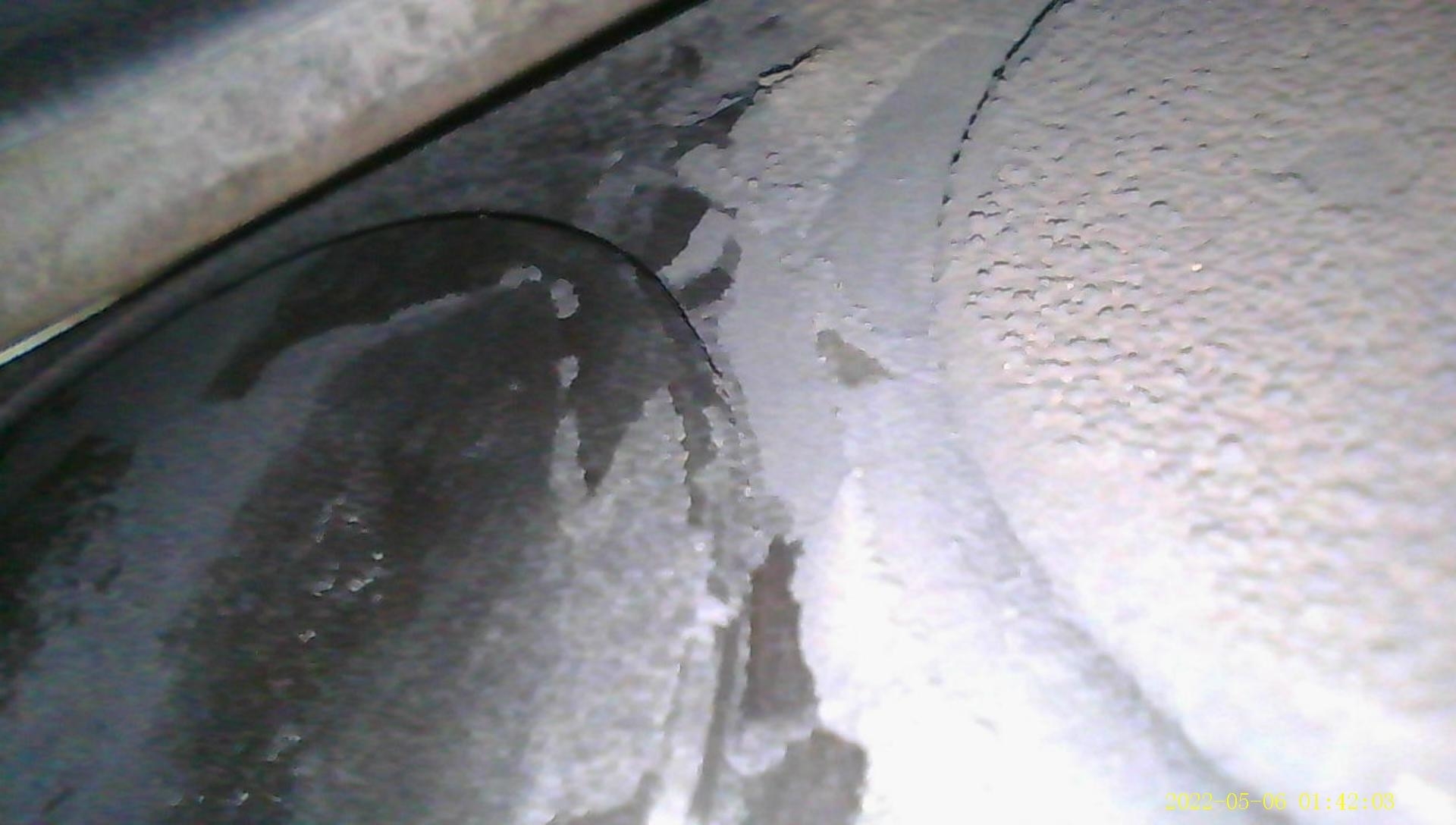

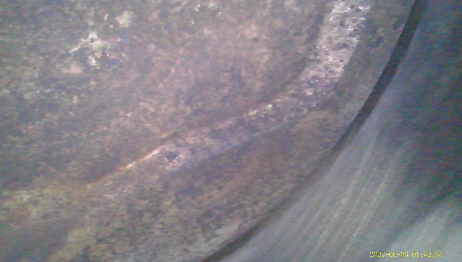

Well, the new plugs didn't quite do it. There is less of a noticeable miss, but it still shudders somewhat accelerating from idle. Seems okay at speed. I'll need to go for a longer drive in better weather. Now a couple of things, which could be trouble. First as I mentioned before, the correct plugs have a roughly 1/4" shorter threaded end compared to the ones that were in there. That would suggest they extended further into the cylinder and what may have been why I had such trouble getting them out. Second, I probed the cylinder with an endoscope, and it was loaded with carbon deposits both on the top of the piston and especially the valves. I also noticed there was a relief on the edge of the piston which I didn't see in another cylinder or on a catalog photo. It doesn't look like it was from detonation, since it was too smooth and symmetrical. I also noticed what looks like a hole in the top of the piston, center, and at the edge of the recessed area. I couldn't get a clear image of it and even tried cranking the engine to attempt to get it into focus. I'm hoping it's just a speck of carbon, since there were no signs of any problems before all this. I was going to check the compression, but I can't get my gauge into that cylinder. It's one piece and I can't get it to turn. I'd have to make up some kind of adapter it I really need to do it.
The attached photos are of number 8-cylinder, piston and valves, I've included another cylinder to show the difference of the piston tops.

I'm not seeing what I think is a hole. As far as a compression gauge, see if a part store has one that will work, and they will lend you.

I struck out with getting a gauge, however I drove the truck for another 30 miles or so. It still ran bad. I took out the plug on number 8, which was the one that looked somewhat fouled, and I thought there was something not right with the piston. It looked fine. I put the scope in the cylinder again and it looked like some of the carbon was burned off the top of the piston and valve face, and I couldn't see anything that looked like a pinhole. I'm still puzzled by that edge cup on the edge of the piston though. I changed out the new IAC valve back to the original and it seems to idle a little higher and smoother than the replacement.
I reran the tests and still no codes. I'm looking at throwing in the towel. I can't think of anything that could have happened when I took off the upper manifold. Only the TPS sensor was exposed on the bench when I sprayed some cleaner into the manifold and let the crud drain out the PCV connection fitting.
