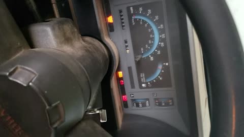

Had it towed it will crank and crank until it drains the battery. Can see fuel shooting from the injector to the carburetor. Distributor, cap, rotor and plugs/wires are about 8 months old. See video
I feel like it might be the ignition switch, or lock cylinder rather because something is letting the battery just die while sitting there, and at some times the truck will have no power but once I bumped into the steering wheel and the lights came back on. Just to repeat, the truck does fire and have fuel, but won't actually start up and run.

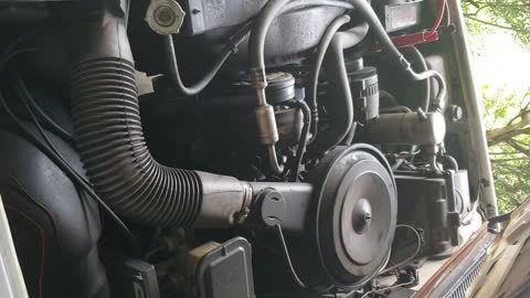

  • 861 POSTS
Hope this video helps. Battery definitely keeps dying. Also that was cylinder #4 which previously had 0 PSI. Mind you all plugs are out and fuel relay is pulled and air cleaner is off.
Aug 19, 2019 at 3:44 PM

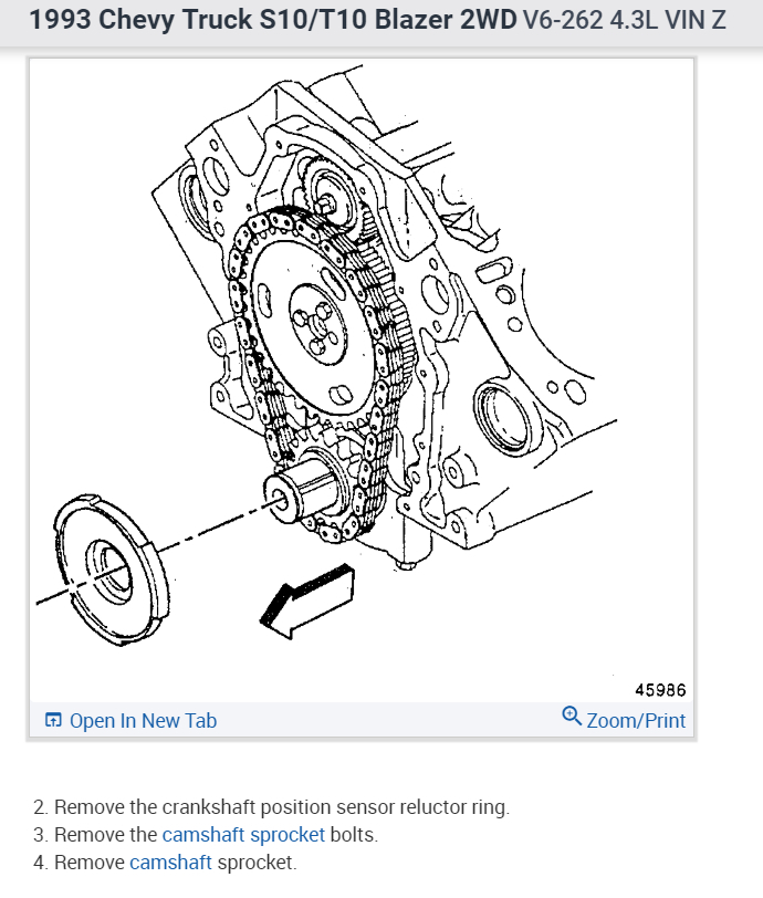

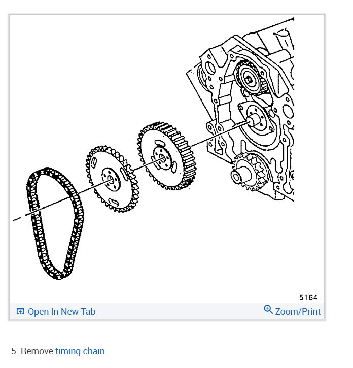

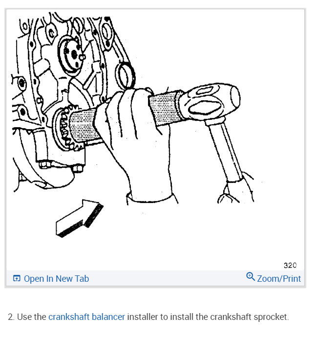

The battery sounds weak and the engine sounds like the timing chain jumped, the engine will needs to be taking apart to see what happened. If the chain has jumped you might have bents valves on one or more cylinders. Here is how you do the job. Check out the diagrams (below). Please let us know what happens.

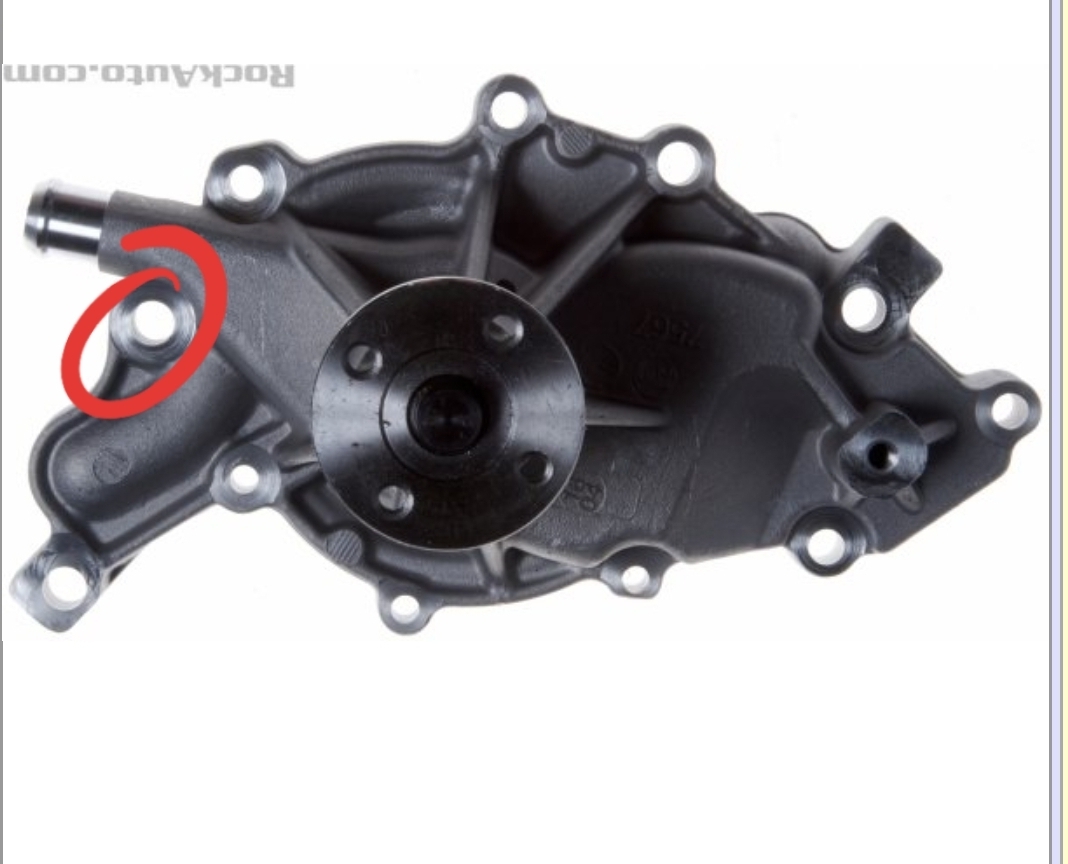

I'm almost there, got the stuff moved out of the way and the water pump off. There's a couple of studs on the water pump that also hold the timing cover in place. One stud just below the heater hose was extremely hard to get out, had to use an impact to retrieve it. When it came out, coolant poured out of the hole. Is that a sign of something?
Aug 22, 2019 at 2:56 PM
It sounds normal, but to be sure can you please shoot a quick video with your phone so we can see what's going on, that would be great. You can upload it here with your response.
Aug 23, 2019 at 11:26 AM

It's already out, but I circled the hole where it came out of here. Also, when I get the timing cover off, how do it line up the cam and crank? What am I looking for? And when laying the new chain on, what am I lining it up with?
Aug 23, 2019 at 11:31 AM
Okay this is normal, some of the water pump bolts go through to the cooling system makes sure when you are reinstalling the bolt threads are clean and use silicone rubber to seal. Let me know what happens please.
Aug 23, 2019 at 1:43 PM

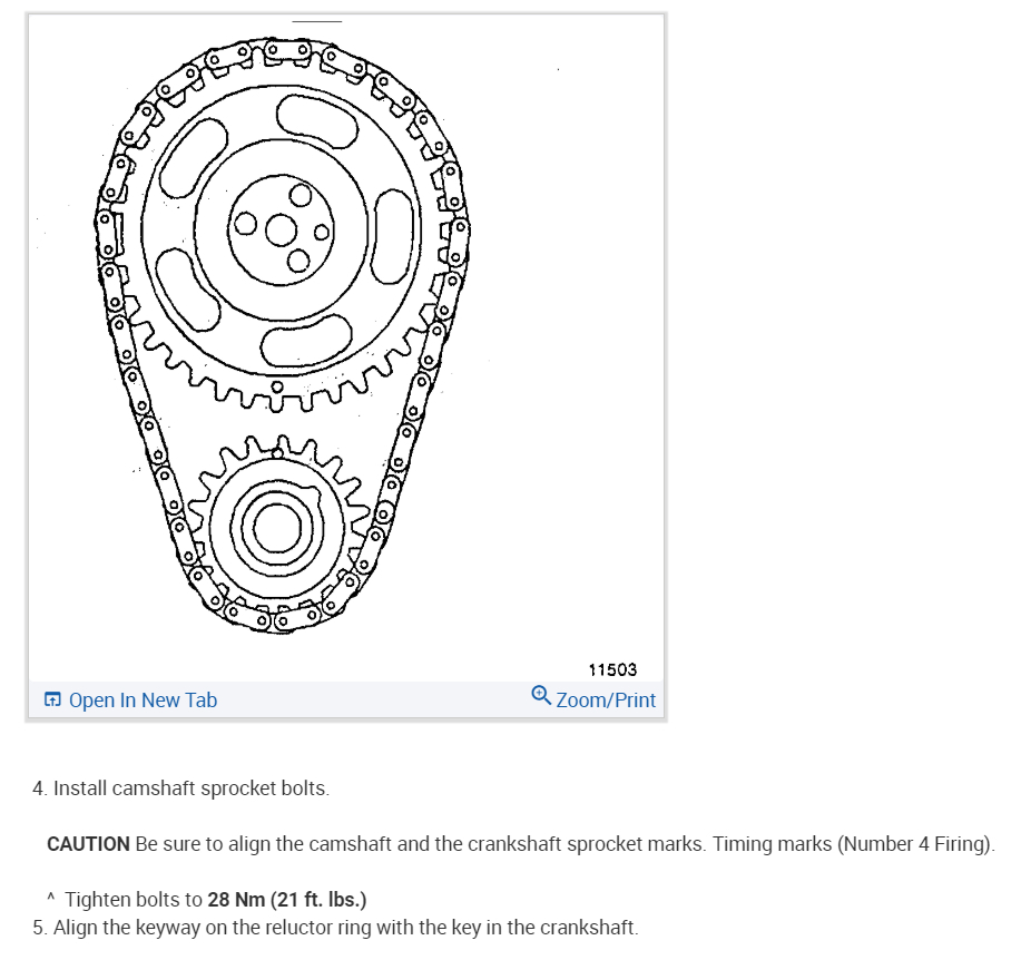

Also your diagrams are for a V6 4.3L engine, mine is a V6 2.8L engine, if there is any difference.

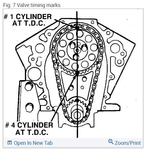

So how do I now I have the cam and crank aligned? There's a #4 and also an offset dot on the cam sprocket. and a gold spot on the new chain.

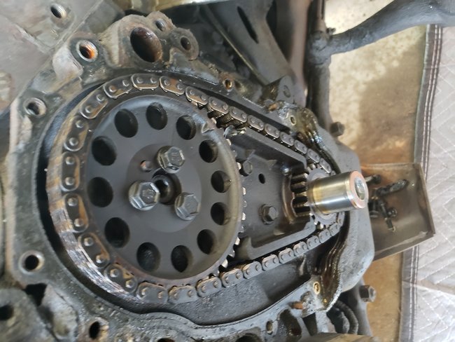

  • 861 POSTS

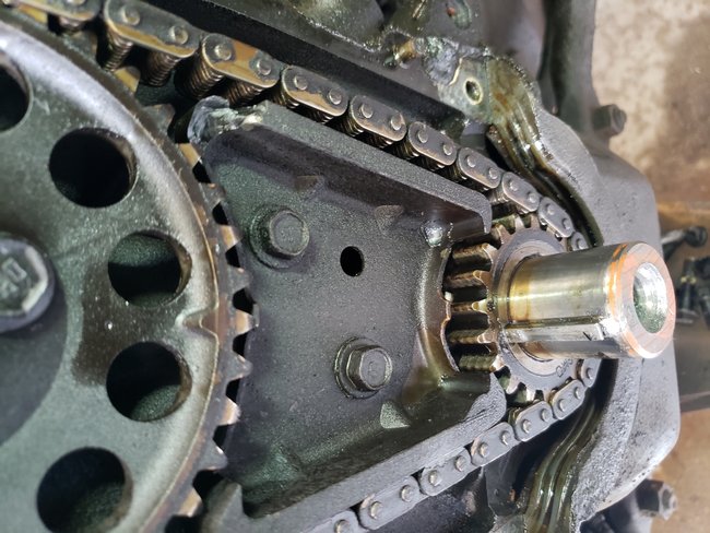

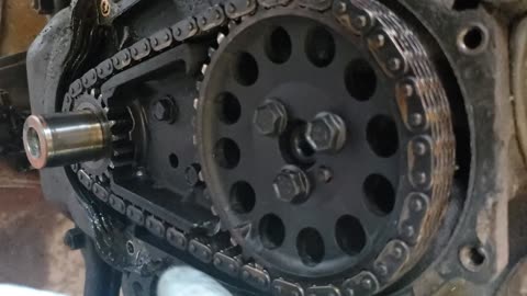

Here's where I'm at: I see the white spots on the teeth. Is that indicative of jumped time? How else would I tell? And how to I line it up before installing the new gear?
Aug 25, 2019 at 7:23 AM
CANNON1349
  • 861 POSTS
I think I have it lined up. If you can line it up, doesn't that mean it didn't jump time? Also, there is something broken here. The tensioner?
Aug 25, 2019 at 8:15 AM
CANNON1349
  • 861 POSTS
So it's called a timing damper. Do you think the chain whiplashed and broke it? Would that cause the truck to shut off and not start? A lot of questions here.

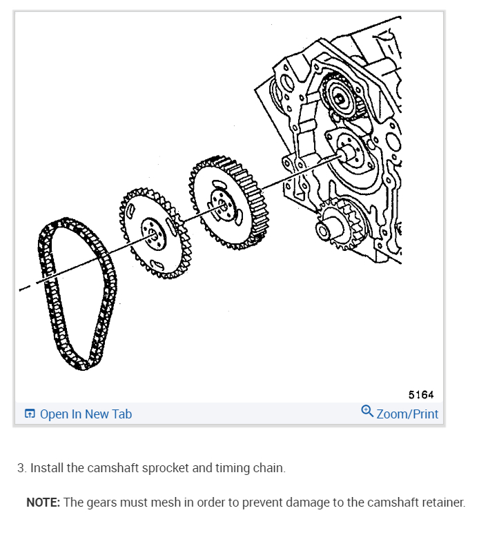

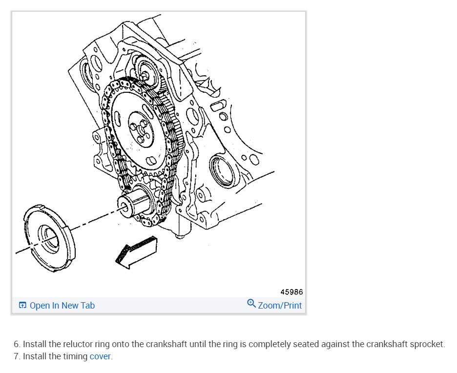

Aug 25, 2019 at 8:23 AM
It does look like the timing chain is loose which broke the guide. Here is how it is suppose to be lined up. Check this and get back to me please.

CANNON1349
  • 861 POSTS
I have it lined up where the dot on the crank is in line with the raised mark on the cam, facing each other.
Aug 26, 2019 at 12:27 PM
Is everything in line still? if so the timing chain did not jump, is this is the case the engine is worn out and needs replacement.

CANNON1349
  • 861 POSTS
I feel like the cam should be moved slightly to the left. I guess we'll find out if it starts.
Aug 26, 2019 at 1:36 PM
If it is off that will do it. let me know what happens.

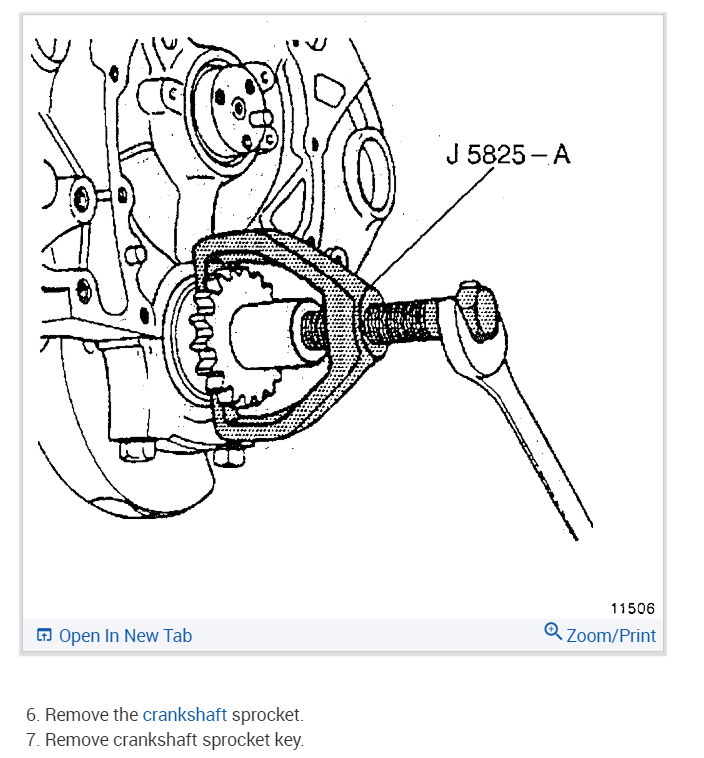

  • 861 POSTS
The crank sprocket isn't coming off. I've tried every gear puller you can buy, and even used a grinder to make the feet smaller to fit, they just slide off. The tool part number you have on the diagram leads to a $200.00 little puller, so I might just opt out on changing the crank sprocket.
Aug 29, 2019 at 8:16 AM
Yep, they can be stuck on there pretty good. let me know what happens.

  • 861 POSTS
I got it off using an OEM puller part #27011. And I put the new sprocket on by throwing it in my oven for 10 minutes at 250 degrees and it slid on like a glove and Is now on there for good.
