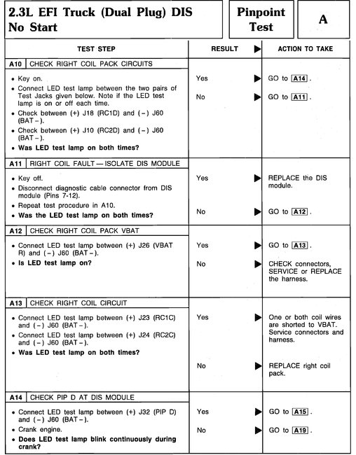

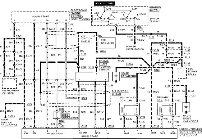

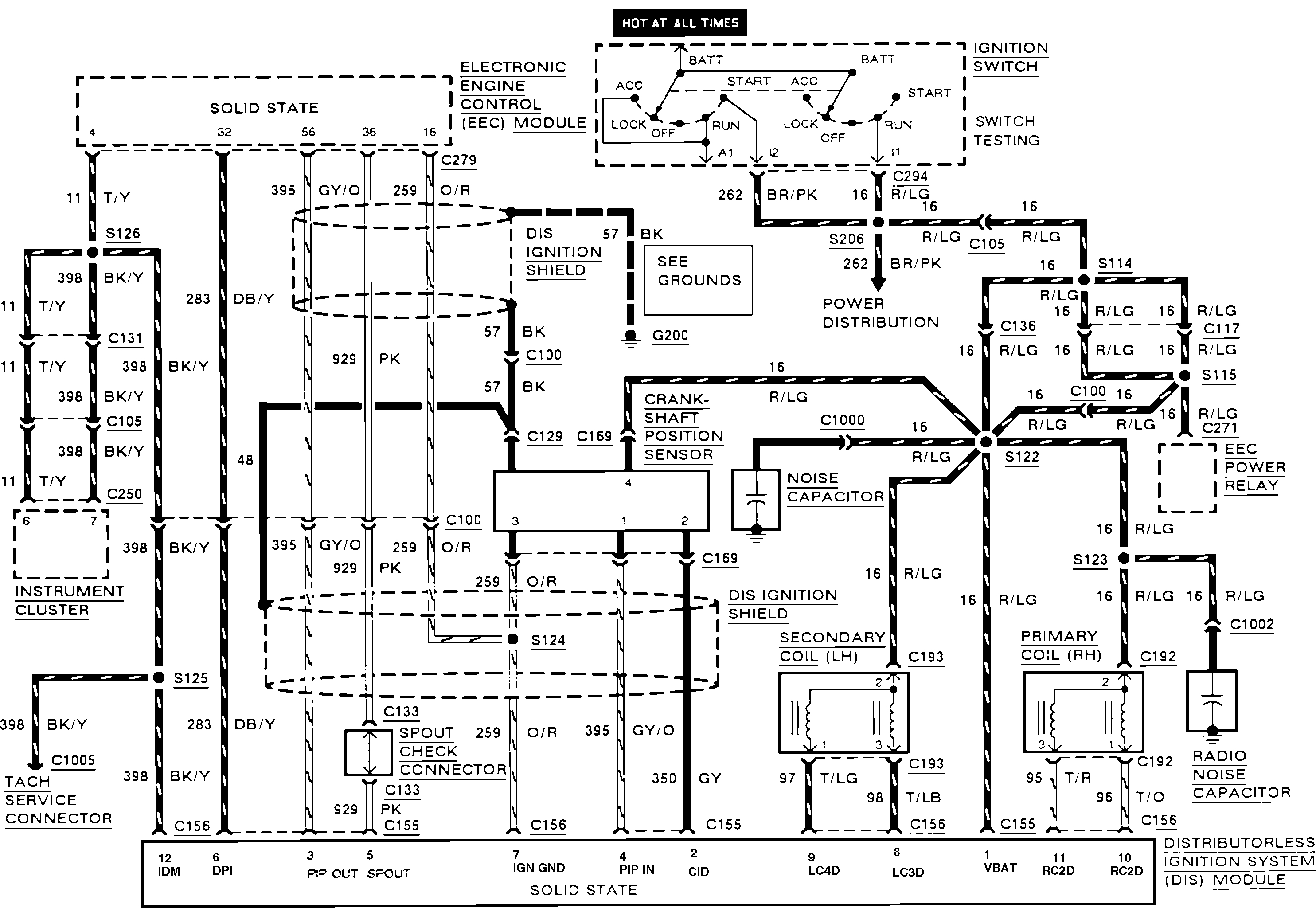

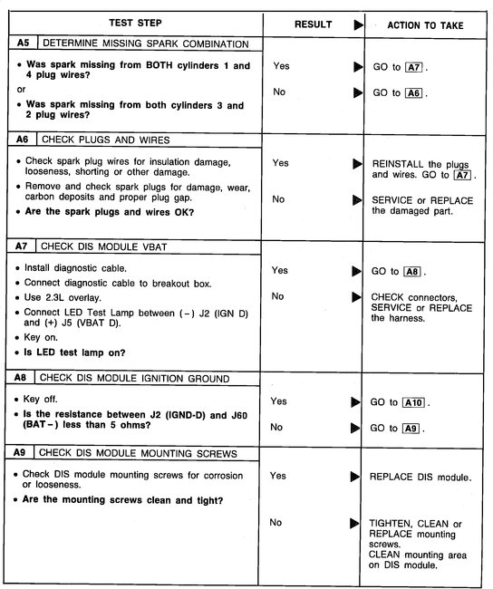

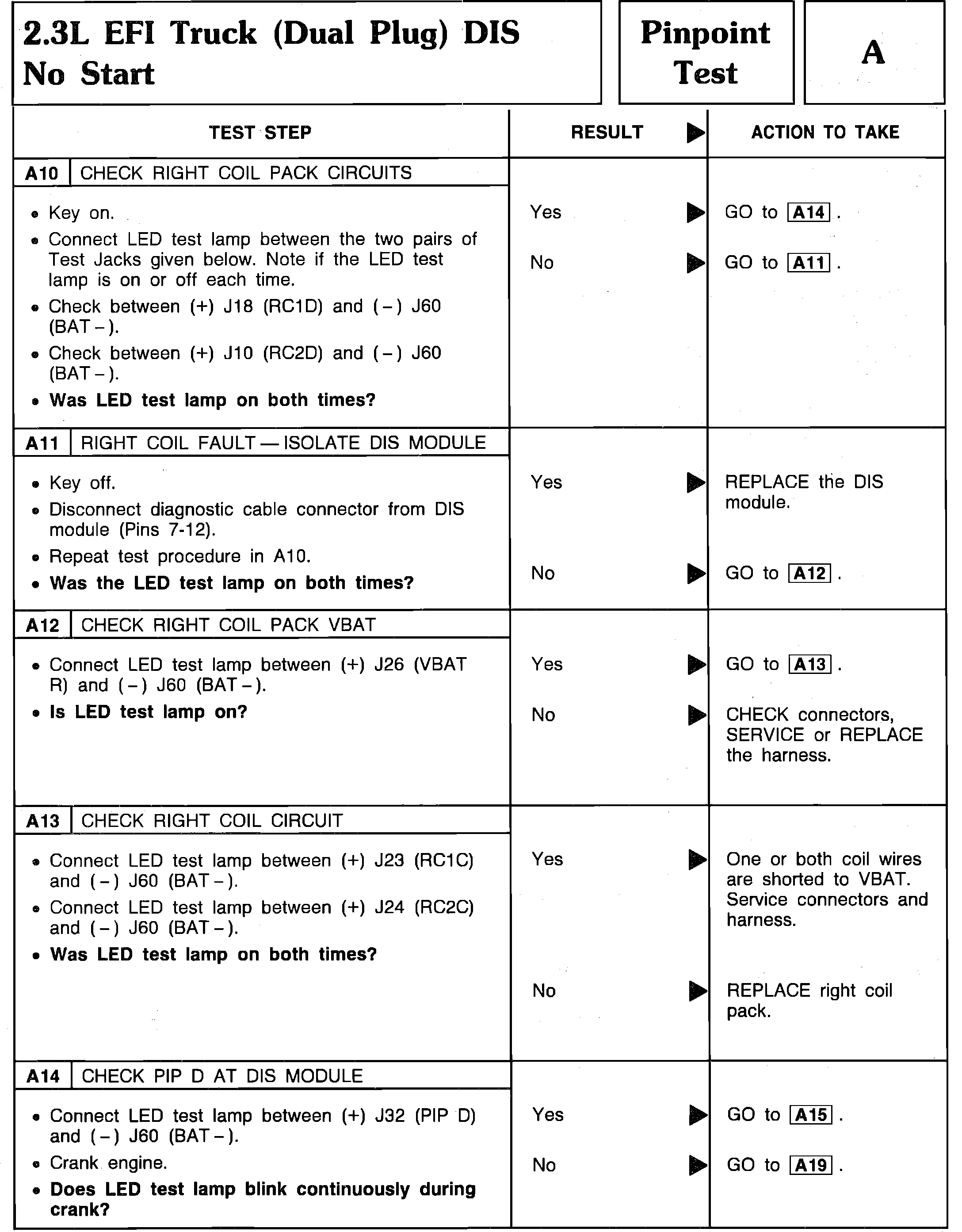

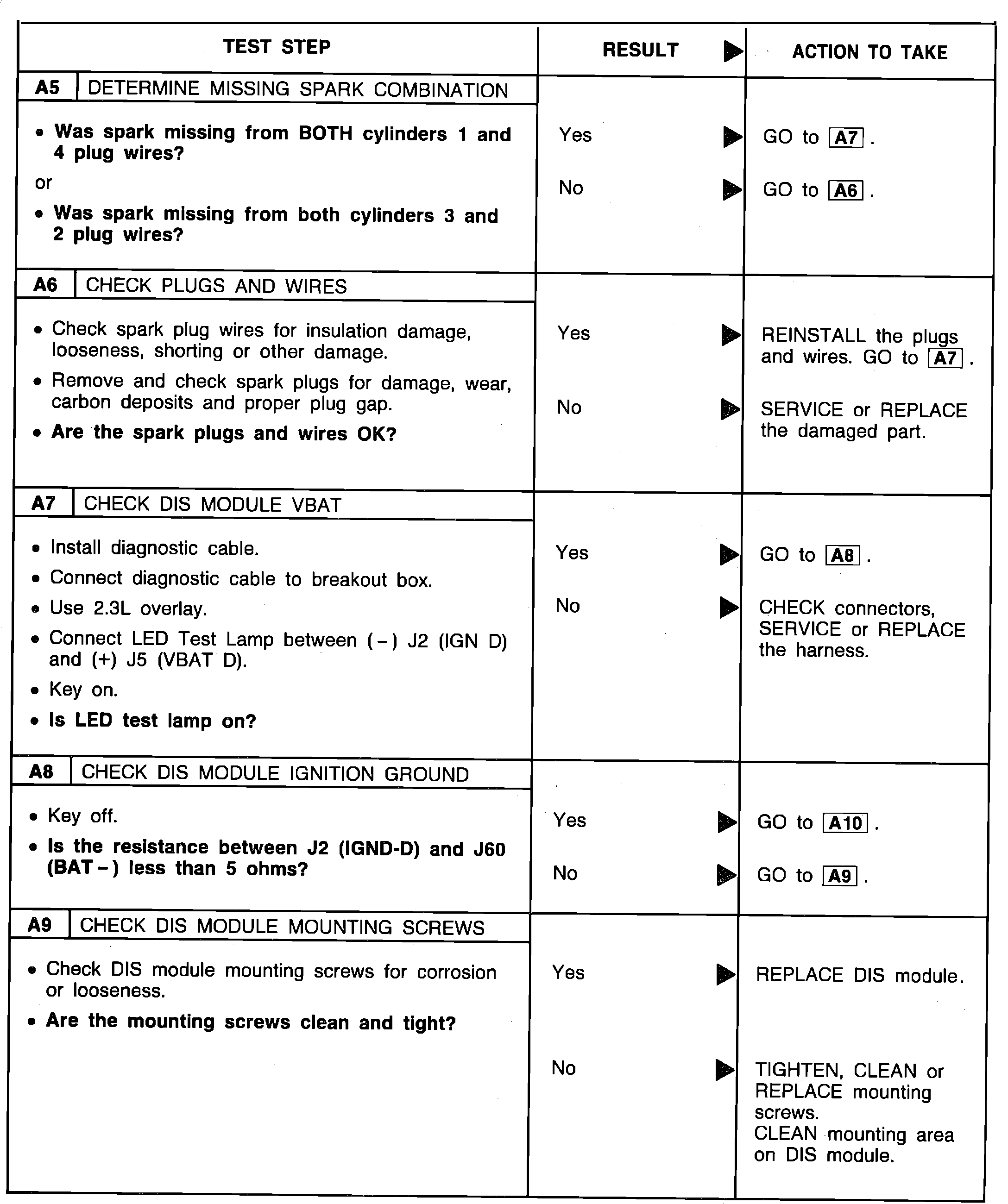

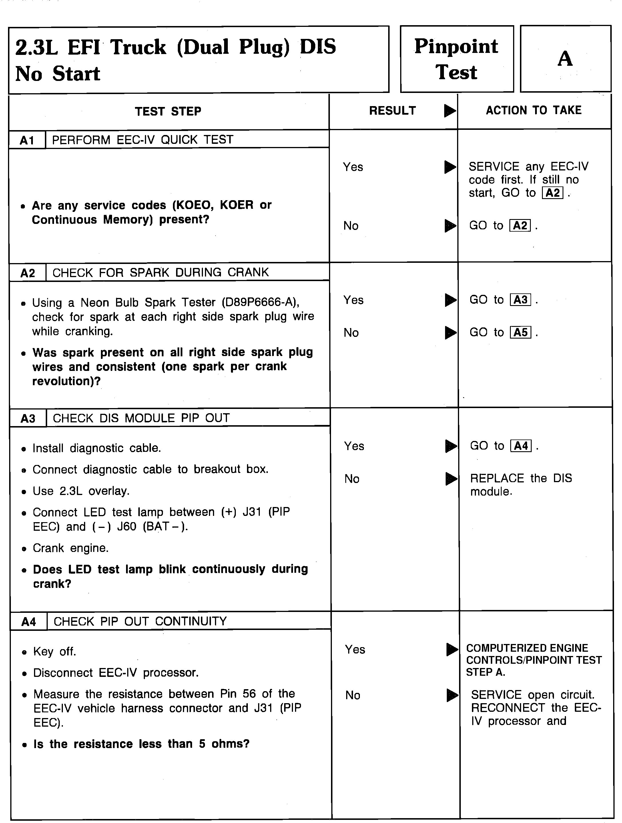

I've attached the wire diagram along with a few pinpoint tests to get started. I have replaced quite a few of the distributor-less ignition modules on these though, but a few quick tests usually can pinpoint this. Just make sure you have voltage with the key on at the red/light green wire at the coils and the module, also make sure that all of the screws are installed and tight on the distributor-less ignition module because the module grounds itself through these screws.
This guide can help test it

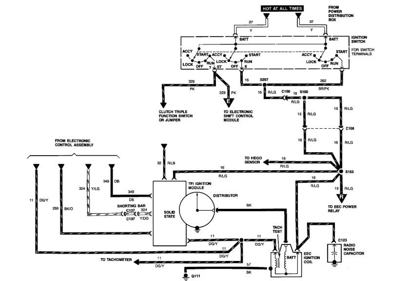

ARCHER777
Electrical problem
1989 Ford Ranger 6 cyl Two Wheel Drive Automatic
hello my ranger will crank really strong but the is no spark. I have replaced the coil, ignition control mod, cap & rotter, plugs wires and still nothing. Can you please help I am out of money and need my truck to work. thanks in advance

Inspect and test the distributor pick-up coil it doesn't have a CPS the 2.3 liter has it

I'm not even getting fire at the coil I ti will give a spark every so often and thats before it even makes it to the distributor

Found low voltage at terminal four ignition module requires battery voltage.
Jul 29, 2020 at 11:49 AM (Merged)
Good afternoon.
Yes, it needs battery voltage. It comes from the ignition switch.
Is there battery voltage at the positive side of the ignition coil?
CRHS56
  • 6 POSTS
Yes, battery voltage positive side coil.
Then you have a harness issue. The same wire that powers the coil powers the module. Look at the diagram and you will see the red/green wire is the feed.
CRHS56
  • 6 POSTS
Have battery voltage at coil up to resistor after have 9 volts. Cannot find wire at PCM does it change color somewhere?
If you looked at the diagram, it comes from the ignition switch, not the PCM. the module needs battery voltage to work.
Check the harness. You have a wiring harness issue.
CRHS56
  • 6 POSTS
Was chasing green/yellow wire not red/yellow. Have battery voltage up to firewall no red/yellow wire at PCM.
