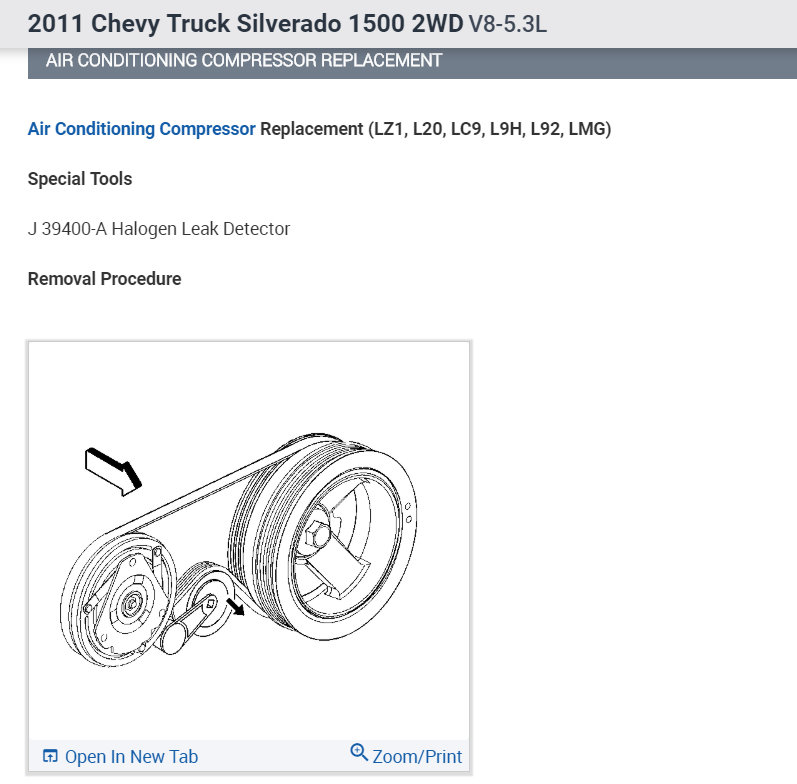

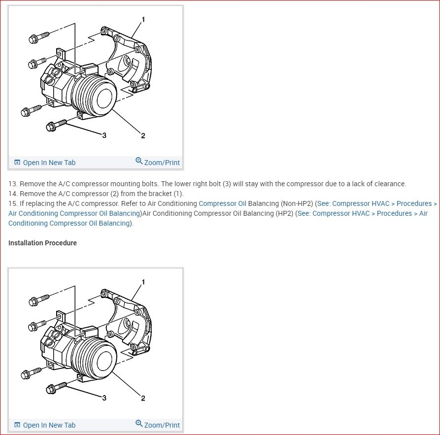

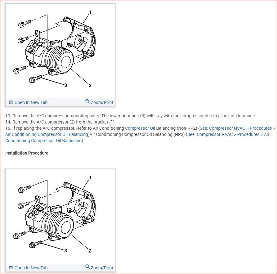

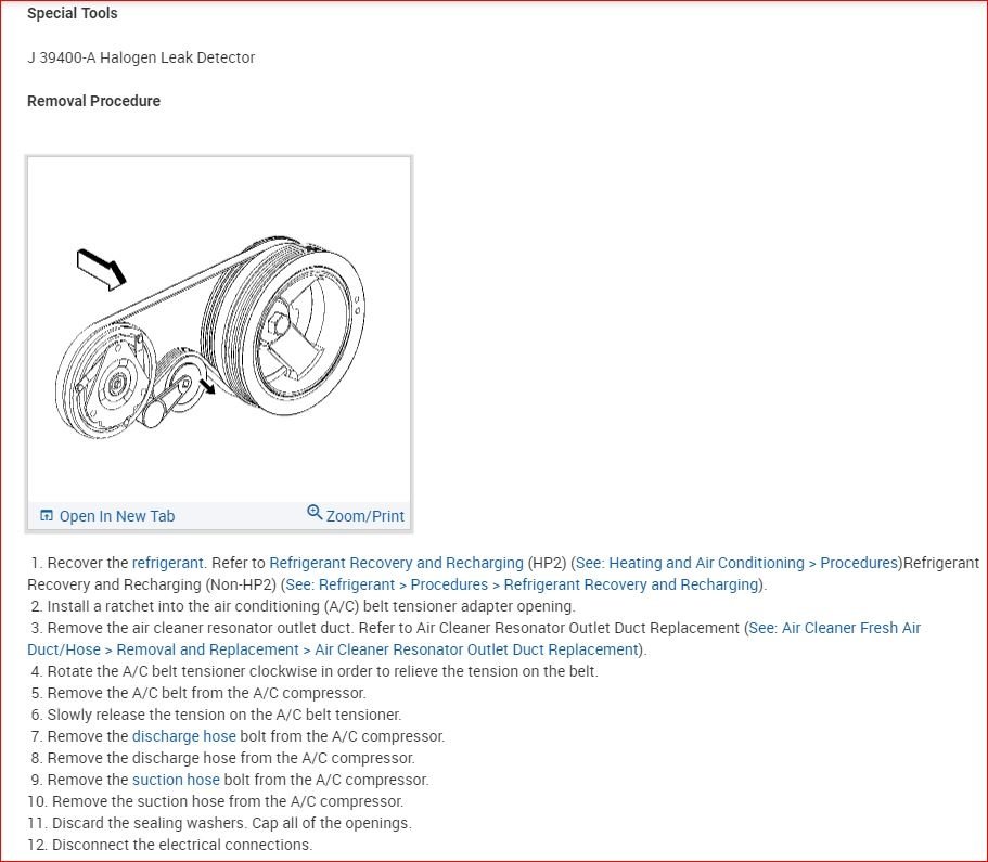

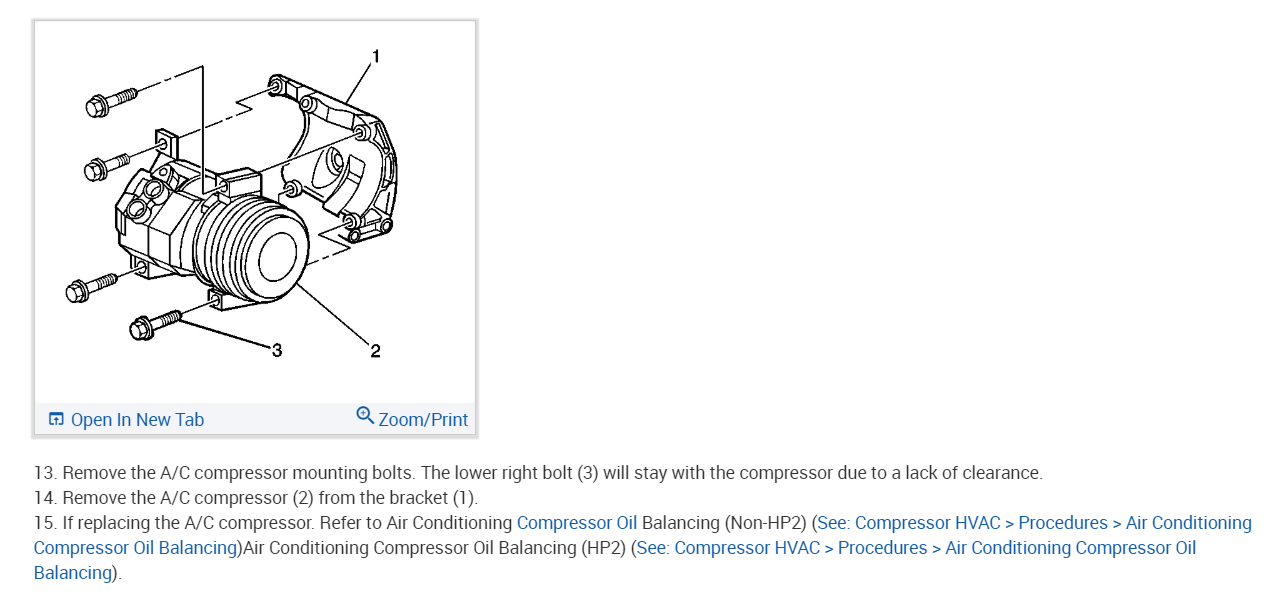

If the compressor runs with refrigerant inside and does not build pressure the compressor has gone bad here is a guide to help walk you through the steps of replacing the it and recharging the system with diagrams below to show you on your truck.
https://www.2carpros.com/articles/replace-air-conditioner-compressor
and
Check out the diagrams (Below). Please let us know what happens.
May 14, 2019 at 11:06 AM
Hi Cmangum,
More than likely your high gauge is reading a very small amount of pressure but due to it being a higher pressure gauge it looks like it is not reading. If you have pressure on the low side, you will have some amount of pressure on the high side. More than likely it is pretty close to being even pressure on low and high side which basically means you compressor is not building pressure. The fact that you pulled it down and it held a vacuum shows there is no leak but the compressor itself is not building pressure. Any time the compressor is cycling but no pressure is building, it typically means the compressor is not doing anything but spinning. There is a slim chance that you have a complete restriction but that normally always presents itself as a very high pressure on the high side.
I included the procedure to replace the compressor because based on this info, that is the direction it appears to be going.
Let me know if I am missing something or didn't understand what your issue is. Thanks

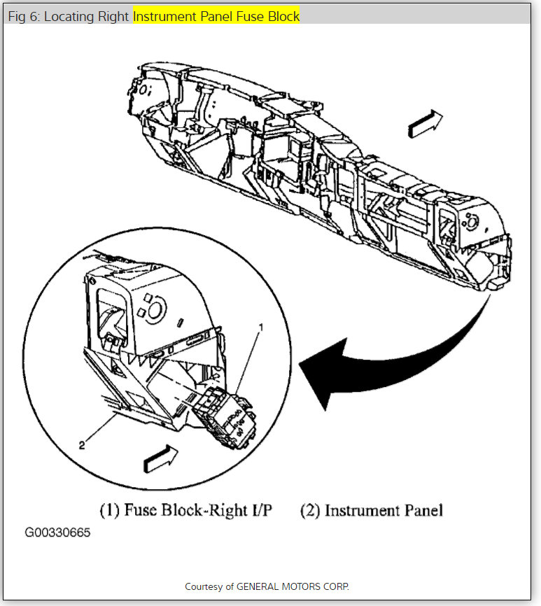

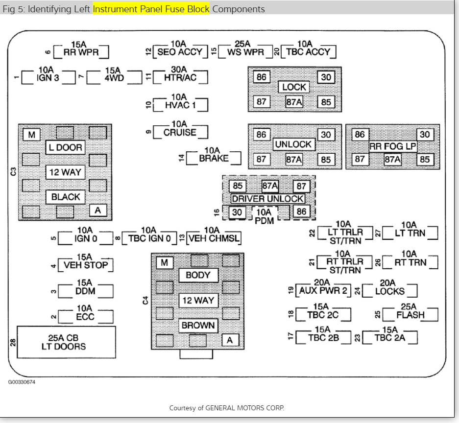

It sounds like the compressor is out the relay is not working here are two guides to help us see whats wrong and how to fix it.
https://www.2carpros.com/articles/car-air-conditioner-not-working-or-is-weak
and
Check out the diagrams (Below). Please let us know what you find. We are interested to see what it is.

What you did is clear the code memory in the HVAC. Whatever code set the first time may set again and then again you may have already resolved the issue so time will tell.

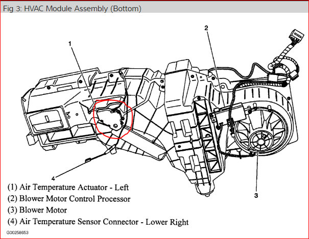

It sounds like you might be having a problem with the air temperature actuator. It is located on the HVAC unit under the dashboard. It is an electric motor that controls air flow through a door using different ducts. I have attached a picture (circled in red) and tutorial on how to replace. Hope this helps and feel free to ask any questions if needed. Thanks for using 2Carpros.
Danny-

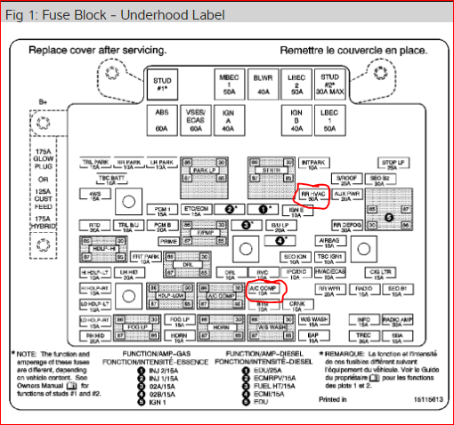

DANNY L
  • 5,648 POSTS
Hello again.
Okay, I have attached a picture and circled in ted two locations to check. I have also attached a link to show how to test a relay. Hope this helps and thanks again for using 2CarPros.
Danny-
