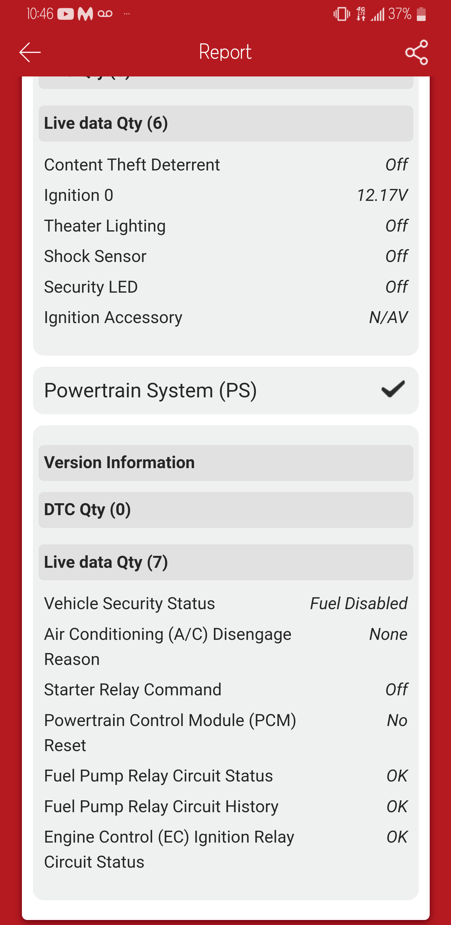

Nope, the security light does not flash when I try to crank it. however, I posted a picture of the last time I did a scan on it. It said security system, fuel disabled. Hold up I'll attach it. This is after changing the PCM. The same issue. Apparently, it isn't the PCM. I did the key relearn properly and the security light doesn't come on when I cycle the key. But it still doesn't power the fuel pump, this picture kind of explains it...
If you jump the power terminals at the relay does the pump run?

Jul 10, 2020 at 11:36 AM
Haven't tried jumping the terminals however, if the security isn't powering the fuel system then that's the issue right? I've changed the relay, fuse (fuel pump) and the actual fuel pump itself. Still no power, but I'll try that. Will it make a difference though?

Okay, so look, the security system is the issue, but the light doesn't come on when I turn the key. The only time it came on was when I changed the PCM. Once the key was learned it went off. Still it went back into fuel disabled. I am thinking the part 10319888 has something to do with this. I got no info on it online though. That's the theft locking module. I did mess with it trying to get it to work so maybe that could be causing the issue? I unplugged it and checked the wires. It doesn't work correctly though as I stated before. The key-less entry doesn't work, and I have a code for it.

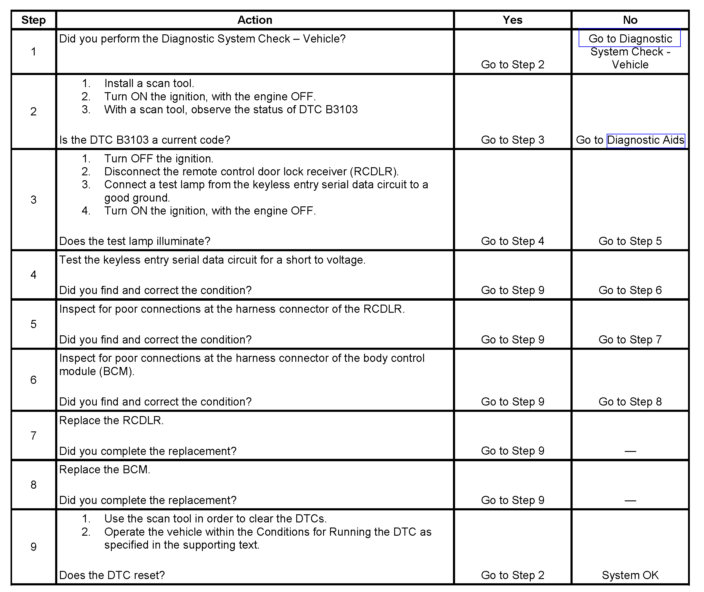

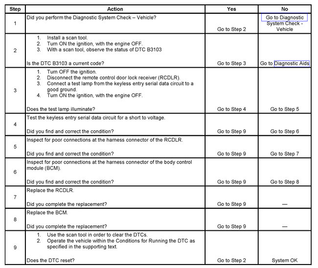

Also, did I mention that I had a code for B3103? Key-less Entry Data link circuit high. It's plugged in but it's only 4 wires coming to it. The replacement connectors I see online have like 6 wires. Plus only three wires are connected. Haven't checked them to see if they have power. The security light is also missing from the dashboard. There is no light or connector, only wires.
Jul 26, 2020 at 12:02 AM
The codes indicates a short to power. Take a look through this information and diagnostic procedure and let me know if it helps. The attached pic is the diagnostics.

Step 1 - Step 9
See pic 1
The numbers below refers to the step numbers on the diagnostic table.
3. B+ voltage should be present on the serial data terminal when tested with a DMM, but should not illuminate the test lamp. An illuminated test lamp indicates a short to voltage in the serial data circuit.
4. This step checks for a short to voltage in the key-less entry serial data circuit.

TEST DESCRIPTION
Step 1 - Step 9
See pic 1

Yes I'm familiar with the procedure, I'm just wondering if that short would cause damage to the BCM.
Jul 26, 2020 at 9:12 PM
In all honesty, I'm not sure. Anything is possible. Other than testing, it becomes a guessing game and I don't want to see you spend more to fix the issue than needed.
