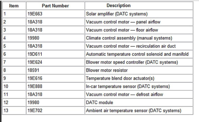

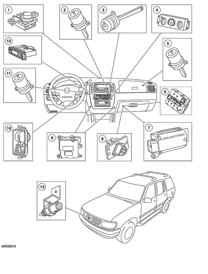

Check out the diagrams (below) Let us know what happens and please upload pictures or videos of the problem.
