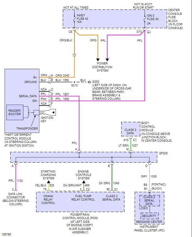

We are trying to bypass the security system altogether. I have a black wire, orange wire, two purple wires and one pink. Which ones do I put the resister to?
Apr 18, 2018 at 11:35 AM
It was on a youtube video I watched, but it does not tell me exactly which wires to put the resister on.

First of all, stop jumping the starter relay and figure out why the starter will not crank over with the key and fix it.
Then stop trying to bypass the security system and fix that. If the security light remains lit, then there is a problem with the security.
Begin by feeling if the starter relay clicks with the key on start, if not use the wiring diagram and test if the fuse #27 (IGN 1 Main) has voltage with the key on run and start, if not trace back and find out why not, cause it goes through the ignition switch. Before that the IGN 3 (#19) fuse. Then you also need the "In Key" fuse to be hot, it feeds the ignition switch, too and when the ignition switch is on start it feeds the PCM which actually is what activates that starter relay.
Then when you get the key to work the starter, maybe just maybe you would have also fixed the security problem, if not fix that. Try a spare key, try a password relearn but if turning the key to run after ten minutes the security light never goes out, you will need to read the trouble codes and see what refer to the theft or security system then work on that. It is not easy to bypass a theft system or people would be stealing cars left and right.
