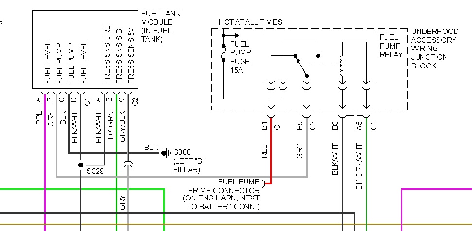

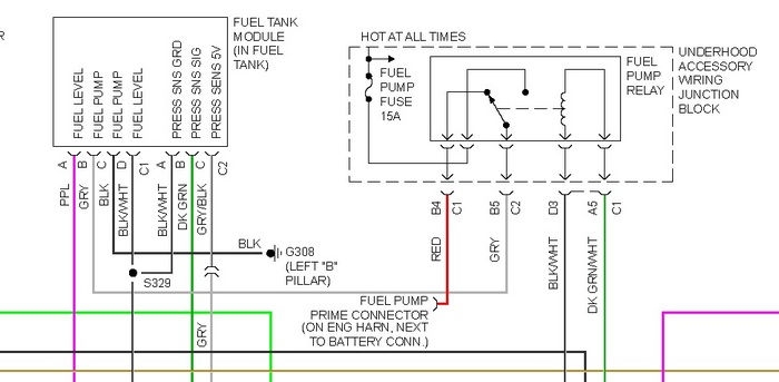

VERTIGO
Hi. My chevy venture 1999 does not start sometimes. The gas pump would not start, although the starter would and all the accessories. A garage changed the gas pump with no success. It never dies while running. Unfortunately, the car would start when I bring it to the garage and they do not want to work on something that runs
Thanks
François
Jan 25, 2021 at 9:47 AM (Merged)
JDL
  • 16,098 POSTS
With intermittent issues, you have to test when problem is ongoing. Engine cranking, gray wire at pump connector should be hot. Black wire is ground for pump motor, check that also. Note diagram below.
