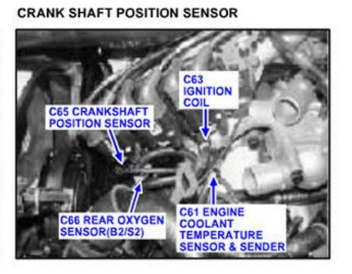

The grounding or control for the coil is the ECM. It has to see the signal from the crank sensor that the engine is moving before it will allow spark.
I attached the location of the sensor. I would replace this since you have no signal to the ECM.

It was the crank sensor. Really appreciate the help. Bought one on eBay 8 months ago and never really ran right. Hard to restart after it heated up. Didn't suspect a new part. But that's what it was. Thanks again.
