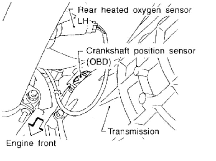

When a crankshaft sensor goes bad it will not set a code. Here is a guide to help you see what you are in for when doing the job.
Here is the location of the sensor which is on the top of the transmission bell housing.
Cheers
Cheers

Yeah we have tested the spark plugs and there is no spark. We have turned the ignition and the fuel pump cuts on. The fuses are ok. We need to know how to test the coil on the distributor, cap, or crankshaft. We hooked the scanner and no codes are pulling. I will order the crankshaft sensor
Nov 14, 2018 at 12:19 PM
(Merged)
The Crankshaft Position Sensor (OBD)On transmission housing, facing flywheel gear teeth. You will need to jack the car up
(Merged)
It took a while but I got the sensor changed out and the engine started right up YA! thanks for your help this site rocks!
