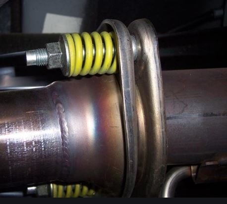

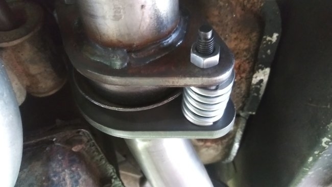

Looks good but I did spot one error, In this pic it looks like you put the spring between the two flanges. It should go between the nut and the flange. It's job is to squeeze the two pieces together so that it can flex on the donut but still stays sealed. Should look like the second picture, instead of the first one.
Okay, good. thanks so much. I'm so happy you found it.yeah, I figured I would have to get back under there at some point. I would rather do it sooner than later..Thanks for catching that.

No problem, as far as torque specs go, on the exhaust there are really none, other than for the O3 sensors. That is because the OE system is welded up front and the flanges are simply tightened until they don't leak. Like that spring joint, it should be tightened until the coils have a small gap between them like in the image I posted, or until the nuts bottom on the threads, depending on the design. Most bottom out.

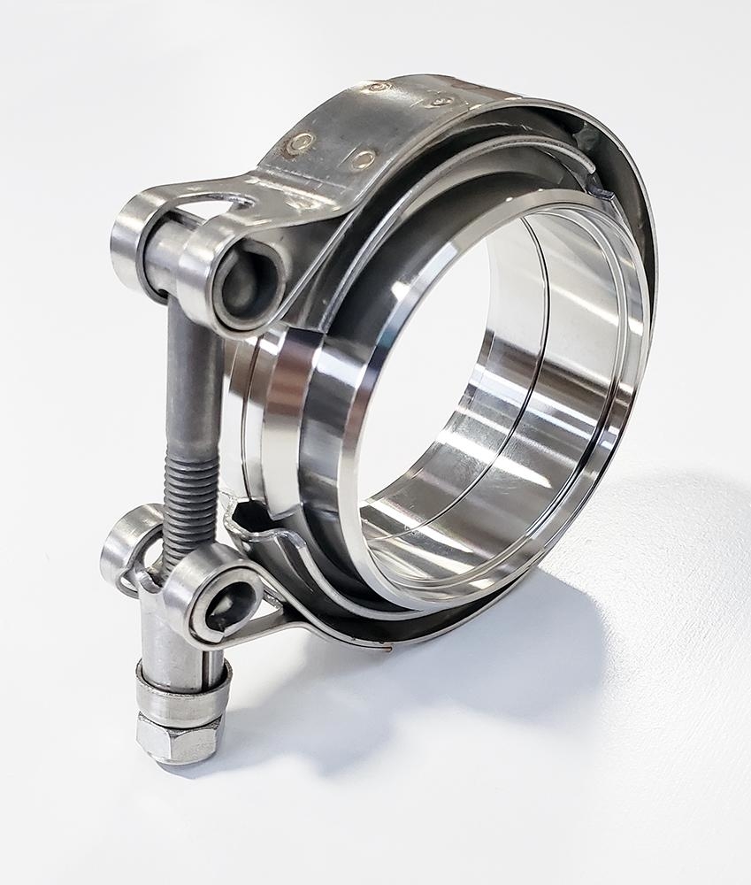

There should be no welding needed on the V clamps, they should have bolts that close the clamp down to hold it in place. The ends of the V do nothing so if there is a gap that isn't an issue, the way those work is the V grabs the edges of the cone on each pipe and the gasket between the two pipes gets squeezed to seal the joint. When they are new some will leak a bit until everything works itself into place. Think of the V clamp as acting like a bunch of pliers all around the pipes trying to squeeze them together. The image attached shows a clamp on two stub pipes, in your application the stubs in the picture would be the manifold on one side and the converter on the other. Normally on these you leave them a bit loose, then sort of wobble the connection a bit as you tighten them to get the best fit and seal.
