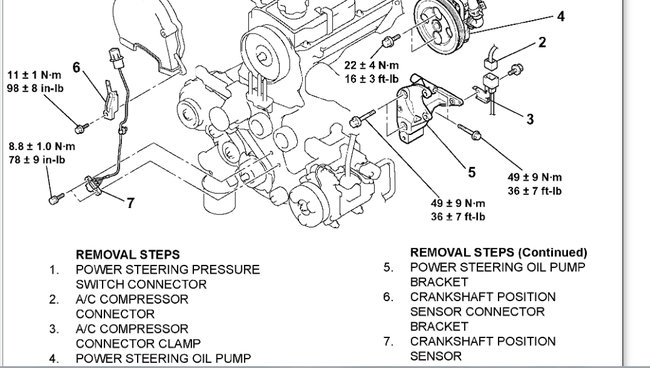

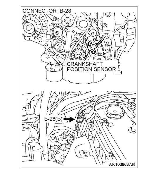

My daughter was driving at freeway speeds and the car just shut off. Replaced the fuel pump, still does not start. Timing belt has about 500 miles on it. Not sure what to check for.
Good morning,

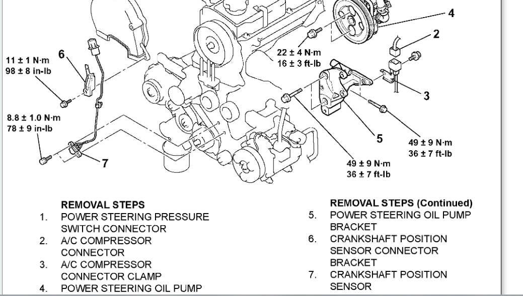

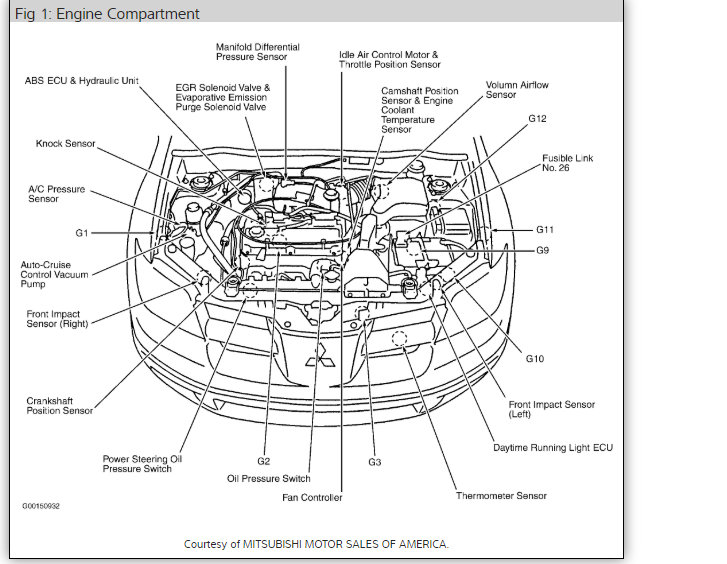

The code is for the crankshaft position sensor. It may have failed.
When you crank the engine, does the tachometer move up a little?
