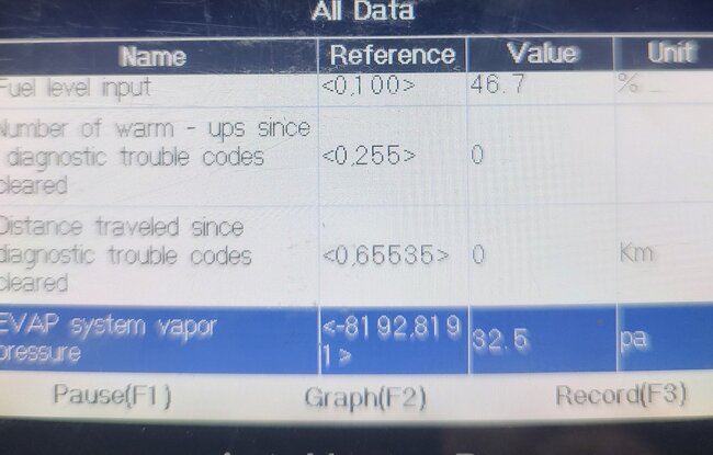

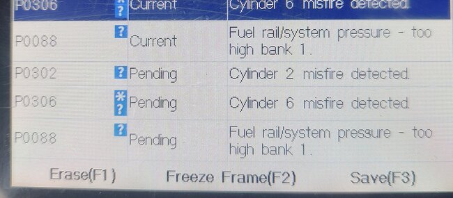

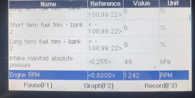

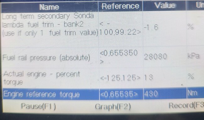

new scan. not sure exactly what I was looking for so I'm sending some screen shots. I have a few more readings if these aren't it. 2 current codes. #6 misfire, which would be that bad coil and P0088.
Dec 25, 2023 at 7:19 AM
CANNON1349
  • 861 POSTS
Your fuel rail pressure is reading at 28,080 kPA which = 4,072 PSI. This is absolutely crazy to be at idle! If this is true, I would replace the high-pressure fuel pump. Does your scan tool show a reference voltage for that fuel pressure sensor? It should vary around 5v.

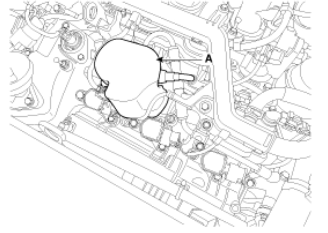

3. Remove the high-pressure fuel pump foam (A).
(SEE IMAGE 1)

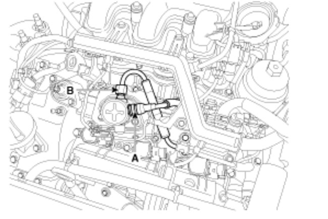

4.Disconnect the fuel pressure control valve connector (A) and fuel feed tube quick connector (B).
(SEE IMAGE 2)

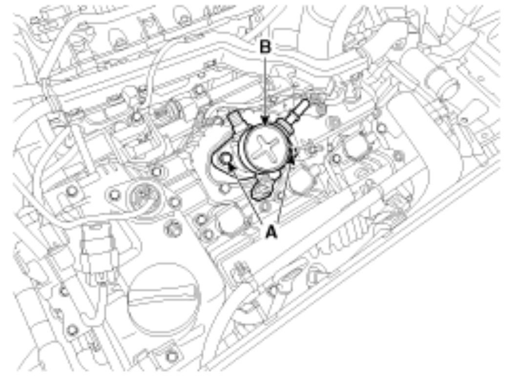

6. Remove the high-pressure fuel pipe.
7. Remove the mounting bolts (A), and then remove the high-pressure fuel pump (B) from the cylinder head assembly
High pressure fuel pump mounting bolt:
12.8 - 14.7 N·m (1.3 - 1.5 kgf·m, 9.4 - 10.9 lb·ft)
8. Unscrew in turns the two bolts in small steps (0.5 turns). When one of the two bolts is fully unscrewed while the other bolt still intact, the housing surface of the cylinder head may be broken due to tension of the pump spring.
(SEE IMAGE 3)

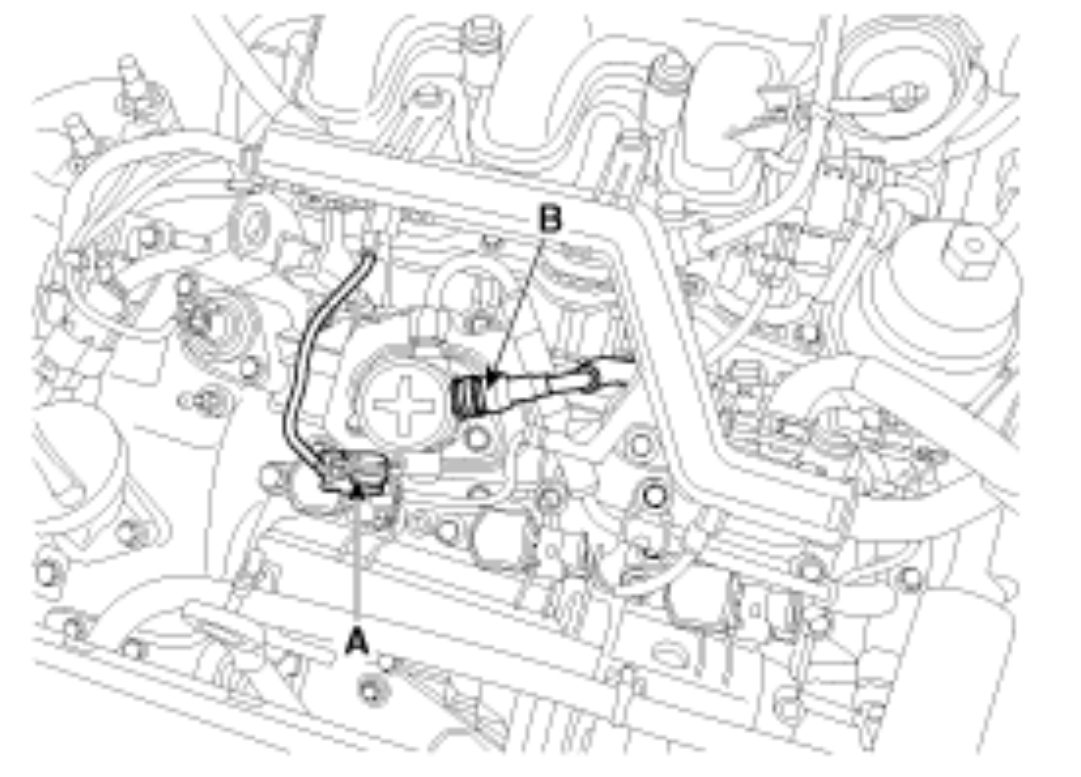

9. Be sure that the low-pressure fuel hose quick connector (A) is completely connected to the high-pressure fuel pump by the locking sound.
10. Double-check the complete connection of the low-pressure fuel hose to the high-pressure fuel pump by pulling it after connecting.
11. Be sure to install the high-pressure fuel pipe (B) to the specified torques.
12. Because fuel leak may cause fire, thoroughly inspect leakage of all fuel line connection parts at engine start condition.
(SEE IMAGE 4)

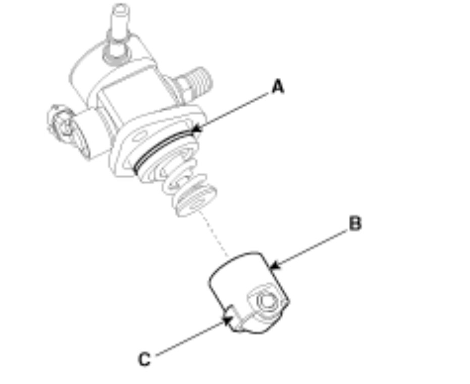

15. Apply engine oil to the O-ring (A) of the high-pressure fuel pump, the roller tappet (B), and the protrusion (C). Also apply engine oil to the groove on the location where the protrusion (C) is installed.
(SEE IMAGE 5)
